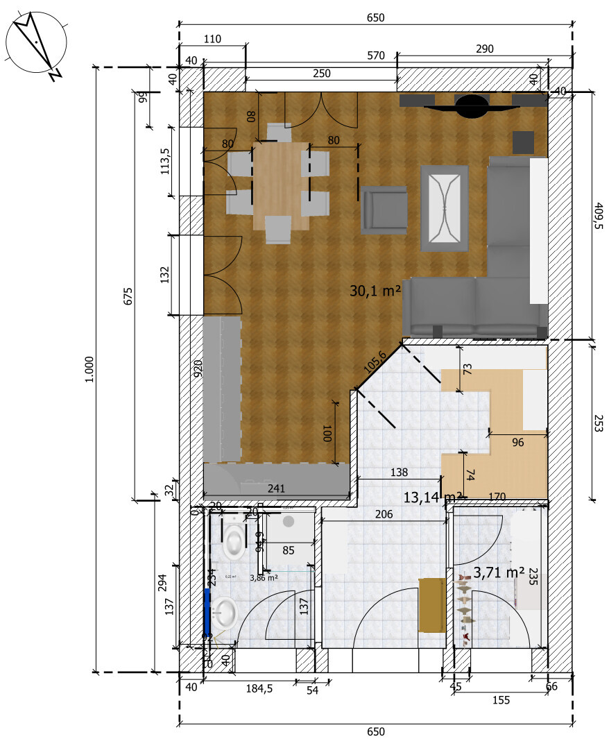

The house itself is determined by the developer and therefore cannot be influenced in terms of dimensions, shape, and orientation (see floor plans). The focus is solely on the internal floor plans, layout, and optimal use of space.

6 rooms included, extra shower bathroom included, managed to get some storage space.
What do you dislike? Why?
Narrow bedroom, very small utility room (must be at least 5 m² (54 ft²) according to the builder), one room with many corners in the attic.

Self-modified design proposal from the builder. Originally had only 4 rooms.
Is this floor plan even possible?
Have we forgotten something? Can it be made nicer somehow? According to the builder, the staircase can be smaller, but the space must probably be allocated to the utility room (which the builder says is too small).

kaho67412 Jan 2020 12:03
Is the staircase freely configurable?
Are those dormers under the sloped ceiling in the attic?
Would a gas boiler with an instantaneous water heater be possible?
Five people in this space – I would not recommend it. Where is the washing machine located?

As I said, I’m using Sweet Home 3D, where I can enter all measurements precisely in centimeters, unless you say the program is inaccurate.
I can even virtually walk through the area and see that it’s very tight but still workable.

The staircase should be freely planable. Actually, everything within the external walls should be flexible.
I also briefly considered trying a gable-end entrance but quickly ran into problems because the house is only 5.7 m (18.7 ft) wide on the inside.
No, those are skylights; unfortunately, I can’t represent anything else in Sweet Home 3D.
A gas boiler would be possible, but due to energy-saving regulations, a solar thermal system with a water storage tank would also be required — and where would that go? Would that still save space then?
I have now marked the walking dimensions and placed the washing machine and dryer in the utility room.

Do you really want to crawl into bed every time?
Tolentino12 Jan 2020 12:42
No, that’s why I said I don’t like that part of the current design. I’m open to any suggestions on how we can change it without making the bedrooms smaller or losing a room entirely.
That said, I could accept it if necessary—the bed is over two meters (6.6 feet) long, so there would be enough space to crawl in.

Your concern is justified.
Tolentino schrieb:
I can even walk through the area virtually and see that it is very tight, but it works.
Many things are possible virtually and digitally that, while not impossible in reality, should simply be avoided.
Tolentino schrieb:
Narrow bedroom, very small utility room (must be at least 5 m² (54 ft²) according to the building regulations), a room with many corners in the attic
Cost estimate according to architect/planner:
You said it yourself: Your idea is not feasible if the utility room must have at least 5 m² (54 ft²).
Tolentino schrieb:
What do you like most? Why?
6 rooms accommodated, extra shower bath included, a bit of storage managed
Shower bath located where it is not needed, double bed barely “accessible,” awkward bedroom layout, rather cramped living area, no storage, utility room too small, where to do the laundry?...

I can imagine that this house is sufficient for 2-3 people, but I don’t see room for more family members.
Everyone having their own room to protect and live out their personal needs, providing a retreat, would be ensured, but that’s not everything. Even the living area could be overcrowded with 5 people, with kitchen noise, a stubborn child, or the TV on—so in everyday life and routine, everyone would probably prefer to escape if they could.
If eventually the shower bath needs to be used as an alternative option, it can become unsafe on a narrow or cramped staircase.
Therefore, I would advise you to reconsider this house or plan a more relaxed layout (for fewer people) and later, if there is more offspring, look for a larger home. The house can be a good starter property if you invest in a good design and contemporary equipment right from the start.
12 Jan 2020 13:04
What kind of technical equipment needs to be installed in the utility room? Do you have district heating or something similar?
Regarding the storage rooms in the attic: if at all, then box in the knee wall, but don’t take away any standing space from the rooms.
