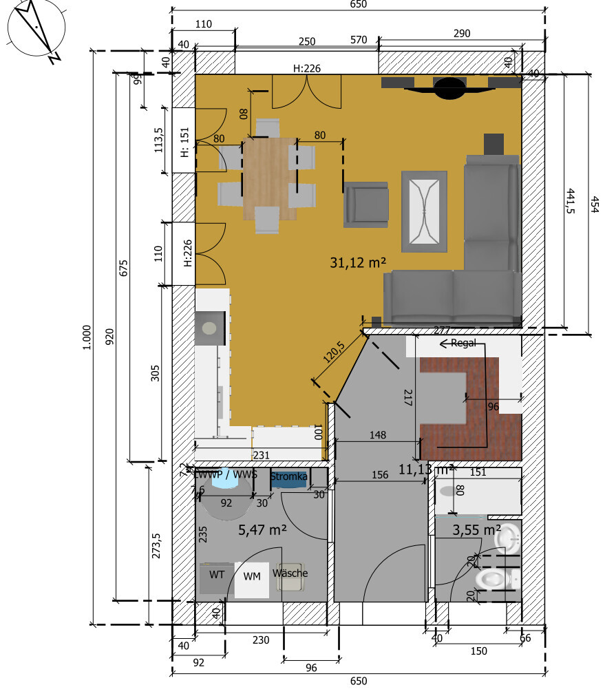

Grundriss eines Apartments: Wohnzimmer, Küche, Essbereich, Schlafzimmer und Bad mit Maßen.
Grundriss einer Wohnung mit Bett, Sofa, Tisch, Bad und Arbeitsbereich.
Grundriss eines Hauses mit farbigen Räumen, Türen, Möbeln und Maßangaben.

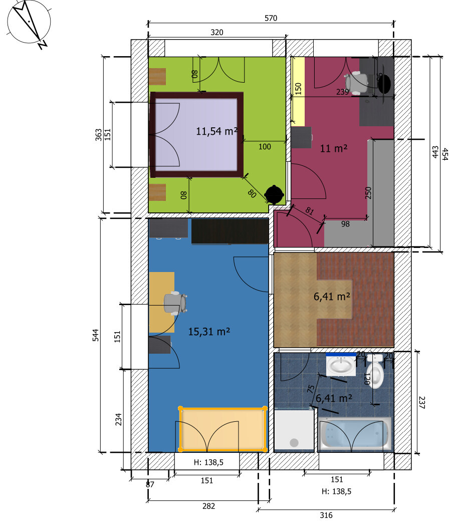

I live in Munich and therefore know many families living in very tight spaces. Here, having your own house with a 200 sqm (2,150 sq ft) garden is true luxury. So don’t let yourself get stressed! I would definitely skip the hallway in front of the stairs on the ground floor. Without a soundproof door to the living room, it serves no purpose and just takes up space. Like Kaho suggested in #25, with storage space under the stairs. If the utility room stays on the right, you could also reverse the direction of the stairs and add the space under them to the utility room. The corridor upstairs would then change accordingly. For the dining table, you could choose a space-saving bench against the wall or even a nice corner bench solution. I also like the suggestions from #25 for the upper and attic floors. Personally, I would put all the children upstairs to keep my quiet zones for sleeping and working there. Apparently, one of you doesn’t have regular sleeping hours. In a standard garden shed, you can store many things, for example, Christmas decorations and plastic suitcases.

Ground floor, with swapped utility room and guest bathroom:
Floor plan of an open living and kitchen area with dining table, sofa, armchair, kitchen, hallway, and bathroom.
First floor, with study/dressing room as a walk-through room and sound buffer to the children’s room:
Colored floor plan with color-coded rooms and area specifications (11.1; 14.34; 12.44 square meters).
Alternative first floor, less space in study/dressing room, more in children’s room:
Floor plan of a living layout: colored rooms with measurements (11.54 m², 11 m², 15.31 m², 6.41 m²).

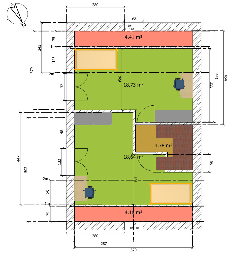

Attic floor, with lowered ceiling height under 1m (3 feet 3 inches):
Floor plan of an interior with green marked areas, orange furniture outlines, doors, and measurements.

This is meaningless unless you provide details about the roof. What is the knee wall height and the roof pitch? The heating system must go into the attic if possible. Also, you need to say whether you want and can afford to pay for the dormer(s).

You also need to know the wall thickness to the neighbor.
To put it briefly, if the space is that tight, you must know everything for a floor plan.
