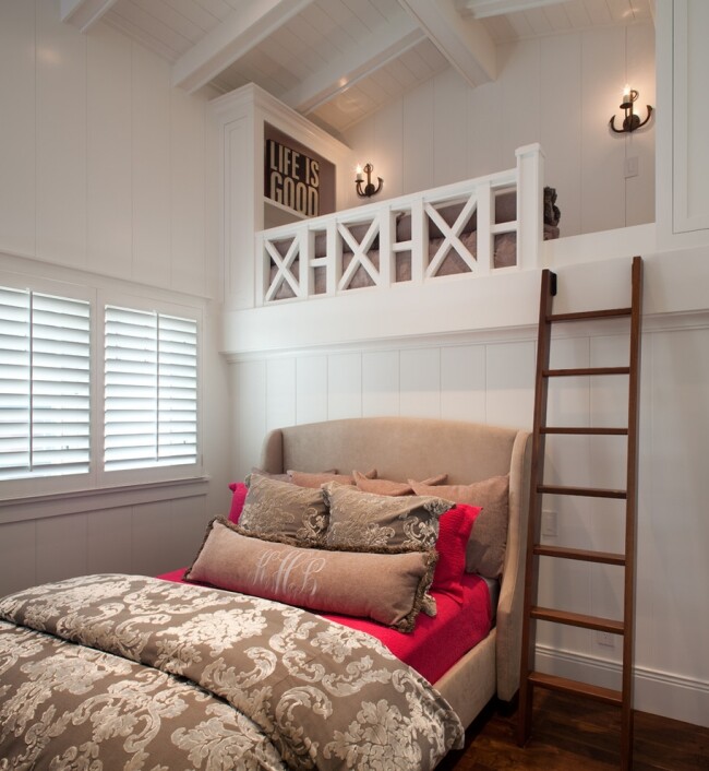

Another idea for the lower room would be to have an open ceiling all the way up to the roof ridge, but keep the ceiling over the utility room at 2.40 m (7.9 ft). The wall at the top of the plan, towards the neighboring room, would extend in the utility room all the way up to the ridge. A loft ladder would lead into the resulting bed niche above the utility room, so the bed below could be omitted. This would definitely be a nice alternative for the oldest child.
Scout
15 Jan 2020 18:31
Something like this, but with the roof ridge rotated about 90° in your case, and the white wall paneling higher up; behind that would be the mechanical room (HAR).
Bright bedroom with white loft, ladder, upholstered bed, and patterned ceiling.
The sleeping area could easily fit a 140 cm (55 inch) mattress, and instead of a railing at the front, you could also stretch a trampoline net all the way to the top, for example:
