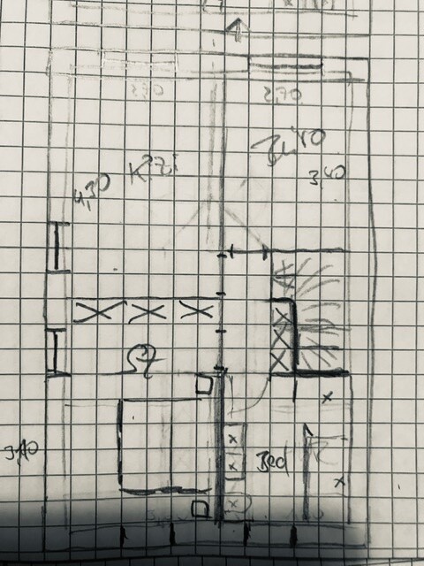

- Do-it-yourself based on a plan from the builder
6 rooms included, extra shower bathroom included, managed to get some storage space.

Narrow bedroom, very small utility room (must be at least 5 m² (54 ft²) according to the builder), one room with many corners in the attic.

Self-modified design proposal from the builder. Originally had only 4 rooms.
Is this floor plan even possible?
Have we forgotten something? Can it be made nicer somehow? According to the builder, the staircase can be smaller, but the space must probably be allocated to the utility room (which the builder says is too small).

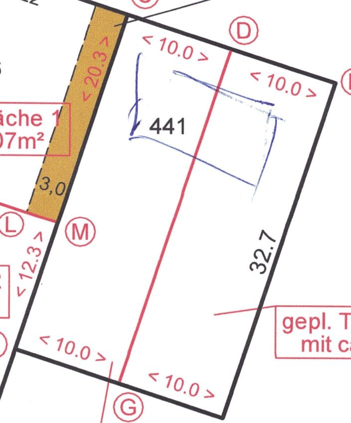

Location plan will follow.

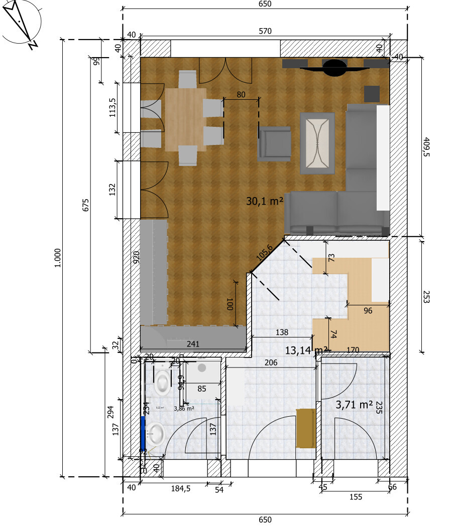

I really wonder why people put themselves through this just to live in a big city. But well.

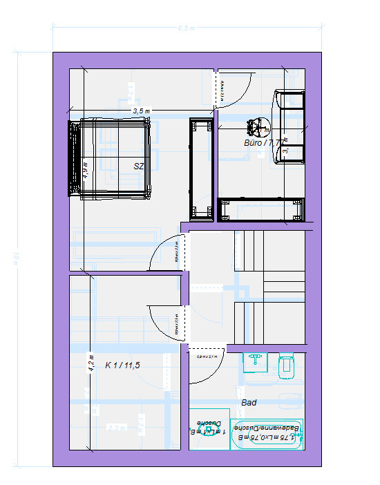

I took your designs and made some variations:
Basically, almost everywhere you only have minimum dimensions or sometimes even less. The technical room here meets the required 5 sqm (54 sq ft). Still, trying to squeeze everything in seems absurd to me and above all a lifelong punishment. Who is supposed to handle the laundry piles of five people in this tiny room and then constantly carry it up and down? Madness.
The entrance hall is obviously tiny, and a wardrobe for five people will never fit there. A cabinet of 1.40 m x 0.50 m (4 ft 7 in x 1 ft 8 in) is drawn in. The shower on the ground floor is only 80 cm (31 inches) deep—which might be manageable since it is a bit wider.

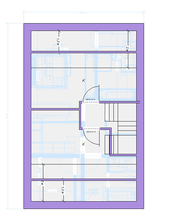

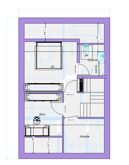

An alternative with the utilities in the attic:
In this version, it will be crucial what is possible under the roof. Here is a sketch with a knee wall height of 0 and a 45° pitch (the staircase has no landing):
Whether the drainage in the attic will work like this is doubtful. Most likely, the office and shower would need to be swapped, and the office would end up being just a desk corner. I mainly want to show that as soon as there is a knee wall of a significant size, the technical room could move into the attic (currently storage space). That would be helpful. Then there would be some relief on the ground floor, and some walls could still be shifted. So that would be my first question for the builder.
