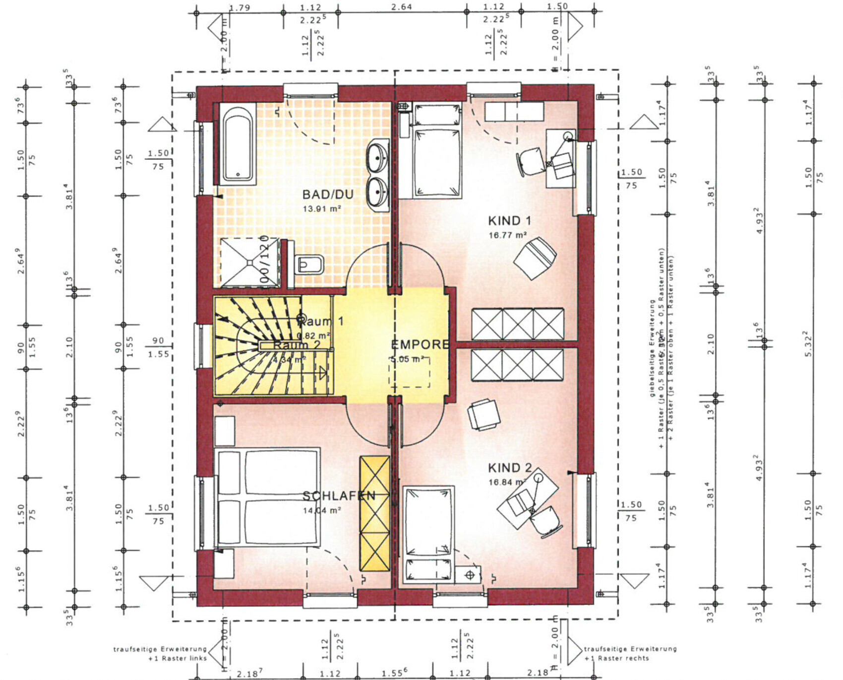

I have attached the architect’s first draft, but we don’t like it at all because the toilet is placed very prominently.
Floor plan of a house with bathroom/shower, bedroom, KID 1, KID 2, landing and stairs.

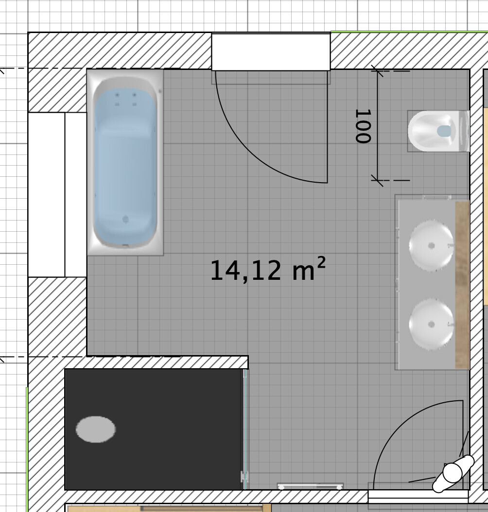

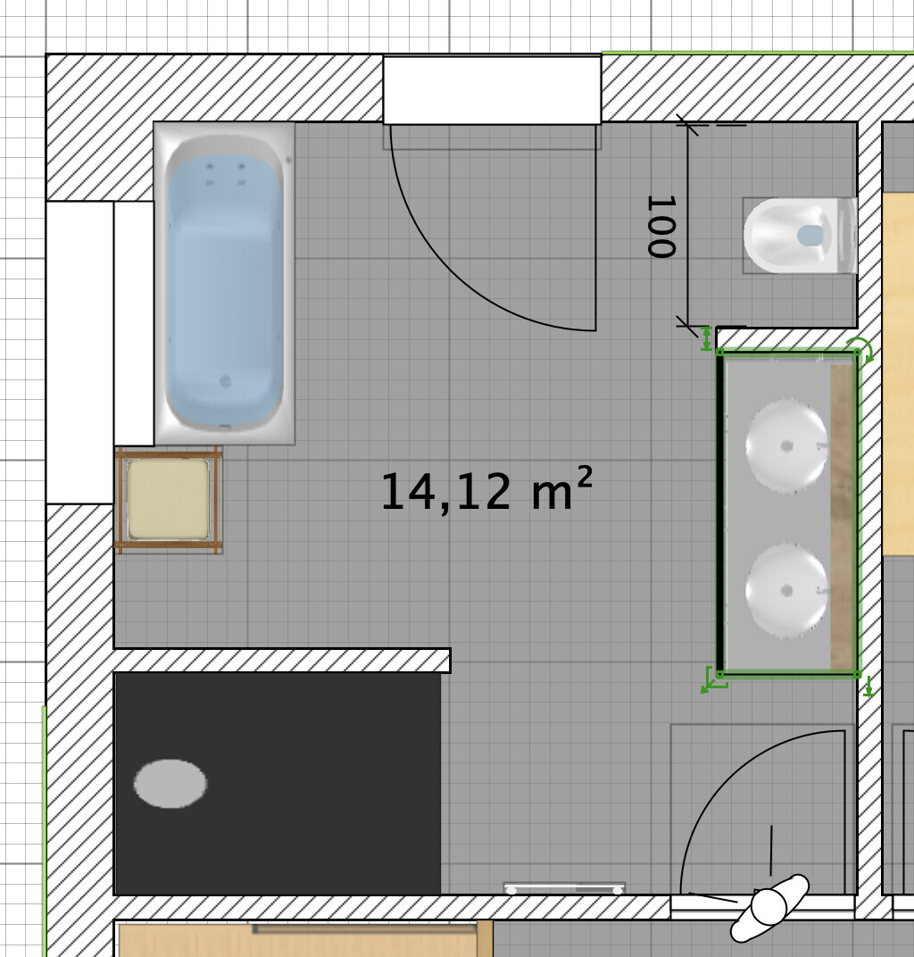

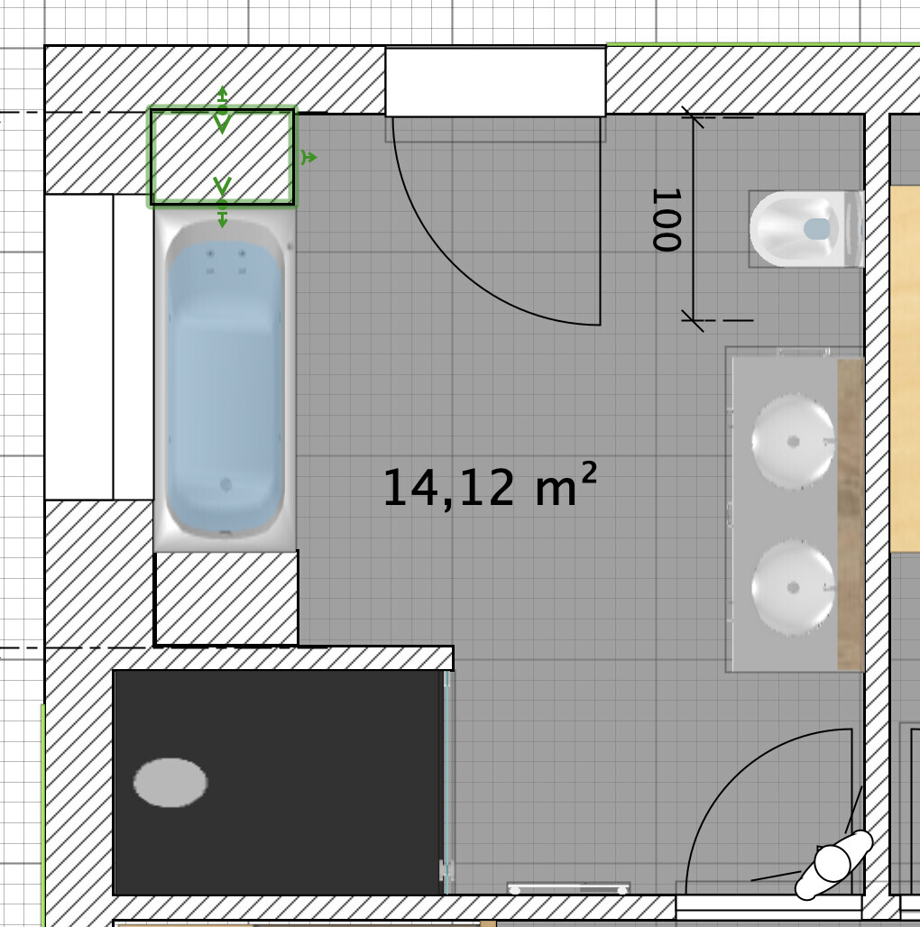

So we have already thought about how it could look and played around with some ideas, which I have attached.
Floor plan of a bathroom with bathtub on the left, double vanity on the right, toilet on the left, 14.12 m² (152 sq ft)
Floor plan of a bathroom: bathtub on the left, toilet on the right, double vanity on the right, 14.12 m² (152 sq ft)
We would be interested to hear your opinions or if you have any clever ideas we might not have thought of yet. Our goal is to give our architect useful input.

Floor plan of the upper floor of a house with bathroom, bedroom, two kids’ rooms, stairs and landing

Option 2 looks quite nice, doesn’t it?!
What is that brown box under the left window?
I would suggest placing the bathtub nicely on plinths and more centered; it might also be worth reconsidering the floor-to-ceiling window.
Additionally, I would remove the wall near the toilet – the washbasins already provide privacy, and the wall blocks light at the washbasin.
Ibdk141 Nov 2021 13:06
I would only position the toilet as shown in your second option. The privacy panel is actually not necessary. I would keep the shower as in the architect’s plan. This way it receives more light and the splash zone is not at the entrance door.

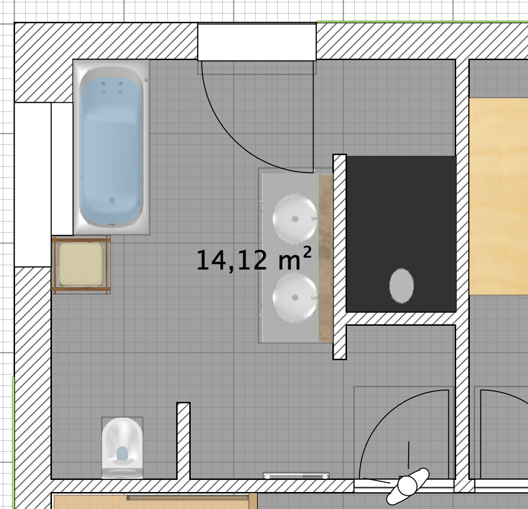

kbt09
1 Nov 2021 13:13
Variant 2 with the shower on the left wall won’t work well... since the knee wall is only 180 cm (6 feet) high. Unless it’s for someone of short stature 😉.

I would suggest placing the bathtub nicely on a platform and centered, and possibly reconsider the floor-to-ceiling window. Also, I would remove the wall by the toilet – the washbasins already act as a privacy screen, and the wall blocks natural light at the washbasin.
I would remove the wall by the toilet as well – the washbasins already provide privacy, and the wall reduces light at the washbasin.
Okay, I have updated the design. Is this what you meant? 🙂 With the two options, centered and flush, leaving space for a cabinet and laundry baskets.
One issue is still the roof slope and how to mount the showerhead. I’m thinking it might be positioned “too far forward.”

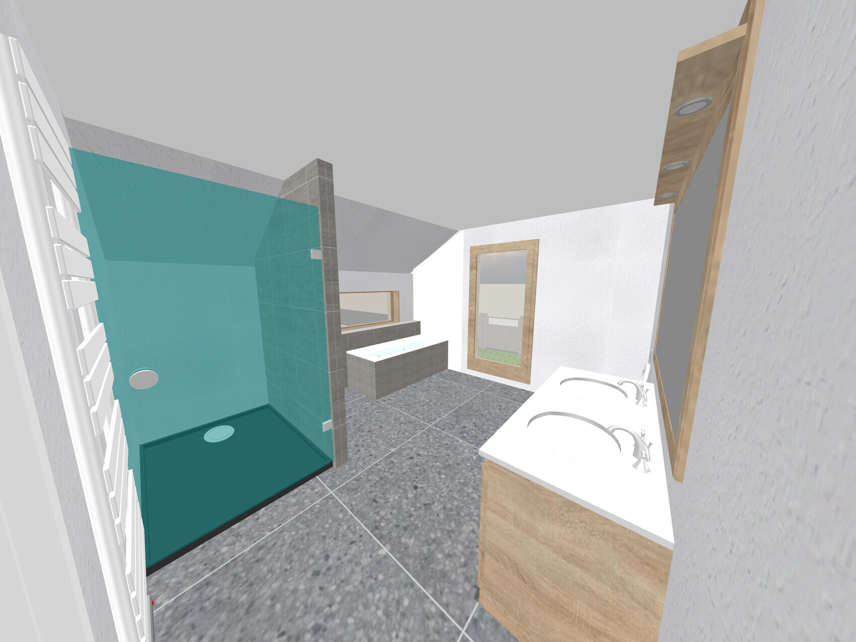

Bathroom layout: bathtub on the left, double washbasin on the right, toilet top right
Bathroom floor plan: bathtub left, double sink right, arched doorway, area 14.12m² (152 sq ft).
Modern bathroom: walk-in shower with glass wall, double washbasin, wooden frame mirror.
Modern bathroom view: shower enclosure with turquoise glass wall, bathtub and double washbasin
1 Nov 2021 13:45
kbt09 schrieb:
Variant 2 with the shower on the left wall won’t work well... the knee wall is only 180 cm (6 feet) high there. Unless it’s meant for very short people 😉.
diehäuslebauer schrieb:
One issue is still the roof slope and how to mount the showerhead. I’m thinking it might be “too far forward.”
@kbt09 is right here: this will be a mess.
The door could still be moved a bit, I think. So it might be possible to rearrange the furniture a little.
