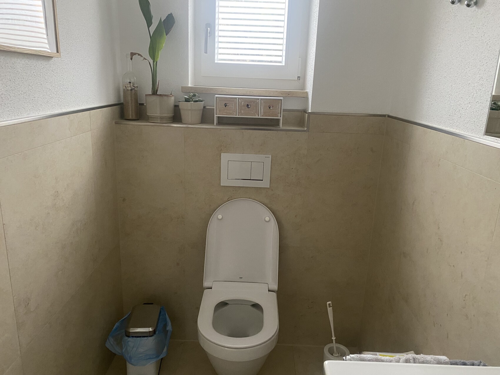

Would it even be possible to install a shower or bathtub in front of the wall? There is underfloor heating, which might make drilling downwards difficult! I am open to all suggestions. It’s always better to have heard different opinions in advance.
Thank you and best regards
Helles Badezimmer mit Toilette, Waschbecken, Unterschrank und grauem Badteppich
Flur mit weißem Schrank mit Spiegel, Willkommensschild, Pflanzen; Badezimmer mit Toilette sichtbar.
Badezimmer: Beige Fliesen, Wandbild, Fenster mit Pflanze, Toilette, Mülleimer.
Weißer Waschtisch mit Armatur und Seifenspender; Spiegelkabine darüber, Regal mit Handtüchern.

Thank you for the constructive question! Yes, it exists along with the option to branch off. But yes: the underfloor heating worries me. It would probably be better to install a shower or bathtub directly in the basement itself rather than modifying the existing room. The room itself is too small; a tall person can fit in to use the toilet and wash their hands properly, but there’s no space for a shower. Above this room is the enlarged bathroom, which explains the waste pipe. Overall, this should have been planned more carefully. But as is often the case... you always know better afterward.

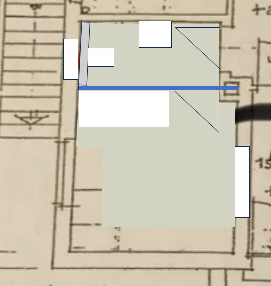

You’re not making it easy for us. Exactly where is the wall? What is the distance to the upper wall in the bathroom? Where exactly in the wall is the door located? How large is the door? Which way does the door open?
So far, this is how I understand you.
Building floor plan with blue line and white door/window rectangles.
Now it’s your turn to enter the measurements here. Please use a pencil to mark any possible misunderstandings. Do not use a marker, as we are dealing with centimeters and sometimes even millimeters, not meters.

Thanks for the effort, @hanghaus2023. (By the way, we also have a house on a slope.) I’ll need to look into this more carefully later when I have a tape measure and am at home.

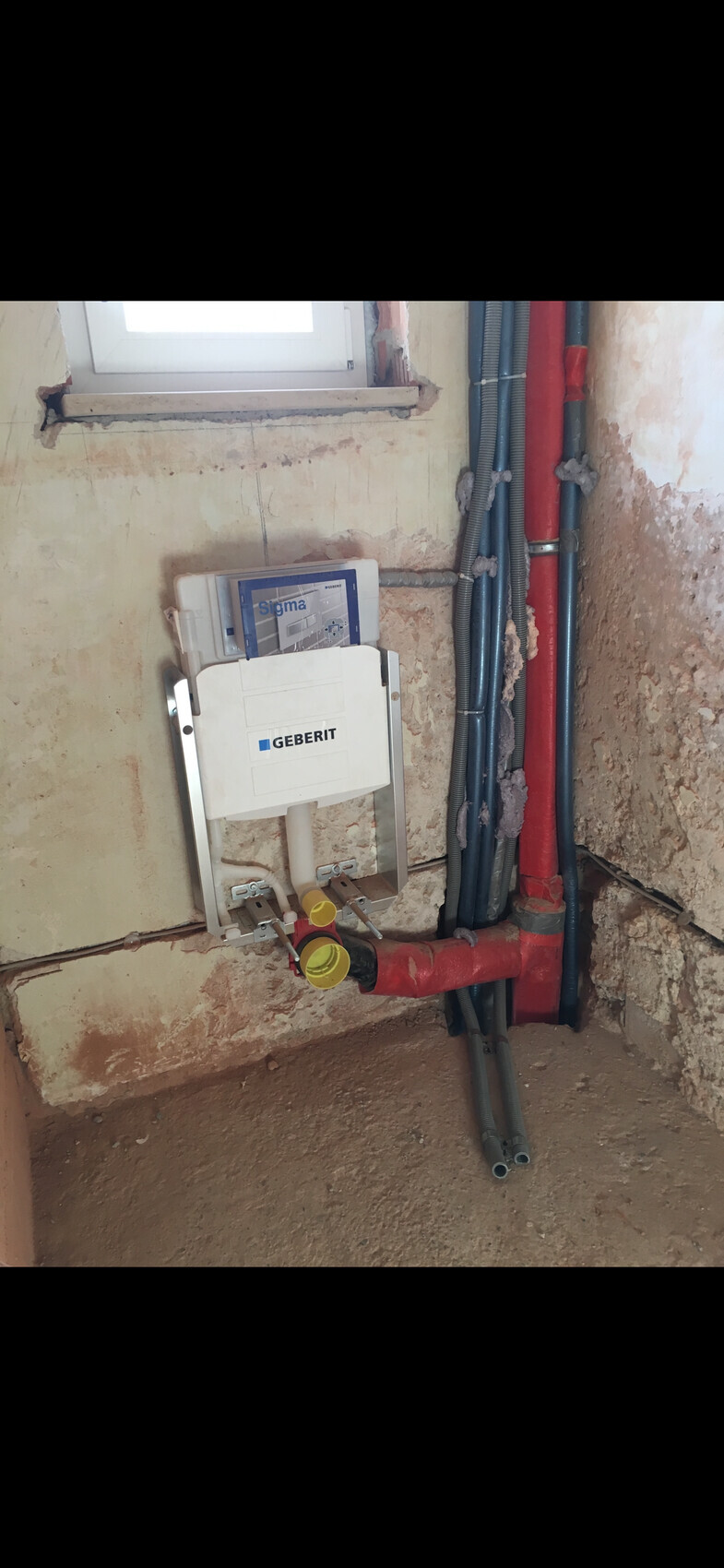

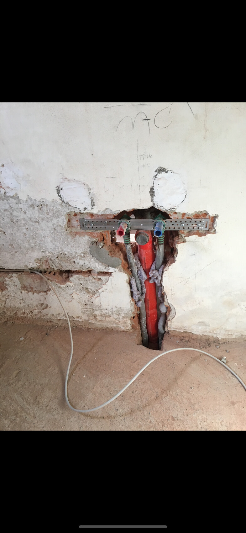

Attached are the pipes. Am I correct in understanding that it would be possible to extend hot and cold water lines from the downpipe? Could a shower be installed instead of the toilet? But what about the window? Is there a risk of mold? I could remove the door (it opens inward and swings to the right).
I have already received some good tips! Thanks in advance.
We actually installed underfloor heating right up to the edge.
Geberit Sigma flush tank on a raw wall, red and blue water pipes visible.
Open wall with red main pipe, two colored valves and metal bracket.

My wife says it’s 150 cm (5 feet) from wall to wall.
