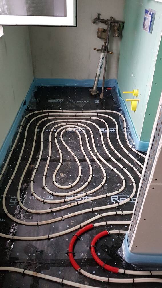

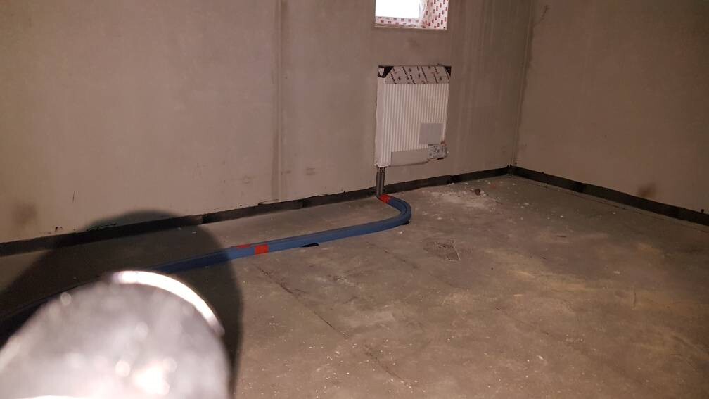

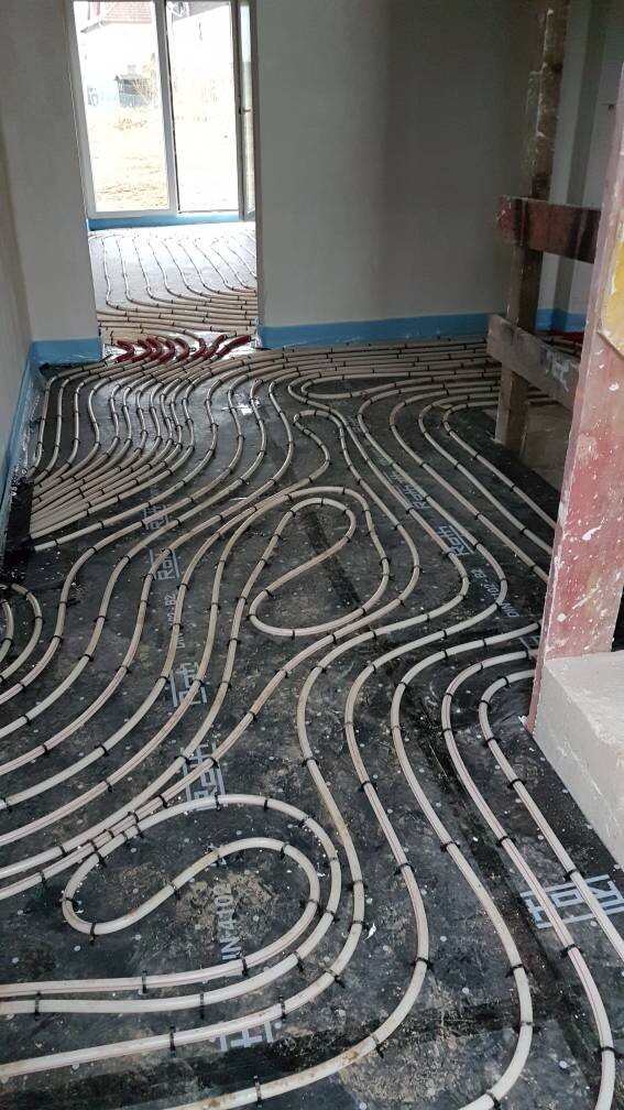

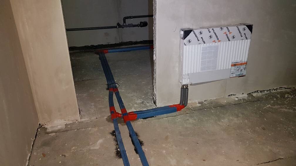

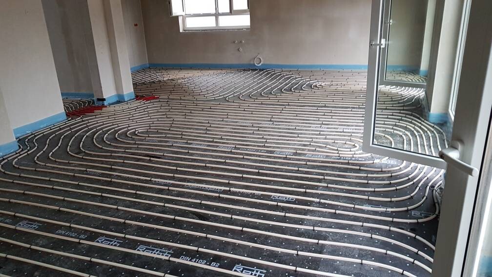

There’s some real progress here. Underfloor heating and radiators have now been installed in the basement.
Now we just have to wait for the screed [emoji6]. Let’s see if it will happen next week [emoji848].
However, I don’t understand why the shower area in the guest bathroom has insulation installed slightly deeper and there is no underfloor heating. That area will be tiled. I can understand it for the upper floor with the shower tray. I’ll have to talk to our site manager about this tomorrow.
