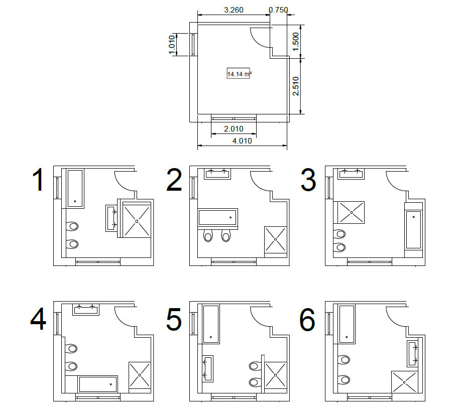

I would appreciate it if you could take a look at our bathroom layout plans.
Here is some background information:
  • 14.4m² (155 ft²), upper floor (full story), window sill height = 1m (3.3 ft)
  • The designs are roughly oriented to the north; to the east of the bathroom, behind the drywall, the bedroom is mirrored.
  • It probably makes sense to avoid placing the toilet on this wall.
  • Design option 1 corresponds to the original plan, but the L-shape is not desirable (too cramped, too little light).

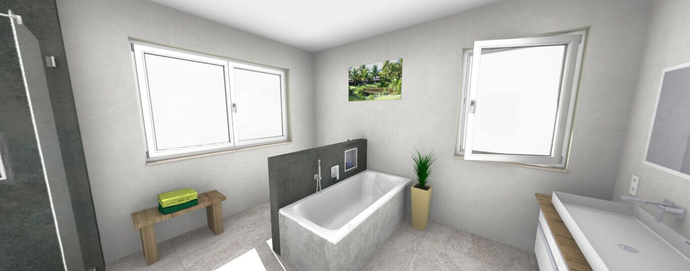

  • Design option 2 was proposed by the bathroom planner, and a corresponding 3D rendering is included. I actually like it,
  • but my partner dislikes the small partition wall as well as the view from the toilet towards the window.
  • The other designs are my (failed) attempts to fit all sanitary fixtures in the room 🙁
  • Required are: bathtub, shower (120x100cm (47x39 inches), mostly glass, with a door), toilet, bidet, sink (120cm (47 inches) wide)
  • Dark, secluded corners are not desirable, so the T-shaped design is ruled out as well
  • If necessary, we would also consider a freestanding bathtub, or possibly a corner bathtub, if that fits better.
  • Adjusting the windows by a few centimeters or modifying the sill height on the west side would probably also be possible
  • I imagine a bathtub in front of the windows might not be very practical, but I wouldn’t completely exclude it
  • The windows face the street or the neighbor’s property, so the view is not a major consideration 😉
We will try to schedule another appointment with the bathroom planner soon, but we don’t want to come completely unprepared,
so any tips are very welcome!

Wow, something quite different this time 😉 I actually like the idea of a separate toilet area, but I agree with
motorradsilke: this would break up the bathroom a bit, and you would probably have to plan something like this from the start in the floor plan.

Mandatory visualization with a shower by the window (Did not have a 110cm (43 inch) shower tray on hand quickly):

Is the size of the window fixed? Otherwise, maybe it could be made only half as large? That would leave a lot of space for the shower.
