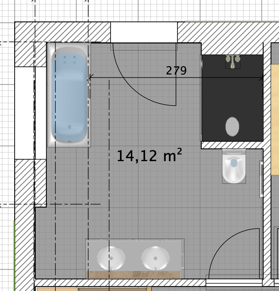

So we have already thought about how it could look and played around with some ideas, which I have attached.
Floor plan of a bathroom with bathtub on the left, double vanity on the right, toilet on the left, 14.12 m² (152 sq ft)
Floor plan of a bathroom: bathtub on the left, toilet on the right, double vanity on the right, 14.12 m² (152 sq ft)
We would be interested to hear your opinions or if you have any clever ideas we might not have thought of yet. Our goal is to give our architect useful input.

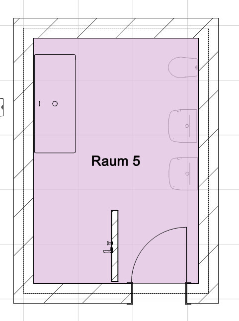

Ibdk141 Nov 2021 14:07
Was it really not possible if the partition wall is roughly positioned and the shower head could be attached to it? As always, not to scale, just a sketch.
Grundriss Raum 5: großes Rechteck, rechts drei Toiletten, links Schrank, Tür unten rechts

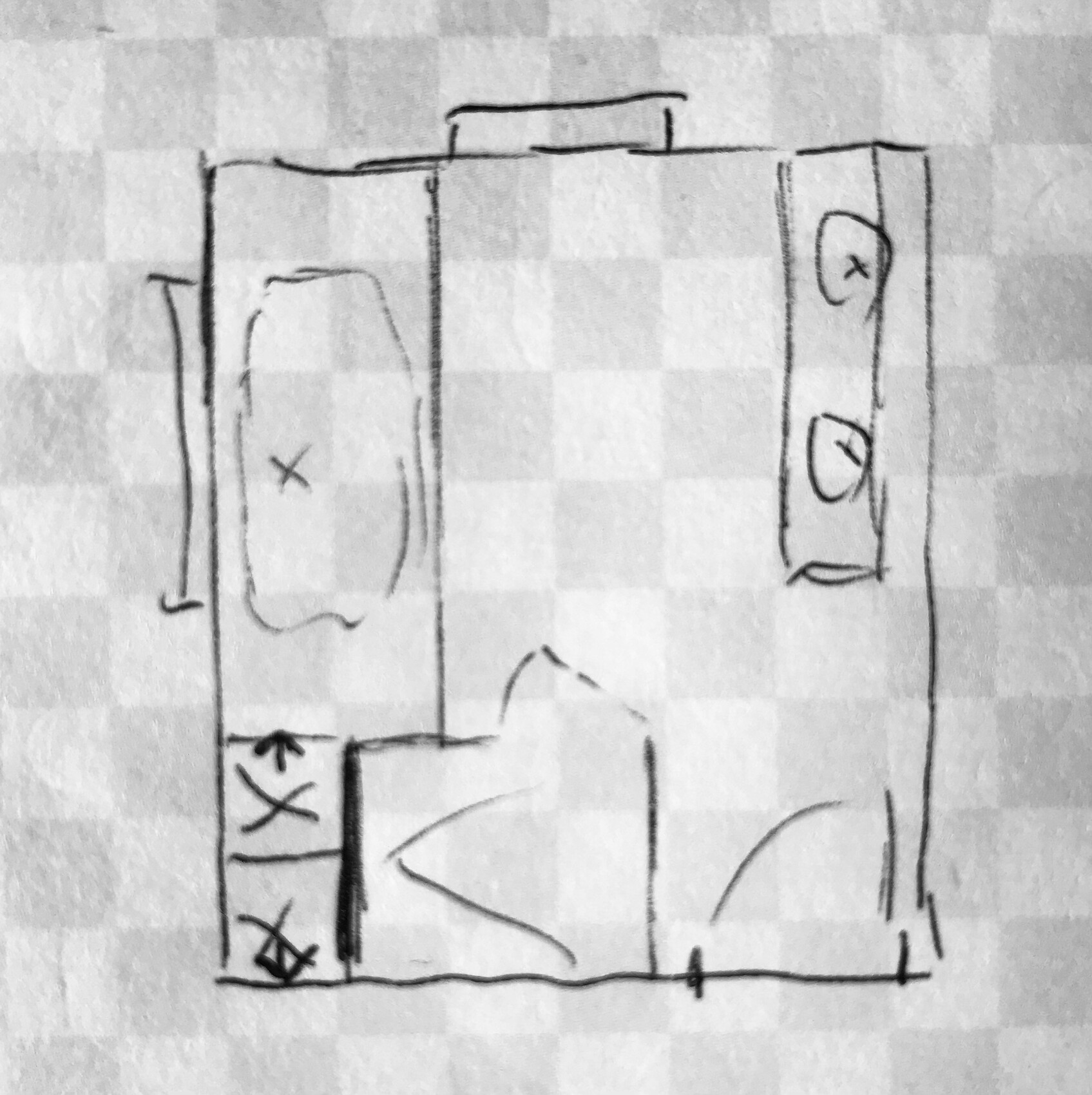

1 Nov 2021 14:21
Maybe like this?
Although then I would shower facing the door… you’re planning a glass door anyway.

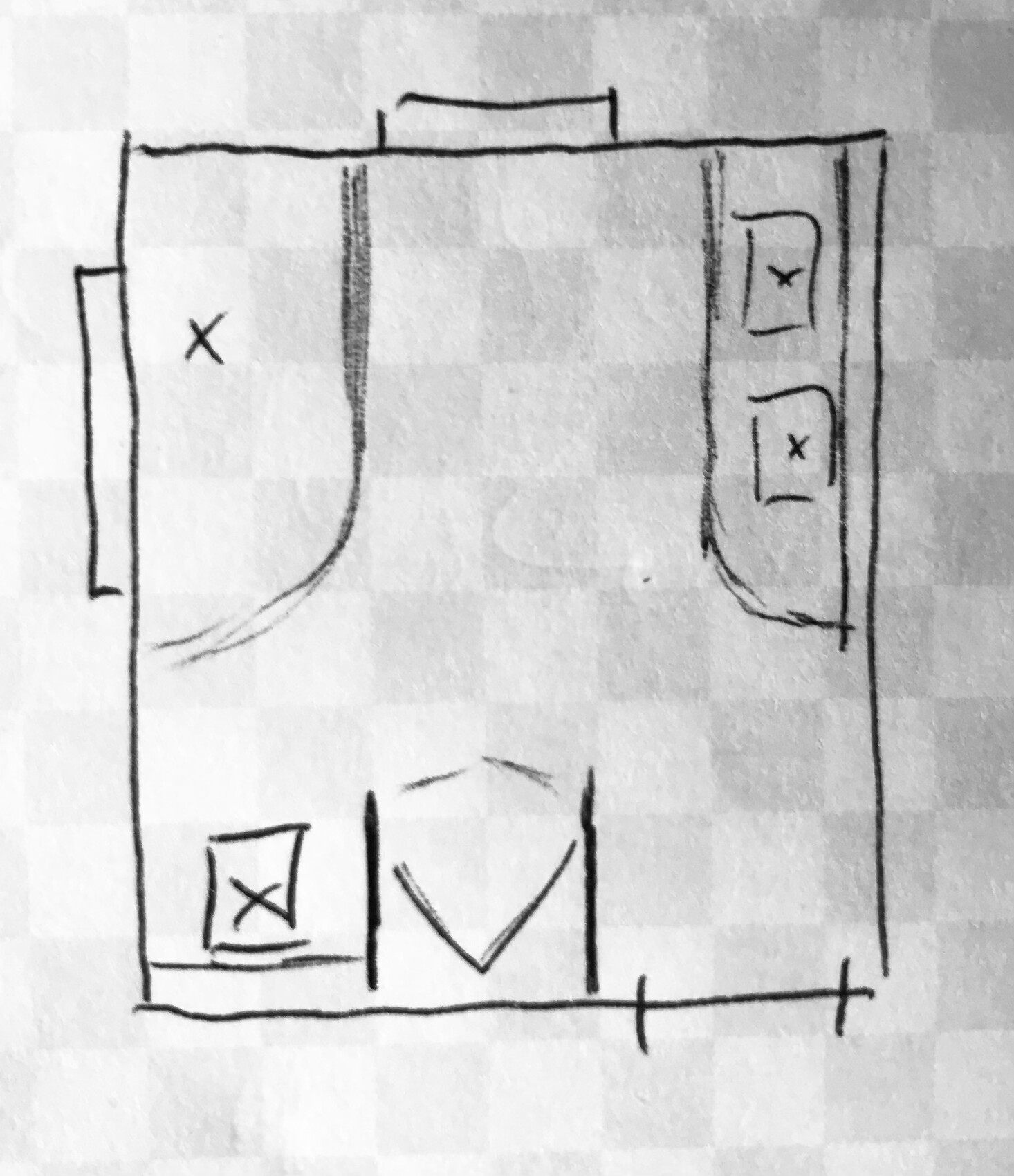

Room floor plan from above: left corner bench, right two boxes marked with x’s, central semicircular shape.
Or like this instead, then you could move the shower slightly forward and use the free area for built-in wardrobes.

Thanks a lot for the many inspirations. We have put our heads together again and found two options that we really like.
Option 1: (Currently probably our favorite)
Bathroom floor plan: Bathtub on the left, toilet at the bottom, double sink at the bottom, door on the right, 14.12 m² (152 sq ft).
What do you think? The only question here is whether the distance between the toilet and the washbasin is sufficient to avoid feeling “too cramped.”

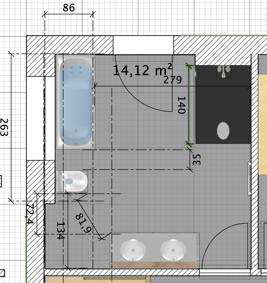

Option 2:
(And yes, you walk directly towards the toilet here ;-) )
Bathroom floor plan, 14.12 m² (152 sq ft): Bathtub on the left, double sink at the bottom, shower on the right.
What do you think?

1 Nov 2021 22:46
diehäuslebauer schrieb:
What do you think about this? The only question here is whether the distance between the toilet and the washbasin is sufficient to avoid feeling "too tight."
Why do you think the distance—your marking—is too small? It’s not a passage to anywhere. It’s just an empty space/area…
1 Nov 2021 23:20
Why should the distance—your marking—be too small? This is not a passageway to anywhere. It’s just an empty space/area…
… which doesn't really make for a very attractive design either.
