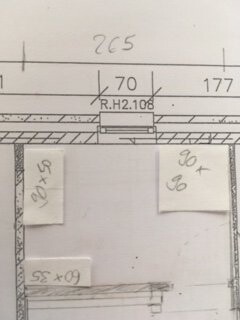

I am currently working on the floor plan for my apartment, which is part of a larger construction project with centralized planning. I have only limited options to make changes to the layout.
The bathroom is quite small (220 x 180cm (87 x 71 inches)). How large should a shower be to allow comfortable use without bumping into anything?
At the moment, I shower standing in a bathtub that is 180cm (71 inches) long and open at the front. It’s difficult for me to compare or measure.
What is a practical and comfortable size for a shower?
Bertram10028 Aug 2017 13:15Option 4: The storage cabinet is replaced by a 60x35cm (24x14 inch) countertop for placing small items and for makeup. The layout differs slightly from option 3.
I realize that I would prefer a 100x100cm (39x39 inch) shower, but it clutters the room more than a slightly smaller shower. A 90x90cm (35x35 inch) shower is the more practical option. Depending on the location, it could also be 90x100cm (35x39 inch).
A 90cm (35 inch) wide washbasin seems sufficient for washing. I still need to create a makeup area, possibly simply at the washbasin using a mirror cabinet (I would prefer just a mirror without a cabinet, but that costs a lot of practical space).
Have I missed anything important? Yes, I now see it myself. In option 4, there is not enough space between the washbasin and the makeup area at the bottom of the plan.

Bertram10024 Sep 2017 09:48I wanted to provide an update: I learned from the plumber that all my ideas involving a corner shower with wall construction are quite costly due to having two glass sides with a door, as well as building and tiling the wall. So, I have decided to go back to the original plan shown in the sales layout: on the left side, a shower measuring 180cm by 90cm (71 inches by 35 inches) with a 120cm (47 inches) glass panel as a divider.
Unfortunately, the window has a sill height of 80cm (31 inches), which means nothing can be installed under it. This leaves space to the right of the window for a washbasin about 80cm (31 inches) wide. That’s it—shower on the left, washbasin on the right. I will change the door though: it will either open outwards or be a sliding door.
Thanks for your advice; the shower issue is solved by installing an extra-large shower.
Bertram10030 Sep 2017 12:04Just a quick question about the shower: there will be a shower tray measuring 90 x 180 cm (35 x 71 inches) with an open entrance from the side. The shower enclosure is 120 cm (47 inches) long, leaving 60 cm (24 inches) for entering. I can install the shower head and faucet on the short side "facing forward" or on the long side. The latter would give me more space to the left and right, while the former might reduce water splashing outside the shower area. At least I assume so, but I’m not sure. So I’m asking you: where is the best place to mount the showerhead?
