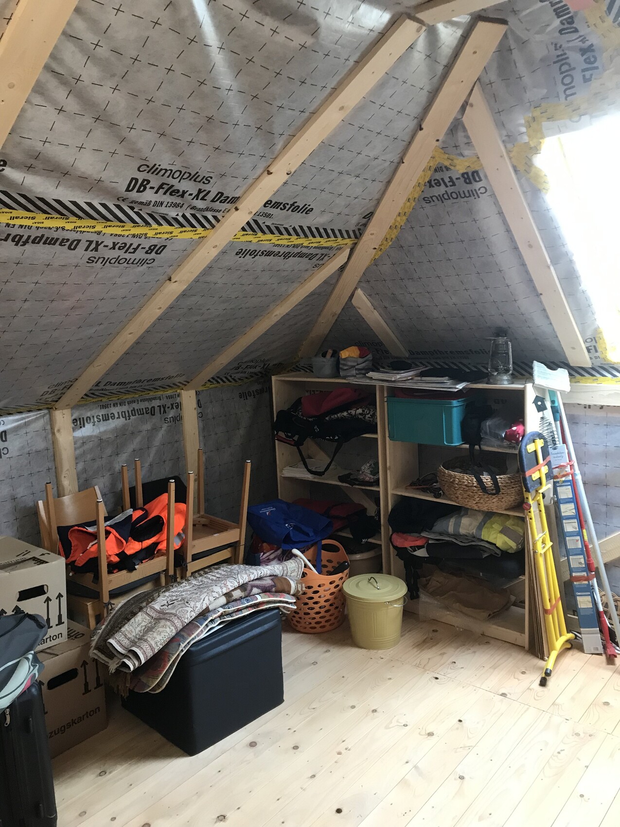

I am not referring to a roofing underlayment but to the membrane installed after placing insulation between the rafters.
Initially, a vapor retarder was supposed to be used, but the construction manager has now specified an energy-saving foil with an sd-value of over 100, so a vapor barrier.
The question is whether it makes sense to use a vapor barrier instead of a vapor retarder, and when to use each type of membrane.
