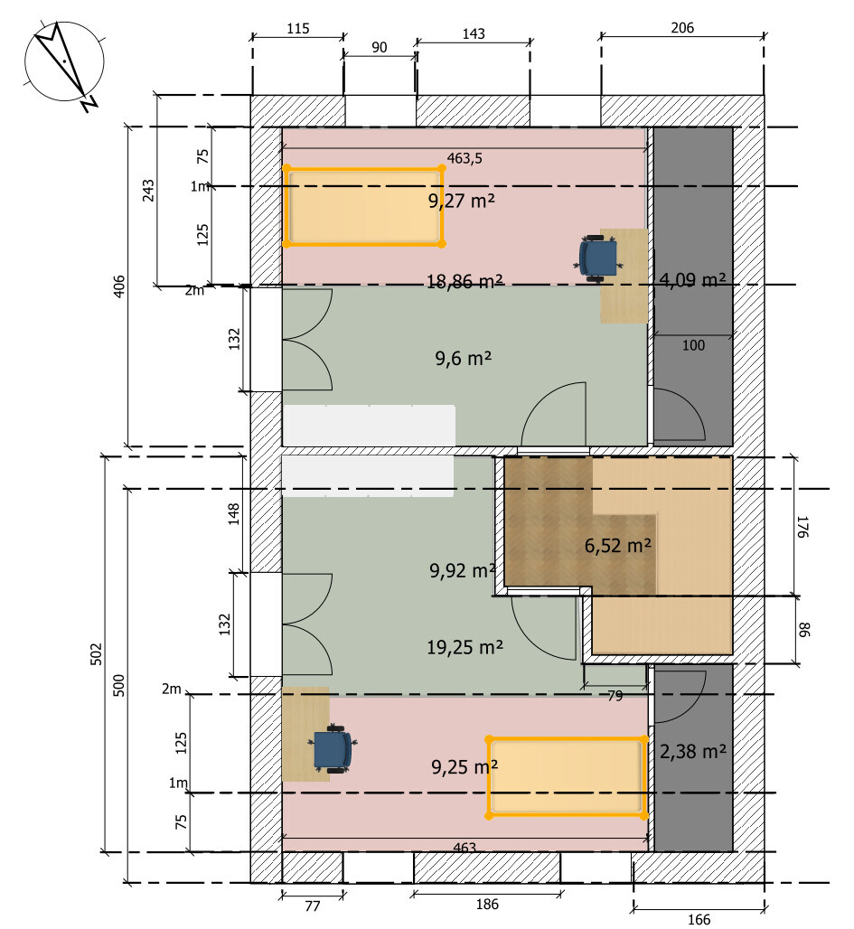

It’s also tight in the attic. Beds are partially below the 1 m (3.3 feet) height line.

In the attic, the master bedroom with its own bathroom and a storage room.

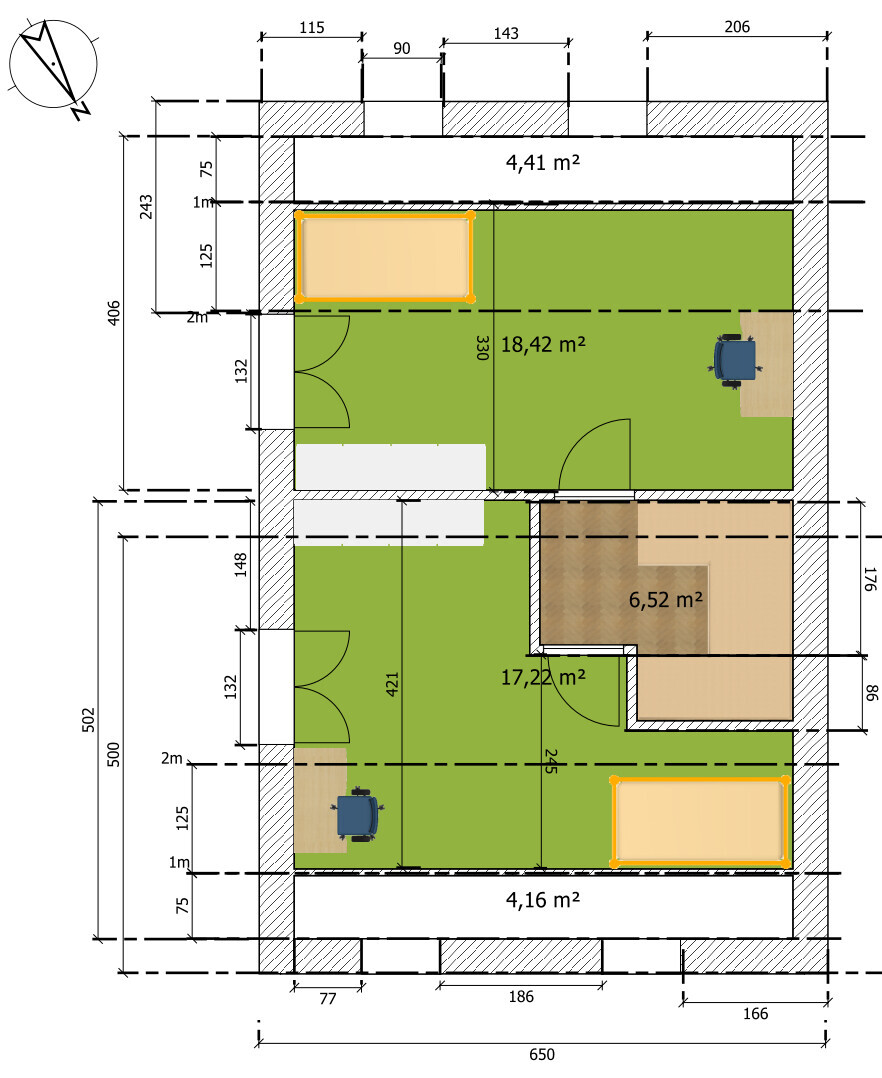

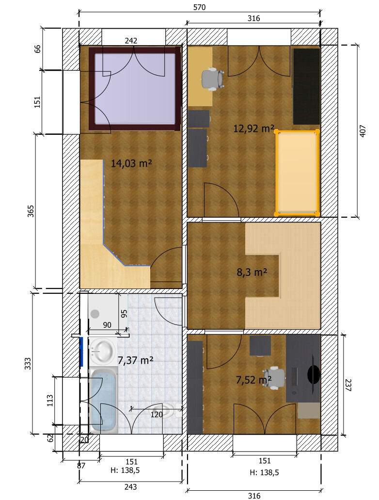

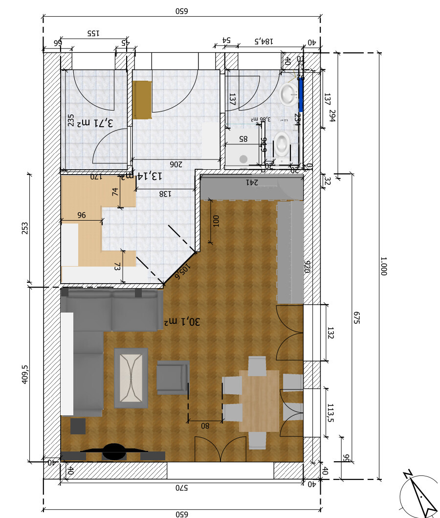

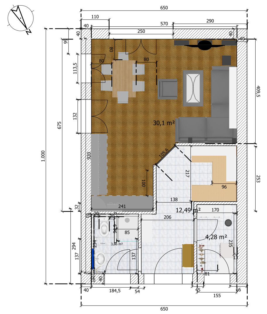

I adjusted the staircase to the dimension specified by the builder and added the gained space to the utility room.
I then marked the air-to-water heat pump (Vitocal 200 S by Viessmann) noted by the builder (the graphic model actually looks like a stove, but I adapted the dimensions to the air-to-water heat pump). I also moved everything 10 cm (4 inches) forward to possibly allow for connections and pipes.
I added a storage cabinet (50x100x235 cm (20x40x93 inches)). Overall, I think it fits well.
In the attic, as you suggested, I only placed storage along the sloped ceiling. This way, the full-height space remains available for the rooms.
