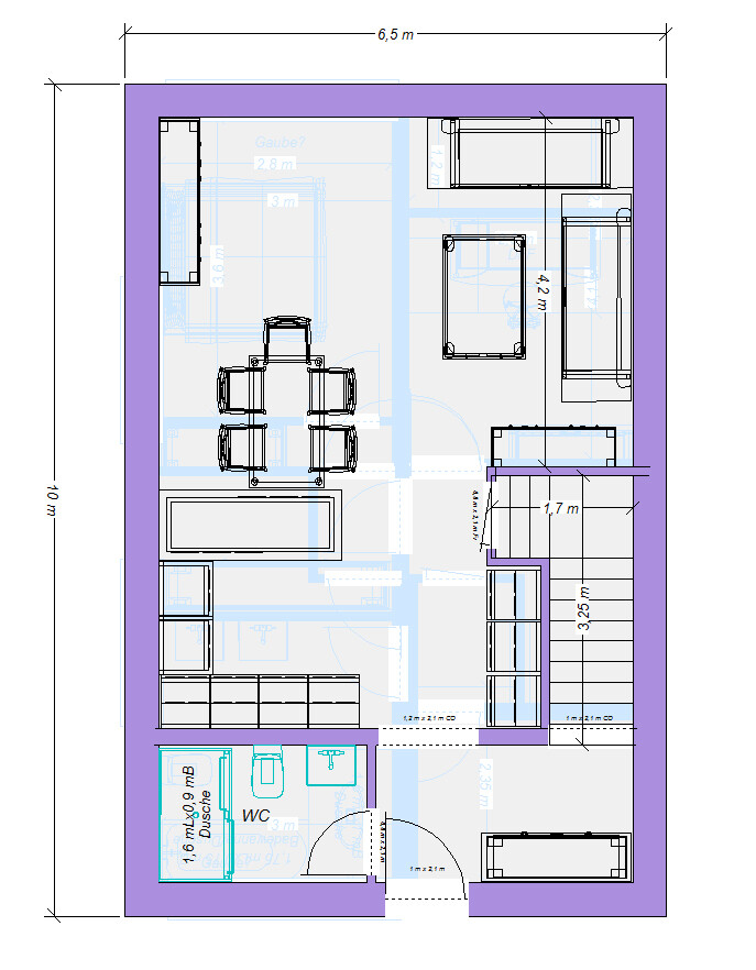

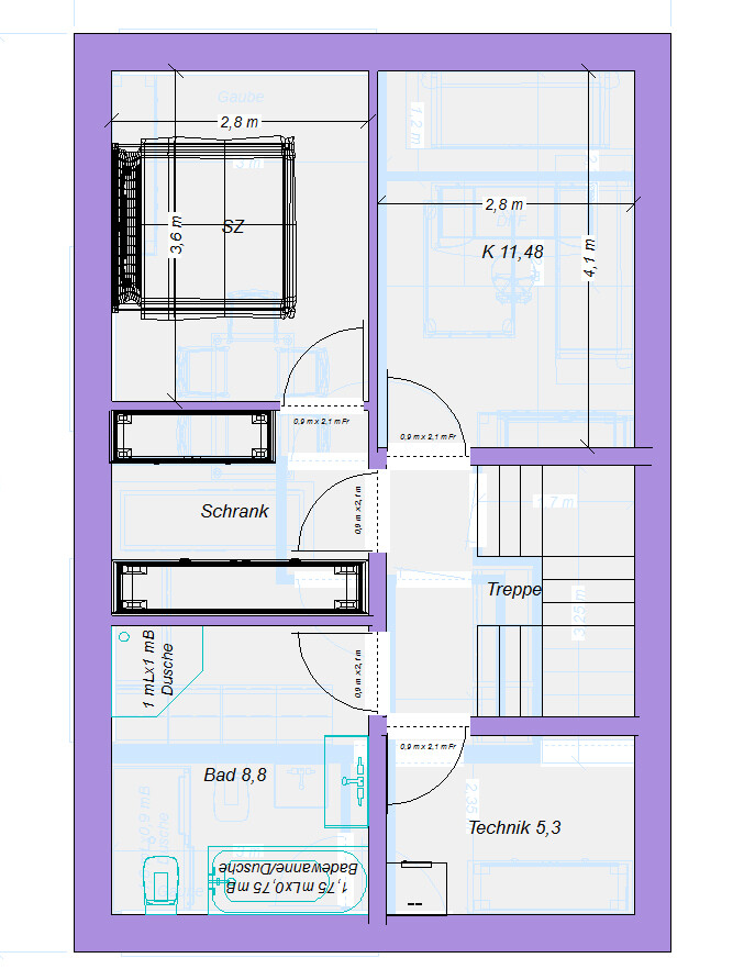

Plot size: 327 m² (3,526 ft²)
Slope: no
Site coverage ratio: 0.2
Floor area ratio: 0.3
Building window, building line, and building boundary
§34 - 3 m (10 feet) setback, etc.
Edge development: Not relevant to the question
Number of parking spaces: 1
Number of floors: 2
Roof type: Gable
Architectural style: Modern
Orientation
Maximum heights/limits
Other requirements
The house itself is determined by the developer and therefore cannot be influenced in terms of dimensions, shape, and orientation (see floor plans). The focus is solely on the internal floor plans, layout, and optimal use of space.
Homeowners’ Requirements
Style, roof type, building type: Set by developer, as above
Basement, floors
No basement, 2 floors with converted attic
Number of occupants, age
Current: 2 adults, one child (8 years), two more children planned
Square meters predetermined by the building (52.44 m² (565 ft²) gross internal floor area)
Office: Home office?
Overnight guests per year: 8
Open kitchen: Yes, island only if not too cramped
Number of dining places: 6
Fireplace: no
Music/stereo wall: home cinema
Garage, carport: no
Utility garden, greenhouse: later, not part of the question
Additional wishes / special features / daily routine:
We still need some storage space somewhere, as there is no basement.
Extra shower bathroom, because with 5 people in the morning it would otherwise get too congested, and also for guests.
Partner dislikes “slanted” room doors, so rooms should always be accessible at right angles (entry to kitchen/living room is an exception (but no door installed there either)).
Planner:
- Do-it-yourself based on a plan from the builder
6 rooms included, extra shower bathroom included, managed to get some storage space.
What do you dislike? Why?
Narrow bedroom, very small utility room (must be at least 5 m² (54 ft²) according to the builder), one room with many corners in the attic.
300,000
330,000 (all in, excluding exterior works and additional costs)
Preferred heating technology:
Air source heat pump
If you had to give up, on which details/extensions
- could you give up:
Storage room (then maybe as a shed?)
- cannot give up:
Second shower bathroom, separate office
Why is the design the way it is? For example
Standard design by planner?
Self-modified design proposal from the builder. Originally had only 4 rooms.
Is this floor plan even possible?
Have we forgotten something? Can it be made nicer somehow? According to the builder, the staircase can be smaller, but the space must probably be allocated to the utility room (which the builder says is too small).
We are particularly concerned about the lack of storage space (no basement, no attic).
Where do you store your stuff then (not bulky waste, but items you do not need all year round: inflatable boat and air mattress, Christmas tree, winter jackets, etc.)?
Location plan will follow.
Thanks and regards

Pinky0301 schrieb:
Does it fit on the area and in terms of height?I don’t have the complete measurement chain, but the lower wall of the utility room (HAR) should be 3.7 m (12 feet) away from the exterior wall. At a 38° angle, that is 2.89 m (9.5 feet) plus a 24 cm (9.5 inches) purlin minus 13 cm (5 inches) floor build-up. So, a total height of 3.0 m (10 feet) and a usable clearance of 60 cm (2 feet), although the height then increases to about 1.3 m (4.3 feet) further along, with a finished ceiling height of the utility room (HAR) at 2.4 m (7 feet 10 inches). If this is too tight, the utility room can still be shifted upward on the plan, or it can be checked whether it can be narrowed in width or if the finished ceiling height can be lowered.Regarding fixed boxed-in encasements versus boxed-in cabinets with sliding doors, you can look up the YouTube video "GQPczI9oNwo," which explains how to build something like this quite easily yourself. Combined with dressers on casters, you can effectively use sloped spaces from 0 to 130 cm (51 inches) in height as storage.
kaho674 schrieb:
Then I’ll happily add two large dormers to the attictogether with the modified staircase layout: applause! So far by far the best floor plan here.Similar topics
