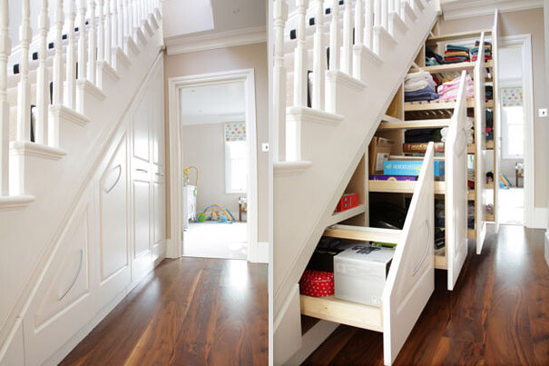

The coat area and storage space are planned under the staircase. I’m attaching a picture.

The coat closet and storage space are planned within the staircase. I’ll attach a picture.
