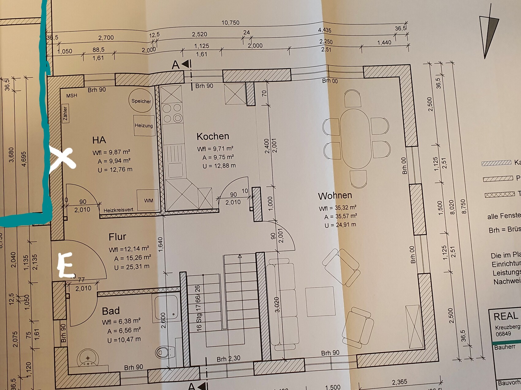

we are considering adding an access door from the garage to the house, specifically into the utility room, as part of our planning. The issue is that the garage is located 1 meter (3 feet) away from the neighbor's property. If I remember correctly, it should be at least 3 meters (10 feet) away if there is direct access between the garage and the house. I have already checked the garage regulations for LSA but could not find a relevant clause.
Does anyone have experience with this topic and can provide more detailed information? Moving the garage further away to achieve 3 meters (10 feet) distance is not possible.

I also posted our floor plan here A floor plan layout for the garage/laundry room, where it fits very well. I admit I haven’t followed how the thread developed since then.
What are we usually discussing in 9 out of 10 cases here? An 8.5 m² (91 sq ft) laundry/utility room that combines technical equipment, laundry, and pantry all in one. It’s also supposed to serve as a buffer zone since it’s constantly raining here when we come home. My house, my car, my extra door to the garage/utility area – that’s all it is. A status symbol.

SebastianH. schrieb:
Here is a simple image of our floor plan.
The X marks the spot where the treasure is buried. That’s where the door should go. ...this is exactly what has been discussed and mentioned here:

Nice-Nofret28 Sep 2020 21:38And why are your interior doors consistently placed in the corners instead of the middle of the room? This makes furnishing really inconvenient. You can also see this in the awkward kitchen layout...
SebastianH.28 Sep 2020 21:47Nice-Nofret schrieb:
And why are your interior doors always located in the corners instead of the middle of the room? That makes it really difficult to furnish. You can also see that in the cramped kitchen layout....The door in the kitchen will be removed, so then only the utility room and bathroom will have doors "in the corner." I would find furnishing in the bathroom/hallway area more challenging if the door were in the middle.Similar topics
