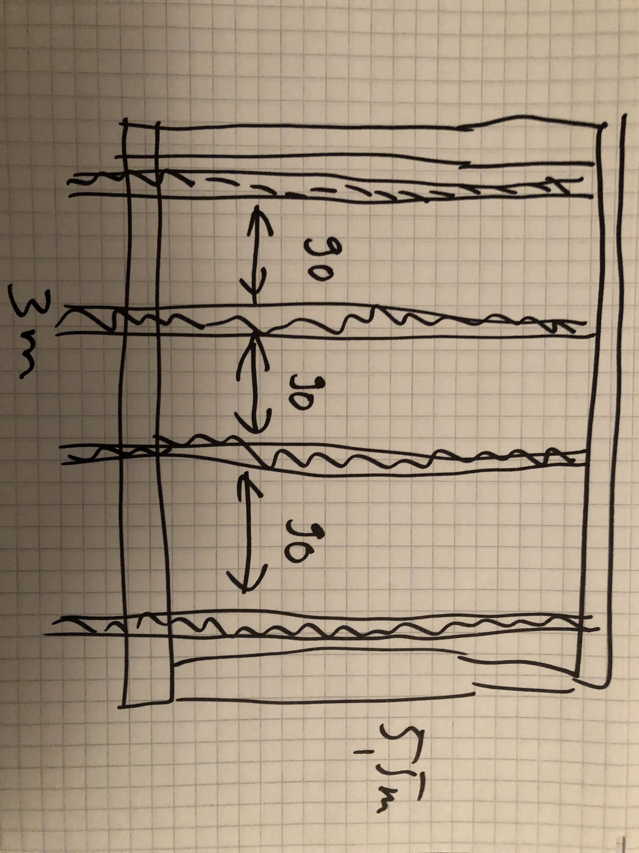

we have a fairly large hallway (approximately 3 x 5.5 m (10 x 18 ft)), with a 2 x 2 m (6.5 x 6.5 ft) stairwell opening. We have planned only one double casement window measuring 74 x 118 cm (29 x 46 inches). The rafters are arranged so that the window can be placed either on one exterior wall, the opposite exterior wall, or in the middle.
My question is whether the room might end up too dark. Considering symmetry, I see only three windows as an option. What do you think?

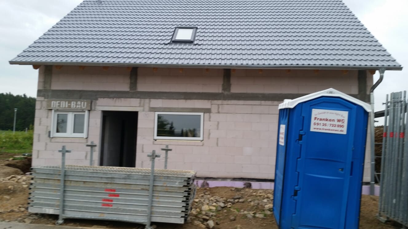

As a side note, the hallway on the ground floor is also not very bright because we don’t have a fixed sidelight next to the door, only a small extra window. It would also benefit from natural light from above…
My current ideas:
1) Place two windows above the stairwell opening so that it is at least symmetrical with the opening. I would not put a window above the gallery then.
2) One window in the center.
3) Three narrower windows.

boxandroof3 May 2019 22:16Or you could give the storage room a nice south-facing window and a glass door.
boxandroof5 May 2019 15:24I think either two windows above the staircase or all three windows would look good.
North-facing windows have a negative energy balance; if you’re not particularly attached to having three, I would go with two.
M4rvin schrieb:
