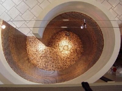

I once read that if there is no space for a straight walk-in shower, the shower wall should be designed like a snail shell. However, I think this solution also requires a lot of space.
Here is an example from Fliesen-tielmann
Runde spiralförmige Treppe mit mosaikfliesen im Treppenhaus von oben
