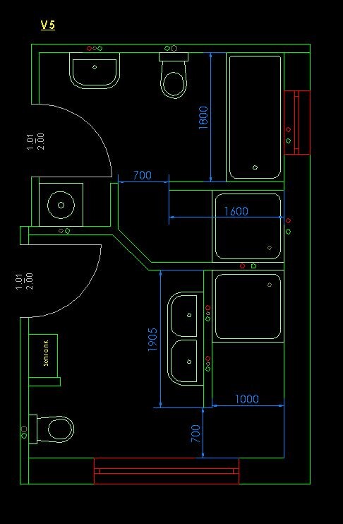

please help me. For days, I have been drawing various layouts, thinking I found a solution, only to discard it again. This is driving me crazy.
I want built-in walk-in showers in both bathrooms, completely without doors.
In the master bathroom, a small bathtub is planned, as well as a comfortably sized walk-in shower and, if possible, a double sink.
You will find the architect’s proposal attached.
I find the shower partition in the children’s bathroom not long enough, but it seems it cannot be made longer because of the window.
In the master bathroom, the toilet is too close to the shower entrance. Perhaps the shower wall could be shortened.
Do you have any ideas?
The two drawings are mine.
Windows are not fixed and can be changed freely.
The drawing with the washing machine + dryer is the children’s bathroom.
Thanks in advance!

Yes, I’m moving away from 1.60 meters (5 ft 3 in). I’m currently focused on aesthetics. I can’t find anything like this with a slope on Instagram or Google. It seems it’s generally not done. But why? I don’t want it to end up looking like it was attempted but poorly executed.

I like Version 4. But I'm a bit of a perfectionist. Would it be possible to have the partition walls run straight for a few centimeters and then angle like in Version 1? It would be enough for me if I could stack the dryer and washing machine. @matte1987
Has anyone actually seen a walk-in shower with a slanted wall like this? Does it look odd, and do you think it’s possible to have no door at all for the shower in Version 4?
I’m not sure I fully understand what you mean. I’ve attached a try at realizing it. I wouldn’t worry about the slanted wall in the shower—on the contrary.
I find it interesting and refreshingly different. I’m usually not a fan of angled interior walls, but here it’s not about furniture placement.

Yes, perfect. That makes my inner perfectionist happy. I really have a bit of a quirk about that.
I would then buy or have a cabinet made for the washer and dryer. That way, they can be stacked, and there might still be a shelf on the side for detergent, towels, etc.
According to your drawing, how many centimeters (inches) of cabinet space do I have for that?
