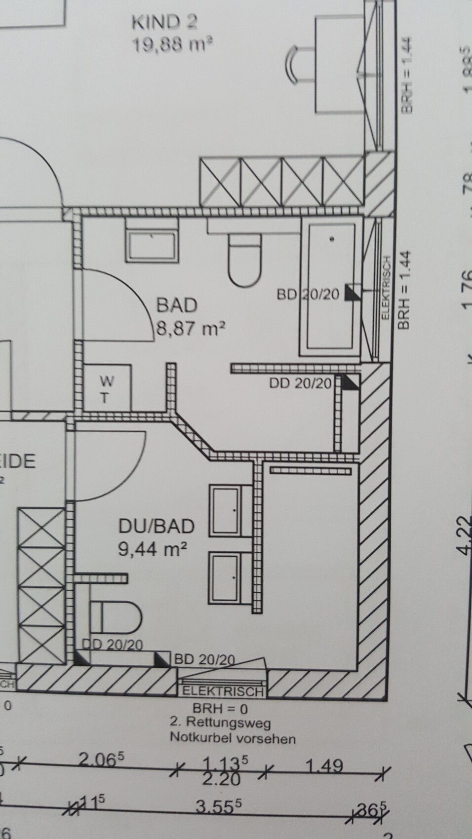

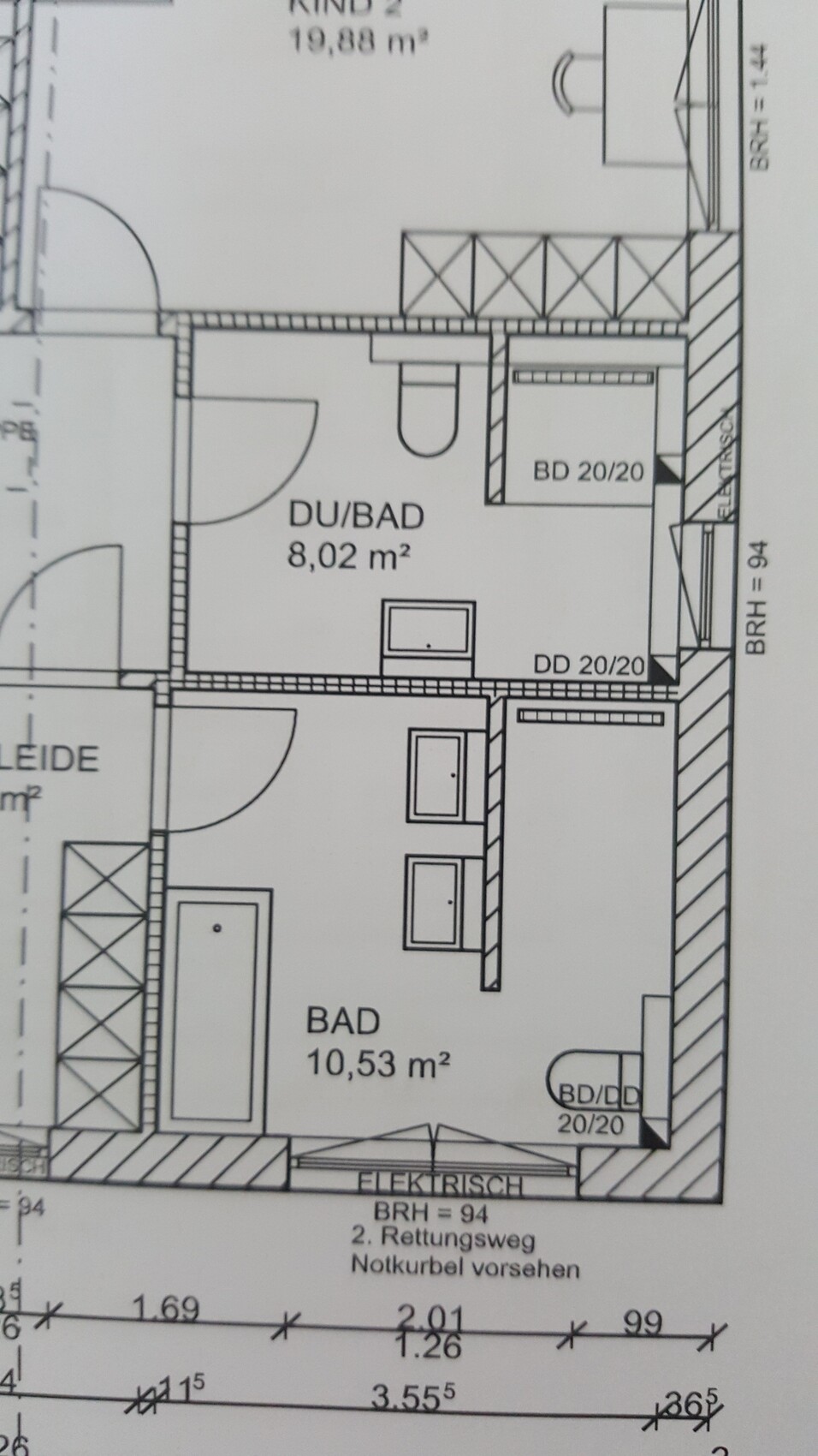

please help me. For days, I have been drawing various layouts, thinking I found a solution, only to discard it again. This is driving me crazy.
I want built-in walk-in showers in both bathrooms, completely without doors.
In the master bathroom, a small bathtub is planned, as well as a comfortably sized walk-in shower and, if possible, a double sink.
You will find the architect’s proposal attached.
I find the shower partition in the children’s bathroom not long enough, but it seems it cannot be made longer because of the window.
In the master bathroom, the toilet is too close to the shower entrance. Perhaps the shower wall could be shortened.
Do you have any ideas?
The two drawings are mine.
Windows are not fixed and can be changed freely.
The drawing with the washing machine + dryer is the children’s bathroom.
Thanks in advance!

I’ve now favored version 5. It’s similar to version 6, but the door doesn’t slide up as high. I don’t like the toilet bowl, sink, and bathtub placed so close together. The cabinet used in versions 6 and 7 seems to be available only in Switzerland. We’re now considering stacking the washing machine and dryer without a cabinet, or perhaps placing them in an open shelving system if we find one. Constantly opening and closing cabinet doors seems annoying when doing laundry. So version 5 should work well.

The architect drew it.
See the old and new versions.
Can someone tell me why the walls look different in the second version?

Ask him how big the bathtub is. I guess it is still 1.70m long (5 feet 7 inches). This needs to be considered for the building design, as the position of the shower screen and therefore the wall to the master bathroom depend on it.
I assume he built the walls as drywall, which would result in a different hatch pattern.
matte1987 schrieb:
Ask him how large the bathtub is. I assume it is still 1.70 meters long (5 feet 7 inches). This needs to fit the building design, as the position of the shower screen and consequently the wall to the master bathroom depends on it.
I assume he used drywall construction for the walls, which results in a different hatch pattern.The bathtub was measured again and is now 1.8 meters long (5 feet 11 inches).
What do you think about the niche depth of 0.6 meters (2 feet)?
Privacy screen 0.7 meters (2 feet 3 inches). Is that sufficient?
