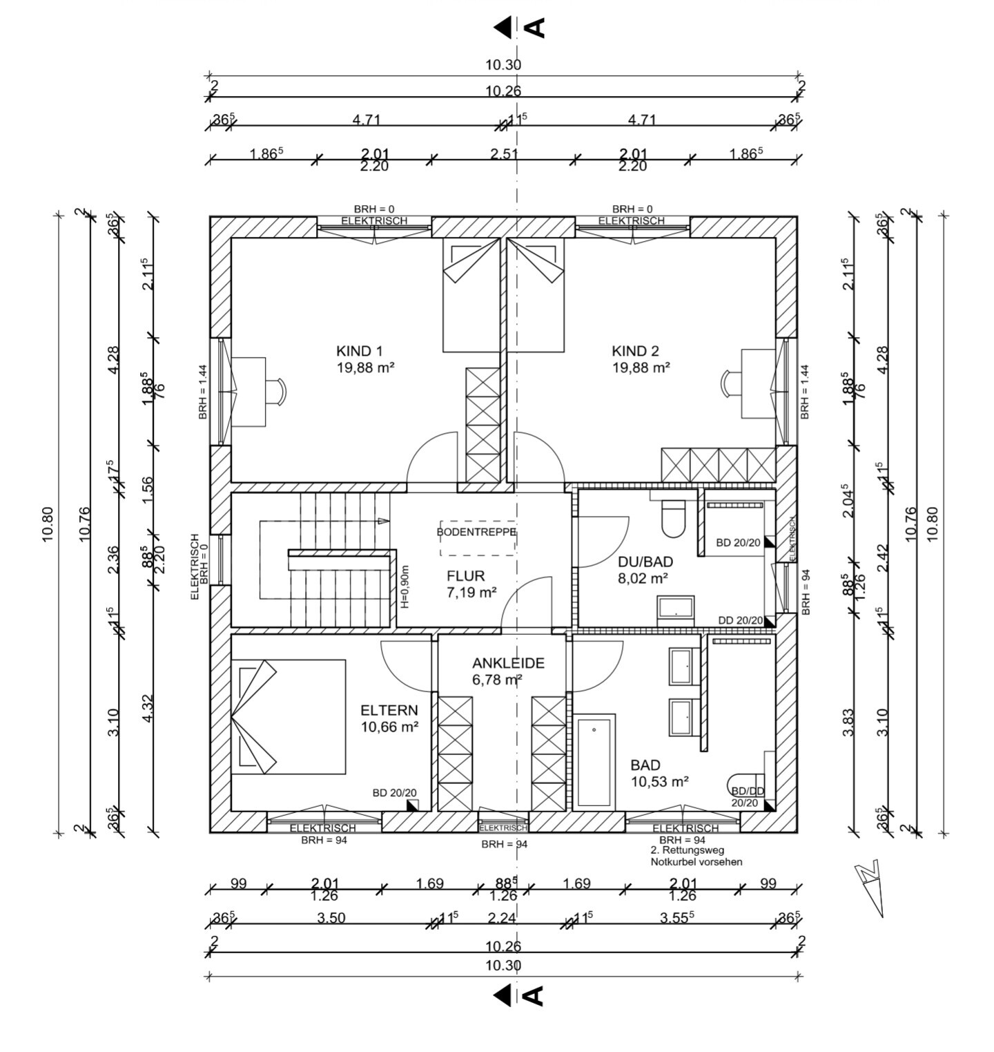

please help me. For days, I have been drawing various layouts, thinking I found a solution, only to discard it again. This is driving me crazy.
I want built-in walk-in showers in both bathrooms, completely without doors.
In the master bathroom, a small bathtub is planned, as well as a comfortably sized walk-in shower and, if possible, a double sink.
You will find the architect’s proposal attached.
I find the shower partition in the children’s bathroom not long enough, but it seems it cannot be made longer because of the window.
In the master bathroom, the toilet is too close to the shower entrance. Perhaps the shower wall could be shortened.
Do you have any ideas?
The two drawings are mine.
Windows are not fixed and can be changed freely.
The drawing with the washing machine + dryer is the children’s bathroom.
Thanks in advance!

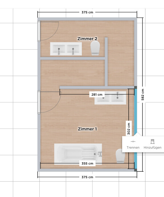

Oh, then rotate it:
[ATTACH alt="Bad.jpg"]43652[/ATTACH]
Edit: I had also shown a similar matte like that before.

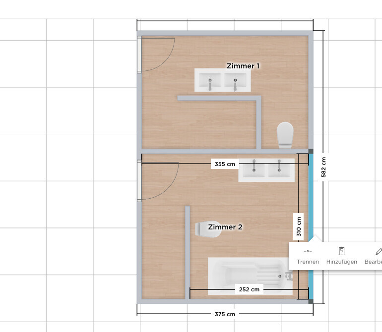

How long is the T-bar? How long is the wall next to the shower and the toilet?
3 Mar 2020 17:54
How long does the wall between the walk-in closet and bathroom need to be? Also: where would the door to the master bathroom be located?

For static doors, that could still be an option:
Personally, the bathroom seems either too small or too large to me... no matter how you arrange it. The bathtub is 180 cm (71 inches) long.

The wall in the walk-in closet should be 2 meters (6.5 feet) up to the door, so we can at least fit a 2-meter (6.5-foot) wardrobe. Otherwise, the room doesn’t really deserve to be called a walk-in closet.
Here is the upper floor plan. Does this give you any further ideas?
