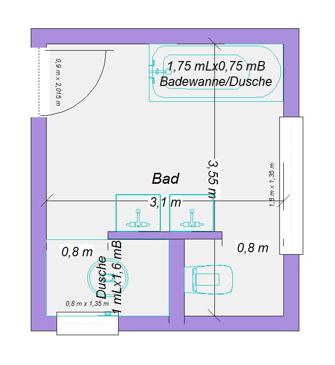

please help me. For days, I have been drawing various layouts, thinking I found a solution, only to discard it again. This is driving me crazy.
I want built-in walk-in showers in both bathrooms, completely without doors.
In the master bathroom, a small bathtub is planned, as well as a comfortably sized walk-in shower and, if possible, a double sink.
You will find the architect’s proposal attached.

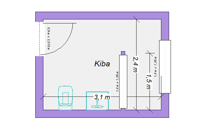

I find the shower partition in the children’s bathroom not long enough, but it seems it cannot be made longer because of the window.
In the master bathroom, the toilet is too close to the shower entrance. Perhaps the shower wall could be shortened.
Do you have any ideas?

kaho6743 Mar 2020 15:33
Shiny86 schrieb:
Could you please make a suggestion for me?
Floor plan of a bathroom with bathtub/shower, double washbasin, and toilet.
Children’s bathroom with masonry walls on the lower part, glass above:
Floor plan of a room named Kiba with purple walls, door on the left, blue furniture, and dimensions.

Thanks, but the dimensions are actually the other way around in the master bathroom. I must have written them incorrectly. You should swap 3.1 m and 3.55 m (10.2 ft and 11.65 ft). But then it would be quite tight between the sink and the bathtub, wouldn't it?

How flexible are the window positions? Especially in the main bathroom, the placement of the window and the door basically restricts the shower to the upper right corner of the room. The lower left and right corners are both blocked by the window.
Is the window location determined by an identical window on the ground floor?

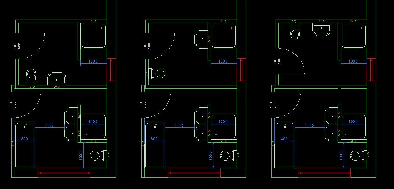

Here are three quick ideas for the kids' bathroom. I’ve kept the main bathroom layout the same because I kind of like it as it is.
Drei Badezimmer-Grundrisse als Linienplan in Grün auf schwarzem Hintergrund.

The children's bathroom is also about 3.5 meters (11.5 feet) wide instead of 3.1 meters (10.2 feet). Wouldn't the window be a problem when showering there?
Is it possible to make the wall 1.6 meters (5.2 feet) long? That would create an entrance 80 cm (31.5 inches) wide – or is that too narrow? How wide should an entrance be at minimum?
