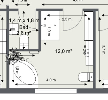

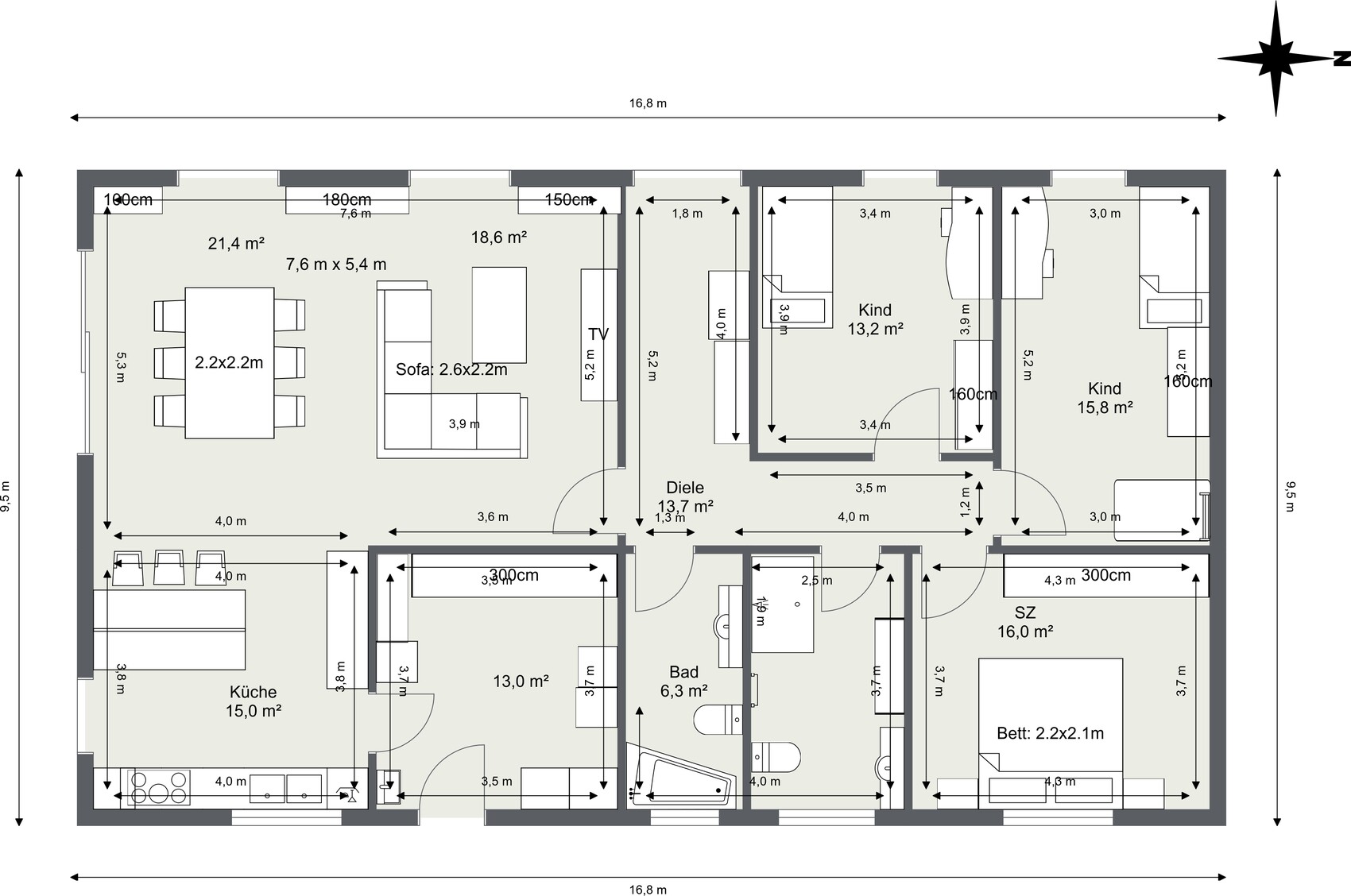

some of you may have followed the planning thread. Since we don’t want the guest toilet to be a walkthrough to the utility room, nor place an unused circulation space between the utility room and the guest toilet, we will access the utility room in the traditional way through the kitchen or net floor area.
This provides a bit more space for the bathroom layout, but it’s not entirely clear how it can be best used. We initially planned the guest toilet rather simply and minimally as an internal bathroom. Now we are considering using the space to plan the guest toilet as a separate children’s bathroom.
The rough dimensions of the children’s bathroom would be 1.70 m (5 feet 7 inches) wide—as it is currently in our apartment—and the master bathroom would be 2.20 m (7 feet 3 inches) wide (you can compare this room width to Horbach’s sample bathroom Samoa). Both rooms would be 3.70 m (12 feet 2 inches) long.
The children’s bathroom will have a space-saving bathtub installed “slightly angled,” while the master bathroom will feature only a walk-in shower.
Would this concept be feasible?

The idea of a separate kids’ bathroom came from saving walking distance by changing the utility room’s entrance, which would create a niche in the larger bathroom. (see attachment)
Your idea isn’t bad, but I don’t know where I could place the washing machine in the kids’ bathroom. I’m sure you already have some ideas for that.

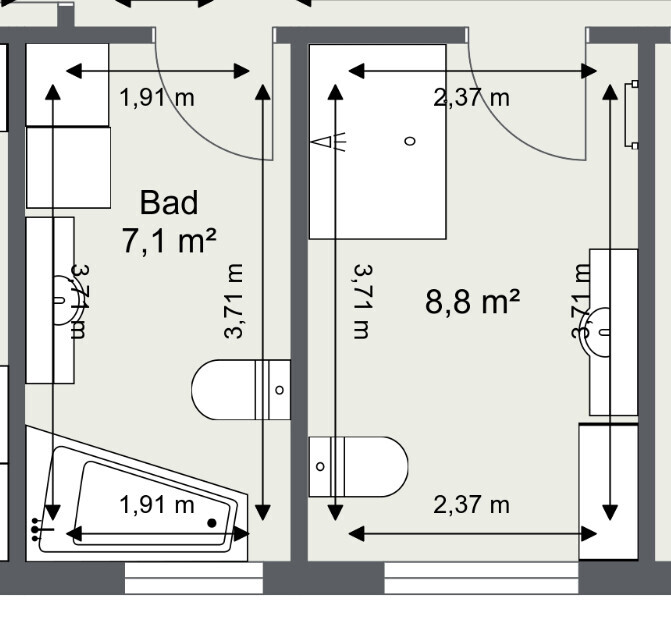

6 Dec 2019 13:53
I quickly put your idea into practice. It definitely still needs some optimization, but I like the basic concept.
Floor plan of two rooms: left bathroom 7.1 m² (76.4 sq ft) with sink and toilet; right 8.8 m² (94.7 sq ft).
