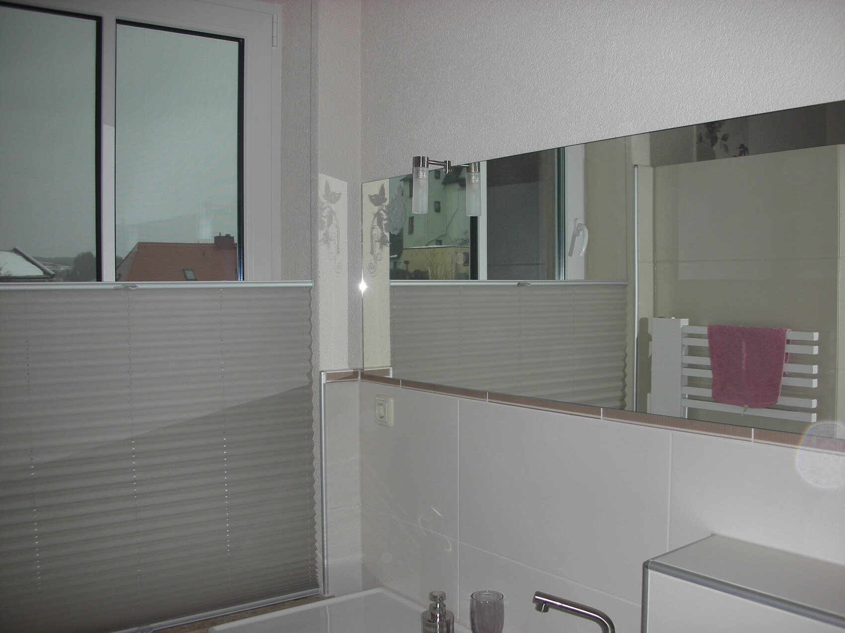

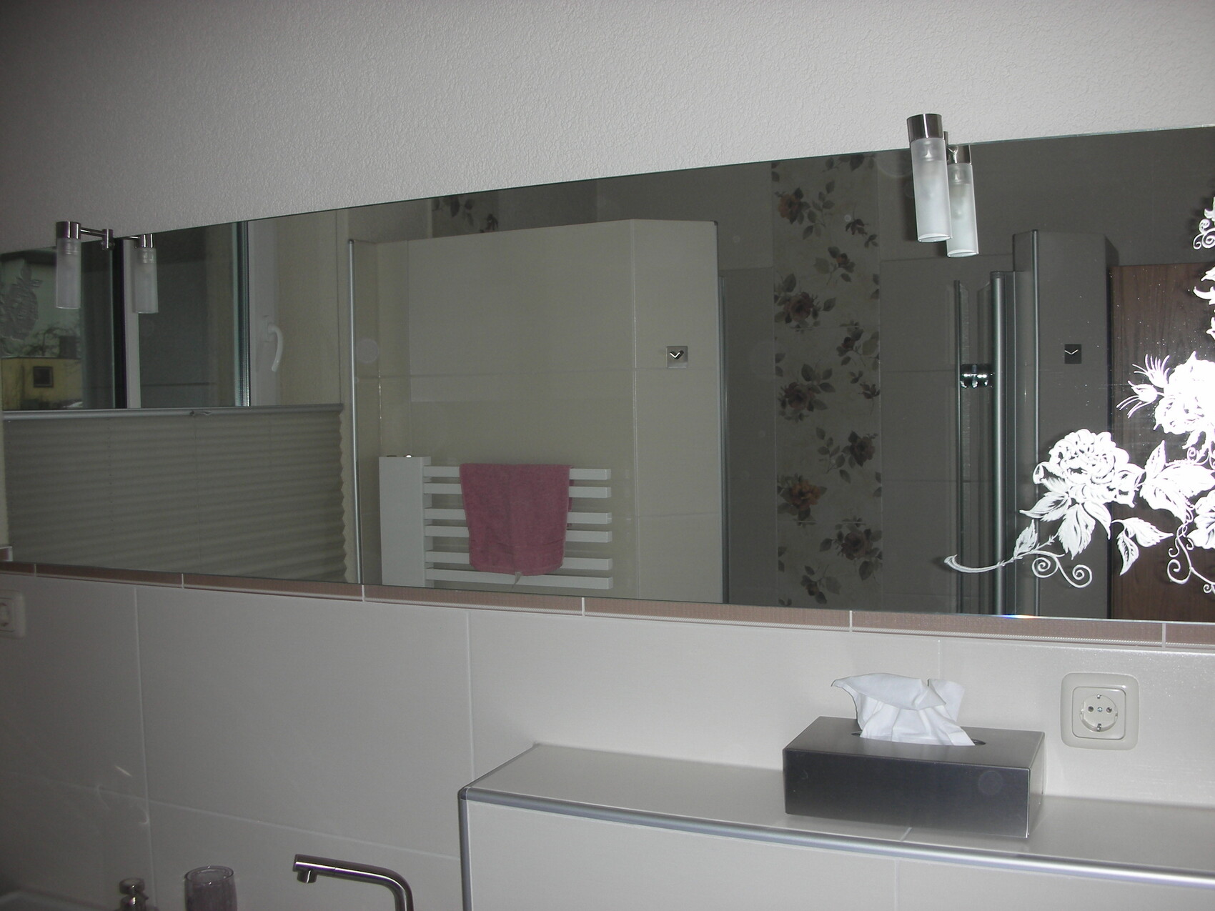

My shower partition walls are also about 210 cm (83 inches) high. However, they are fully tiled all around, including on top.
It is important to consider at which heights full tiles should start and at which heights, for example, around sinks, the tiling should continue. I like continuous grout lines and also appreciate that in my tiling, for instance, it started below the window with the large tiles extending outwards from the center to the right and left.
My bathroom is only 4.2 square meters (45 square feet) in size, so it is difficult to photograph.
willWohnen schrieb:
So that the bathrooms are tiled “all the way up,” that’s what we wanted,Yes, then just tile all the way up
@kbt09 nice mirror wall
