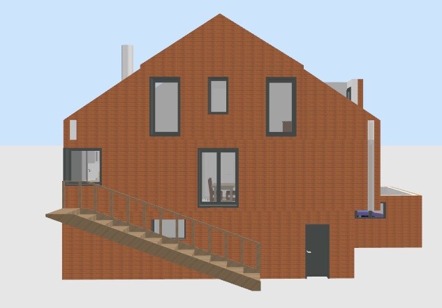

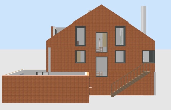

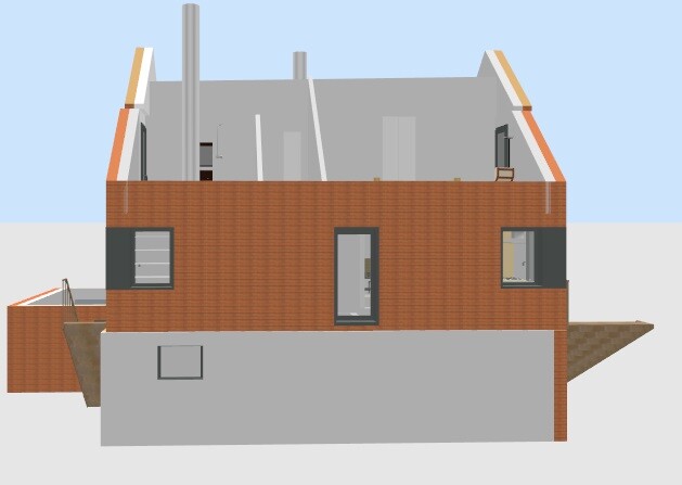

Here are the revised elevations from me. As mentioned, the floor-to-ceiling windows on the ground floor will not be doors but will have a fixed panel at the bottom. You have to imagine the terrain a bit, but I think the exterior stairs roughly illustrate the slope. The stairs will, of course, be built with masonry or paved or done in some other way... We will take care of the garden landscaping a bit later.
