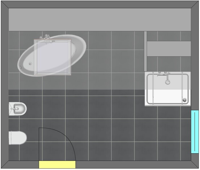

It is drawn in mirror image. When I enter, the shower is on the left and the bathtub on the right. The shower includes a built-in bench, with a glass panel in front and a glass door on the side as a partition – this makes it feel much lighter. The shower exit does not face the bathroom door but toward the window. The bathtub is partially surrounded by a shelf surface, but it is not bulky.

It is drawn as a mirror image. When you enter the bathroom, the shower is on the left and the bathtub on the right. The shower includes a built-in bench and is separated by a glass panel at the front and a glass door on the side – this feels much lighter. The shower exit does not lead toward the bathroom door but in the direction of the window. The bathtub is partly surrounded by a shelf area, but not in a bulky way. I think your idea is not bad. We just don’t want the toilets near the window. With 65cm (26 inches) depth, I can’t manage it even by shifting things around in the bathroom because it's narrower than the children’s rooms. Unless I reduce the window size, which we want to avoid. Also, I find the wall next to the window perfect for a large vanity with bathroom cabinets for storage and so on. That wall is made for this!!!

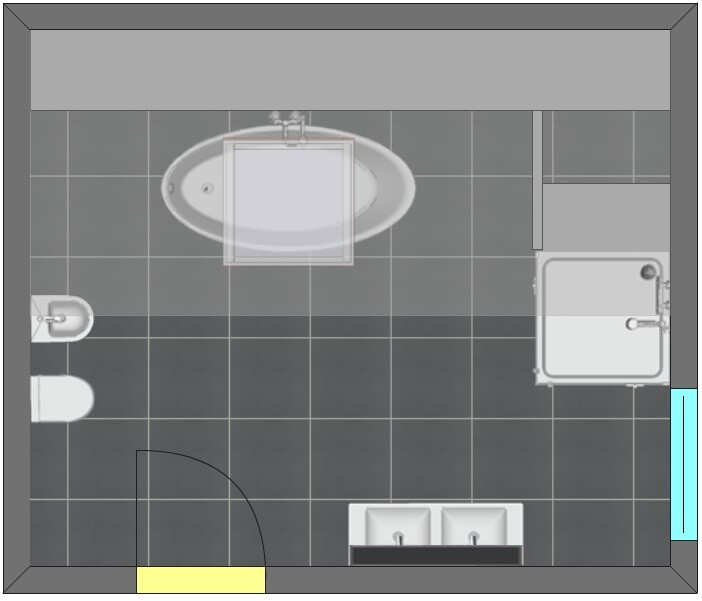

Maybe this version?

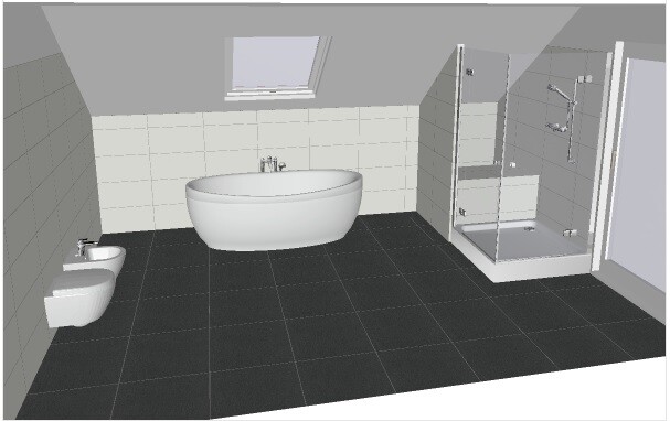

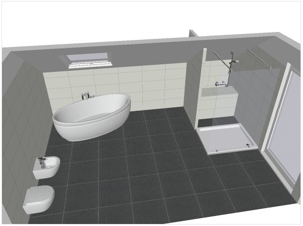

I can’t represent the shower perfectly in this program, of course it will be fully tiled to floor level, and the glass panel at the window side will be fixed, with the door swinging inward. I’ve planned a bench seat there as well. Behind the bathtub there is a partition wall built up to 1.30m (4 ft 3 in) height, so you can place shelves on or next to it. The bathtub itself would be freestanding, and on the right side of the tub along the exterior wall is the laundry chute. I would then place a towel warmer on the wall next to the shower entrance, but unfortunately the program doesn’t show that.
Take a look—I’ve now planned the shower like VillaMoTo, but only on the window side. The fixture will, of course, be installed on the exterior wall, and the floor will be tiled flush. I think it looks pretty good. However, is a layout with a fixed glass panel of 1.20 meters (4 feet) and a 90 cm (3 feet) glass door standard for a shower? Also, is positioning the toilet and bidet behind the door acceptable? That way, no partition wall is needed. The distance between the door and the wall is about 80 cm (31.5 inches). Is that enough depth for a toilet, or are there any standard dimensions I should be aware of?
