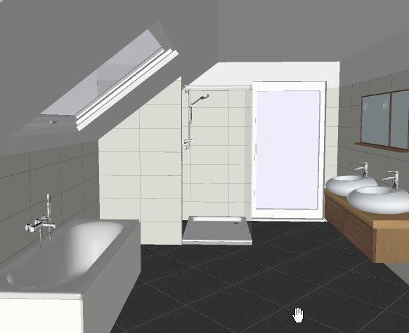

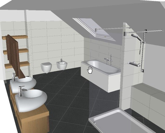

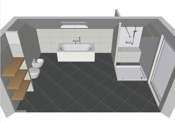

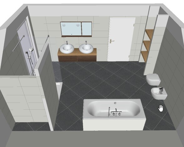

So, here is hopefully the final version. I really like it. I hope my husband will tonight as well, and that our plumber considers it feasible.

Kisska8631 Mar 2014 14:03
Thank you for the great pictures. I have saved them all right away as inspiration. That’s exactly how I have planned it now. The bathtub is rectangular on the outside, so it can be tiled neatly all around with floor tiles, and inside it is nicely oval... Oh, I can really imagine it looking very stylish now!!! *excited*
31 Mar 2014 15:03
I like the bathroom as well.
I haven’t read everything in detail... but where do you get out of the shower? It’s not ideal near the window, unless you put permanent blinds there. Still, your silhouette might be visible from the outside.
Consider installing a towel rack on the side. I would make the shelf behind the door a bit deeper so you can stack towels easily. The platforms on both sides of the bathtub could also be made deeper if you prefer.
