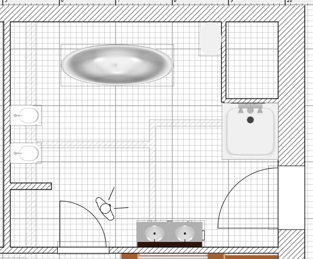

Kisska8629 Mar 2014 20:58
What do you think about this layout option?
Floor plan of a bathroom: bathtub, shower, double washbasin, toilets, and doors.

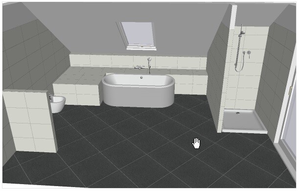

Kisska8630 Mar 2014 21:22

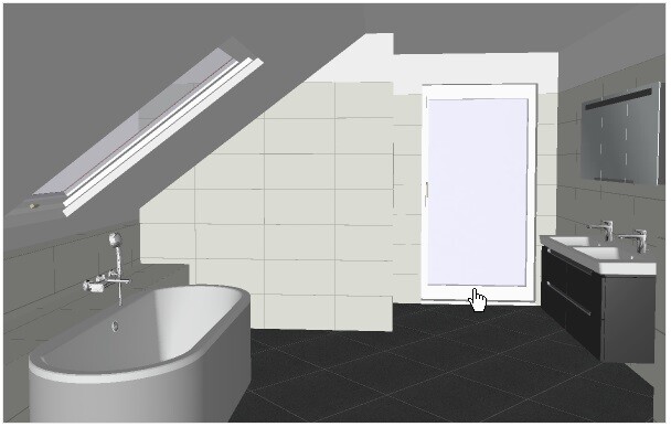

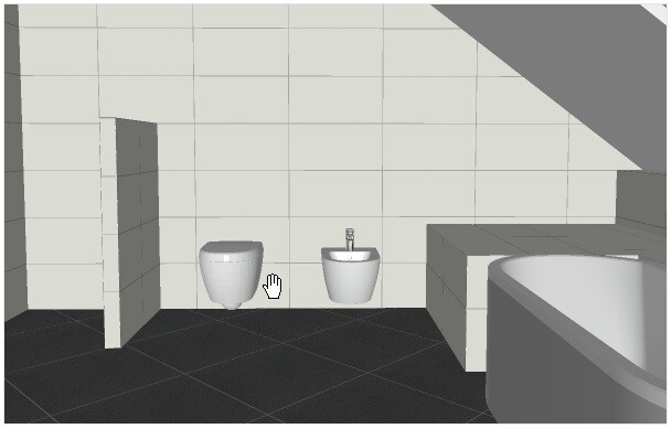

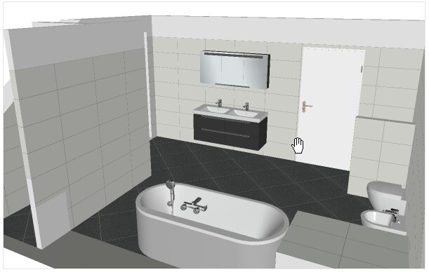

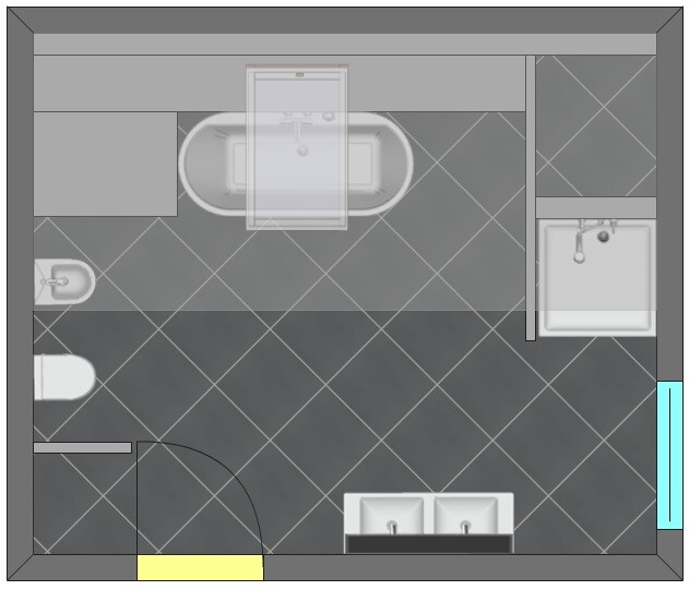

So, I’ve finally made some progress in the 3D planner...
What do you think? Is this better than the other version? Any other suggestions?
Floor plan of a bathroom: bathtub, two sinks, toilet, door.
Modern bathroom: bathtub on the left, sink with mirror on the right, door in the middle, skylight on the left.
3D bathroom with freestanding bathtub, double sink, toilet, bidet, shower.

VillaMoTo30 Mar 2014 21:27
Hmm, what I personally don’t like is the large built-in wall area to the left of the bathtub and the wall in front of the toilet. Also, I would make better use of the knee wall in the shower and have a bench built in. The fixtures can also be mounted on one of the side walls.
30 Mar 2014 22:01
Is the shower located under the sloped ceiling? Under 2 meters (6.5 feet)? That would be unfortunate and hopefully not how the professional builds it.
Having the shower exit in front of a window is also not ideal...
The privacy panel on the left won’t help you at all and could be removed.
