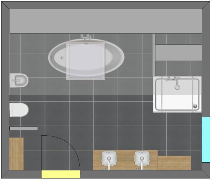

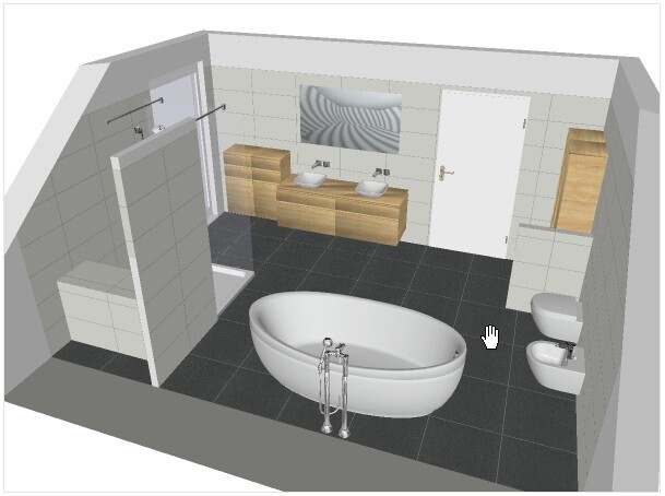

So, a toilet is about 55 cm deep (22 inches). If the wall needs to be built out further, you should add that to the measurement.
I’m not sure about the standards for glass walls, but it is definitely feasible.
An alternative you might consider is using the entire left wall for the washbasin and wall cabinets, and placing the toilet and bidet on the right by the window—that is, swapping their positions. In this case, you could also think about changing the door swing. Then, the toilet wouldn’t be visible immediately when entering.
@milkie: I agree! I’ve just added some furniture and now I’m wondering if I should still have a wall built in front of the toilet or not?
@VillaMoTo: No, I don’t think swapping them is a good idea. If the shower stays against the wall like it is now, then I can’t move the window, which we don’t really want anyway. And in that case, the toilet would be right in front of the window... Even with structural glass on a floor-to-ceiling window, it’s not ideal. Also, having the sink away from the light isn’t great either. But it was worth considering. Thanks!
Take a look, this version should work well, right?! Now the question is whether the small wall in front of the toilet adds anything or just feels awkward???
