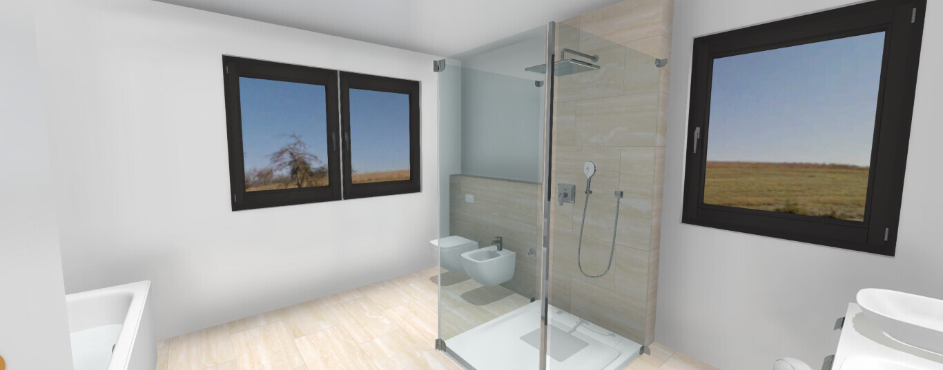

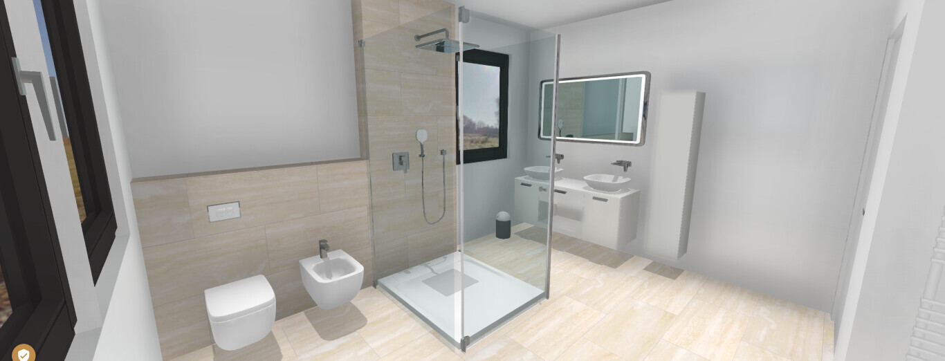

Thank you very much already for the many great comments! I have to leave soon but will respond to your posts individually by this evening at the latest. In the meantime, I quickly created number 3 in 3D; more on that later.
Good luck,
Hausbaufaehig
Modern bathroom with glass shower, toilet, bidet, and double washbasin in front of mirror.
Modern bathroom with glass shower, toilet, bidet, washbasin, and two dark window fronts.

Hausbaufaehig schrieb:
I quickly recreated the design from #4 in the planner, it looks quite okay:
This only works if the bathroom is always intended to be used by one person at a time. Otherwise, someone is sitting on the toilet while being showered from behind.
I also don’t understand why anyone would want to place a shower, which requires frequent cleaning, in the middle of the room.
Because of the two windows, the solution that you didn’t want would be my favorite.
So, three with the T-layout.
