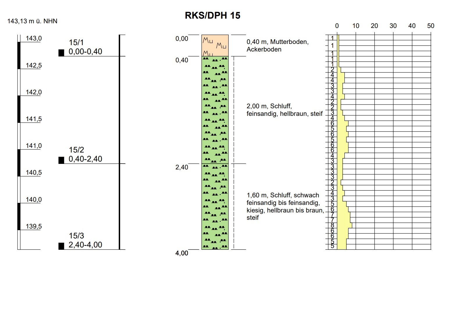

The soil survey for the plot itself is not yet available (-> commissioned), but there are surveys for the entire new development area, including dynamic cone penetration tests conducted almost directly next to the plot. (See attached file)

3. For neighboring plots, earthworks have already been planned requiring backfilling with gravel or similar material if no basement is built. Can it be determined from the attached file that this will no longer be necessary when building a basement, since the foundation reaches close to firmer soil?

"6.2.6 General assessment of moisture protection According to DIN 18533 and the execution guidelines of the German Committee for Reinforced Concrete (DAfStB Guideline for Waterproof Concrete Structures), the load case of soil moisture and non-pressing water may only be applied if the permeability coefficient for the soil is assumed to be kf 10^-4 m/s. For the clayey soils likely present at the working slab level, it is expected that this requirement will mostly not be met. Therefore, the following options are considered for moisture protection: 1. External waterproofing according to DIN 18533 assuming water exposure class W2.1-E (moderate exposure to pressing water) 2. Execution of all earth-contacting structural parts according to the DAfStB guideline for waterproof concrete structures. Design is based on stress class 1, which covers pressing water, non-pressing water, and temporarily rising water. All construction joints and penetrations must be made watertight with coordinated systems (joint tapes, joint sheets, injection hoses, etc.)."
Construction drawing with soil profile, depth indications, topsoil and foundation

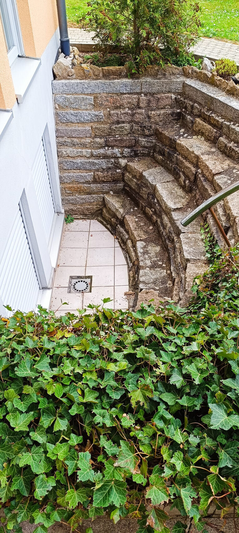

Here is a picture of the foundation slab with drainage.
Stone steps forming a semicircular staircase next to the house, surrounded by ivy.
