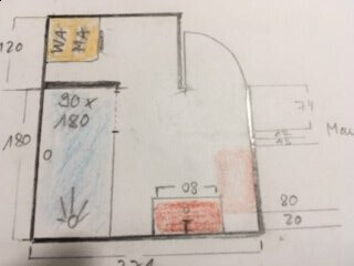

I am currently planning the bathroom (here, it’s called "badkamer"). Unfortunately, the bathroom has a difficult layout. There is a niche measuring 160cm (63 inches) in length and about 100cm (39 inches) in width. Would it be possible to install a walk-in shower there without flooding the bathroom when in use? 160cm (63 inches) in length seems quite short to me, as there would only be a glass partition of 110cm (43 inches). The shower entrance would be on the long side.
Or does anyone have other ideas for this bathroom? It should include a shower and one or two basins. Additionally, a radiator and possibly a cabinet for storage are needed.

That said, I am definitely a supporter of shower doors, and a 160cm (63 inches) niche is sufficient if you plan for a 70cm (28 inches) door that opens inward into the shower (hinged on the right wall). You can initially leave the door out to test whether splashing will be an issue. If it is, you can get a door and install it in the shower.

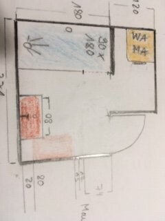

Bertram10025 Jan 2020 10:12So, I have reviewed everything again (including the finances) and moving the door is not an option. Therefore, the floor plan will stay as it is. The reasons why it ended up like this are:
- Moving the door is too expensive for me. The floor plan stays as it is.
- I need space for the drying rack (laundry frequency of 1–2 adults). I don’t want to have laundry drying in my own bedroom, nor in the co-houser’s bedroom, nor downstairs in the living room/office. Drying laundry in the bathroom works well because of the automatic ventilation for wet rooms.
- A shower measuring 160cm by 90cm (63 inches by 35 inches) results in a shower screen of about 110cm (43 inches). Apparently, this is too short to serve as an effective splash guard. I would need a door or a small extra panel on the shower screen. I prefer not to do that. I would rather have just a simple wall/glass wall.
- I don’t like double washbasins. It won’t be that intimate with the co-houser that we would be in the bathroom together.
For these reasons, the bathroom has now been arranged like this. Just behind the entrance, a small wall can slightly interrupt the perceived line of sight to the washbasin.
The wall separating the shower from the washing machine will be 120cm (47 inches) high and tiled with the same tiles as in the shower. I believe 120cm (47 inches) is enough to prevent much splashing and tall enough to visually conceal the washing machine with its accessories.
Unfortunately, the photo rotates automatically and appears here rotated by 90° compared to the floor plan shown above.
Thanks for your tips!
