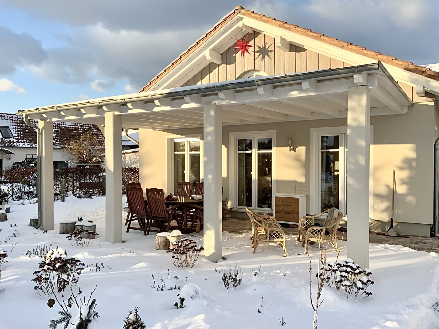

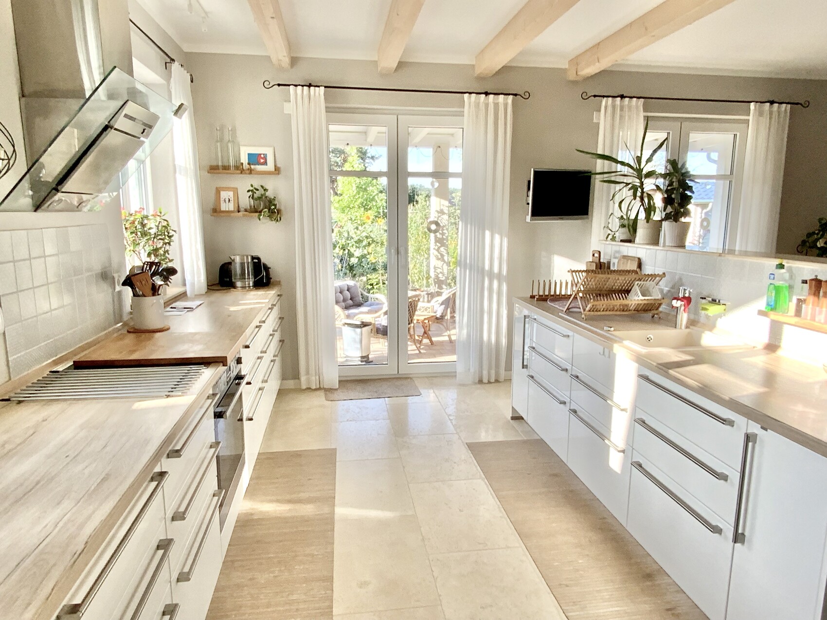

We have a covered south-facing terrace measuring 8 meters (26 feet) wide and 4 meters (13 feet) deep. The clear height at the front columns is 2.65 meters (8 feet 8 inches). We feel much more comfortable with this canopy than we did before without it. The rooms are definitely bright enough—no one has ever complained that it is too dark. In winter, the sun is low enough to shine deep into the room. In summer, the effect is naturally even more pronounced. We have even removed our blinds because they are simply no longer necessary. Whether you want the balcony is up to you. Here are a few impressions of the lighting conditions…

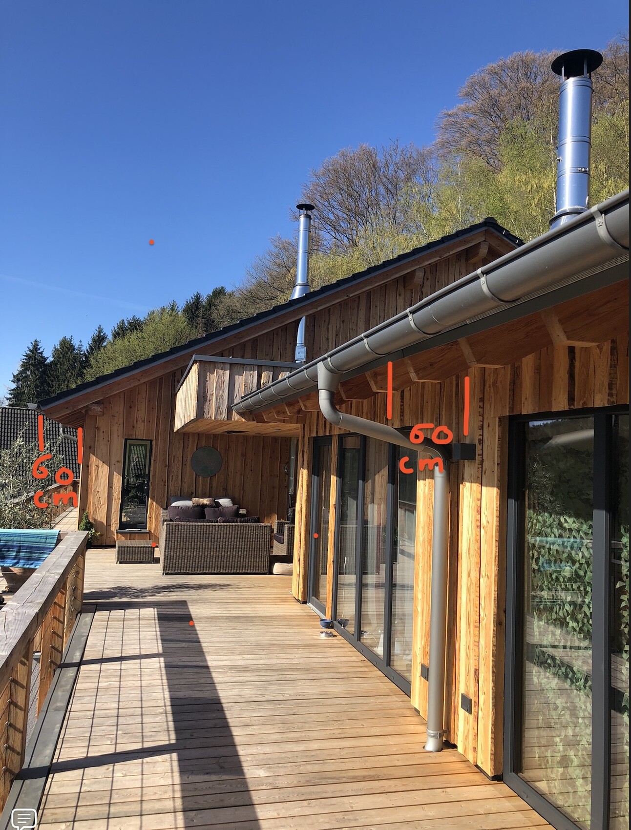

Our architect designed the height and depth of the overhang so that at the highest sun position no sunlight enters through the window, and at the lowest sun position the sunlight reaches across the room to the opposite wall. I think that’s great. In the photo, I have marked the overhangs of 60cm (24 inches) each. Our room is at the "back." In the center, there is a seating area with a correspondingly larger overhang. The children’s apartments have a wider balcony terrace but still the 60cm (24 inches) overhang. The 60cm (24 inches) works only with the correct height proportions.
The photo was taken on April 11, 2020, at 10:45 a.m. — so at a “medium” sun position.
