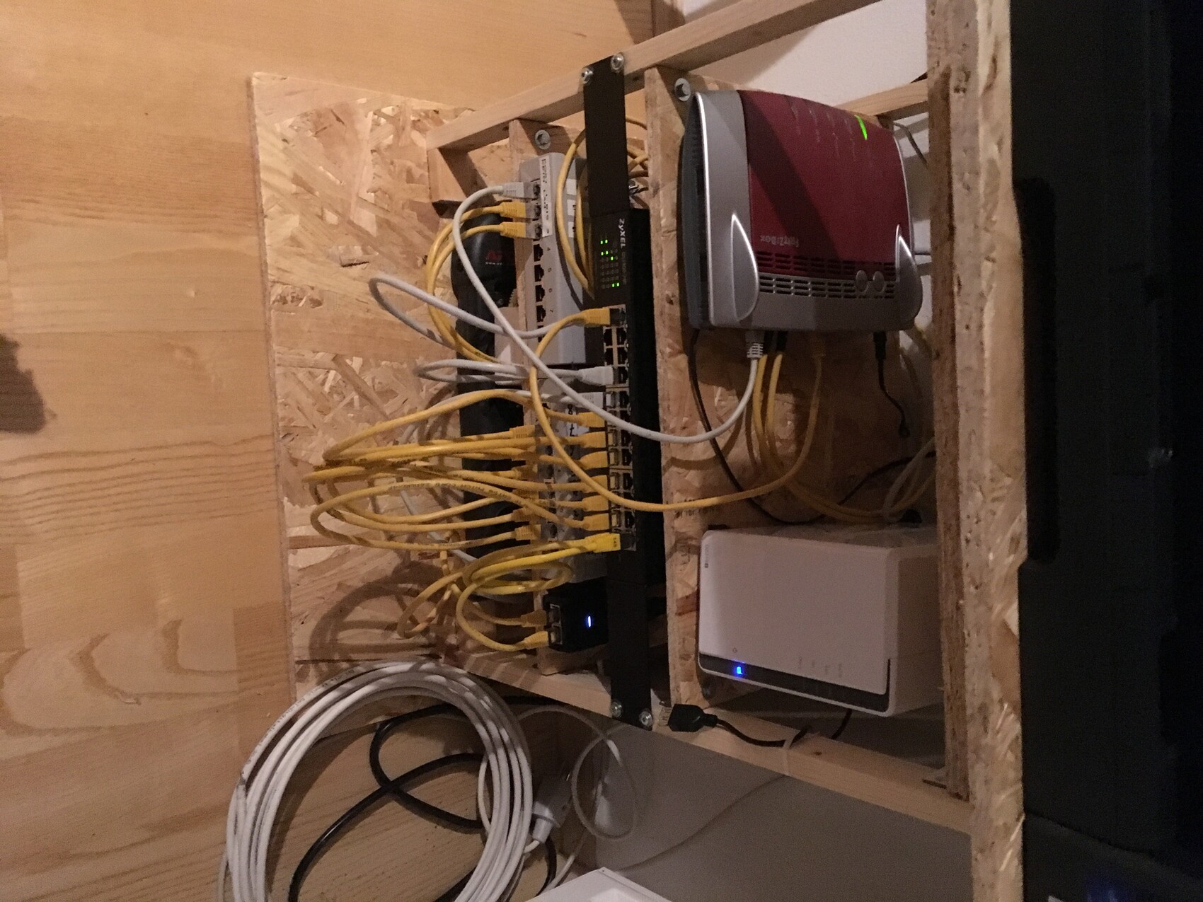

Just out of curiosity: how many Ethernet outlets do you have at home? Both of us work from home, and we have exactly eight wired network devices throughout the house, including IP phones and two access points. If our child gets a laptop someday, that will add one more device...For me, it’s: NAS, access point, CCU2, 2x Raspberry Pi, TV, PC, network printer. I have a few more outlets than devices. Since I have to install everything surface-mounted, I only set up what I need.
Attached is a picture of my switch. The patch panels are already 10 years old. I started with just 8 ports. I need to organize the patch cables to make them shorter. Everything is currently mounted in a wooden frame. A proper network cabinet is definitely recommended, but I haven’t found a suitable one for myself, so I built my own.
