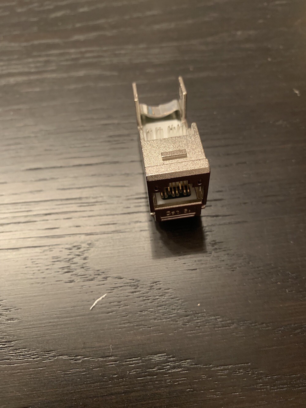

The Keystone module is like a small socket where the patch cable is plugged in. It is also used in larger patch panels, allowing it to be easily moved to a different panel or location without having to remove and re-terminate the permanent cabling.
Since the module is quite small, you can simply cover the hole in the ceiling with the access point.

I can also take some pictures for you. I currently have a (partial) complete system here for a friend’s new build.
