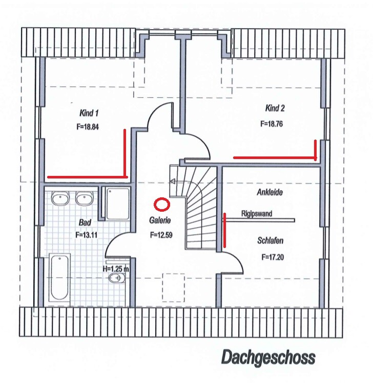

SenorRaul718 Feb 2019 11:01Okay, this is getting quite specific now...
I took the floor plans and started thinking about where electronic devices with wired LAN connections could be placed. On the ground floor, we are already quite far along with the furniture planning, but on the upper floor, we’re still uncertain. The drywall partition in the bedroom will probably be removed because otherwise the bedroom would be too small due to the sloping roof.
The two circles in the hallway areas could be two ceiling-mounted access points.
The lines on the walls could indicate walls where wired internet is needed.
The connections themselves, including the router, should of course be located in the utility room.
Ground floor:
Hallway = Access point
Living room = TV, receiver, game console...
Guest/office room = PC, game console, possibly also TV/receiver
Upper floor:
Children’s room = eventual TV, receiver, game console, PC
Bedroom = TV/receiver
