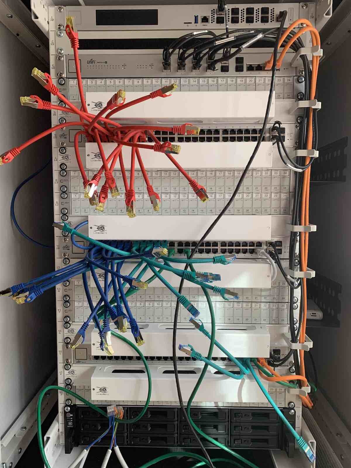

All connections from the rooms run to the patch panel, and from there you connect to your switch. This setup looks neat and organized, especially if you install it nicely in a 19" cabinet. There are also smaller cabinets for wall mounting, or you can build your own.
Anything that can be connected to LAN and is not mobile (like laptops, smartphones) can easily be connected to the LAN. The general rule of thumb: one double outlet per room (plus possibly a ceiling outlet for an access point) is a good starting point for future-proofing. You never know how a room might be used later. Whether you absolutely need a LAN connection in rooms like the kitchen or bathroom depends on what you want to connect there. In these areas, Wi-Fi might be sufficient. But if you need permanently installed touch panels for smart home applications, that would be a different matter. So far, I haven’t read anything about that here...
Alternatively, you could have just the cable (without an outlet socket) installed in the room to be on the safe side.
1 double outlet = 2 ports.
Sockets are quite affordable from brands like Keystone or Rutenbeck. Check suppliers like Kabelscheune, for example.
The CAT standard for sockets is CAT6a, and for cables, it’s CAT7. This is currently the highest and best standard. Sockets can be easily replaced later.
