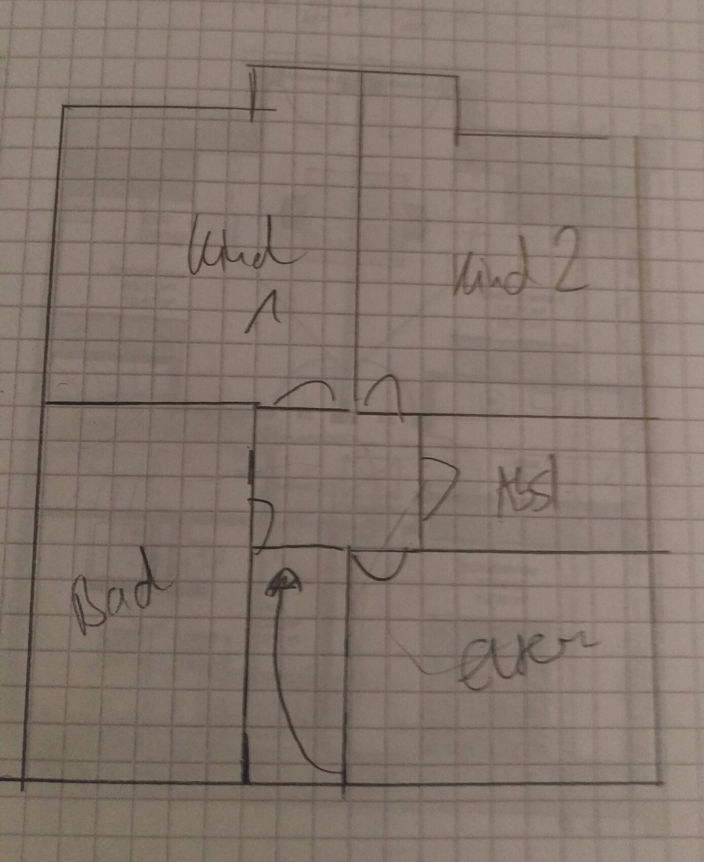

Ev-Marie8618 May 2017 21:14Now the staircase has been shifted...
E
Ev-Marie8618 May 2017 21:17Ev-Marie86 schrieb:
A walk-in closet is not for me... everything just gathers dust there. How would anything gather dust there?
Ev-Marie86 schrieb:
Just wanted to show that I’m flexible. Good. That’s encouraging. Things are moving forward. Unfortunately, the bedroom layout doesn’t work: even without space for a wardrobe, the bed doesn’t fit well (with sufficient headroom). And the staircase is too small; you can find a post with staircase dimensions at the top of this section.
Ev-Marie86 schrieb:
Unfortunately, I can’t draw But you can print and cut out, paying attention to scale, right?
E
Ev-Marie8618 May 2017 21:40I had lengths of 113.5 and 345 cm (45 inches and 136 inches)... that’s what my plan allows... and the bed in the bedroom fits under the sloped ceiling, right??
Regarding the staircase at the entrance, I just realized that people might walk in socks from the living room through the potentially somewhat dirty entrance area into the bedrooms. This should be taken into account if the staircase is located directly at the front door.
Ev-Marie86 schrieb:
I had lengths of 113.5 and 345 cm (45 inches and 11 ft 4 in) ... that’s what my plan shows.. This width might roughly match on the upper floor; on the ground floor, you start the stairs at about 75 cm (30 inches) wide.
Ev-Marie86 schrieb:
and the bed in the bedroom fits under the sloped ceiling, right?? The hidden knee wall reaches about 85 cm (33 inches) on the inside of the exterior wall, then about 15 cm (6 inches) further in is the 1-meter (3 ft 3 in) line. Even with low beds, you usually need to subtract at least 40 cm (16 inches)—often significantly more—to the top of the mattress, so there isn’t enough space to sit upright at the head of the bed; even standing up without hitting your head takes practice and concentration.
