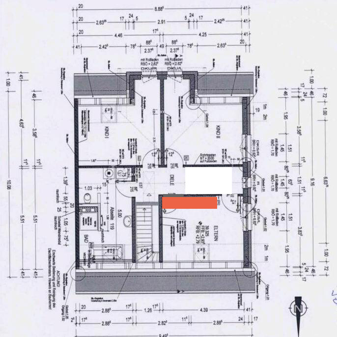

Either a wardrobe width of max. 270 cm (106 inches) will be enough, or the builder will have to be bothered again. It looks like the window with roller shutters is already at the absolute maximum height on the sloped ceiling. Nothing more can be done there.
If the 3 m (10 feet) wardrobe has to fit, the storage room could at most be sacrificed and the door relocated as a last resort. That would also have the added benefit of providing a window in the hallway.
E
Ev-Marie8618 Apr 2018 18:24Or a storage room used as a walk-in closet and no wardrobe in the bedroom. According to the structural analysis, windows can be moved a maximum of 7cm (3 inches) outward.
E
Ev-Marie8618 Apr 2018 19:38Or rather, shift the window by 7cm (3 inches) plus move the storage room wall by the remaining amount so that there is a 62.5cm (25 inches) wall left in the bedroom. The storage room does not have a load-bearing wall.
Ev-Marie86 schrieb:
Or use the storage room as a walk-in closet and have no wardrobe in the bedroom... According to the structural calculations, the windows can be moved outwards by a maximum of 7cm (3 inches)... I don’t see it that way. The windows also have roller shutters above them. I think everything is designed really tightly. The storage room is too narrow to be used as a walk-in closet, even if you extend the wall all the way to the window edge. Or what do you mean by that?
E
Ev-Marie8621 Apr 2018 17:42We will now, as approved by the structural engineer, move the window 7cm (3 inches) towards the eaves and then adjust the wall of the storage room so that we have 62.5cm (25 inches) in the "Parents" room. So everything is fine despite the late discovery... Nevertheless, I would like to sincerely thank all of you once again, including those from the very beginning, because none of this would have been possible without YOU here.
