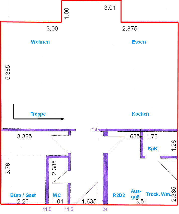

I attempted a radical simplification of the (ground floor) layout.
The red line shows the interior edge of the exterior wall as the frame within which everything is arranged: 8.885 x 9.385 meters (29.15 x 30.79 feet) plus 3.01 x 1.00 meters (9.88 x 3.28 feet). To keep the overall calculation consistent, I included one load-bearing wall per dimension, designed as 24 cm (9.5 inches) thick (though in the drawing, the wall toward the living area is only 11.5 cm (4.5 inches), while the supplier likely uses 17.5 cm (6.9 inches)).
The staircase position is only roughly indicated as an “L”-shaped stair, winding at the corner but mostly straight, with a short tread at the bottom and an exit near the center above the door to the living area. For the pantry, I’m considering a sliding door running inside the wall, without casing. In the guest room, I gave the option to place a bed sideways along the window wall. However, this means it would also have to serve as a clothes storage area, which I would have preferred to avoid. Since this is intended more as a discussion prompt than a detailed plan, I haven’t worked out all the minor details.

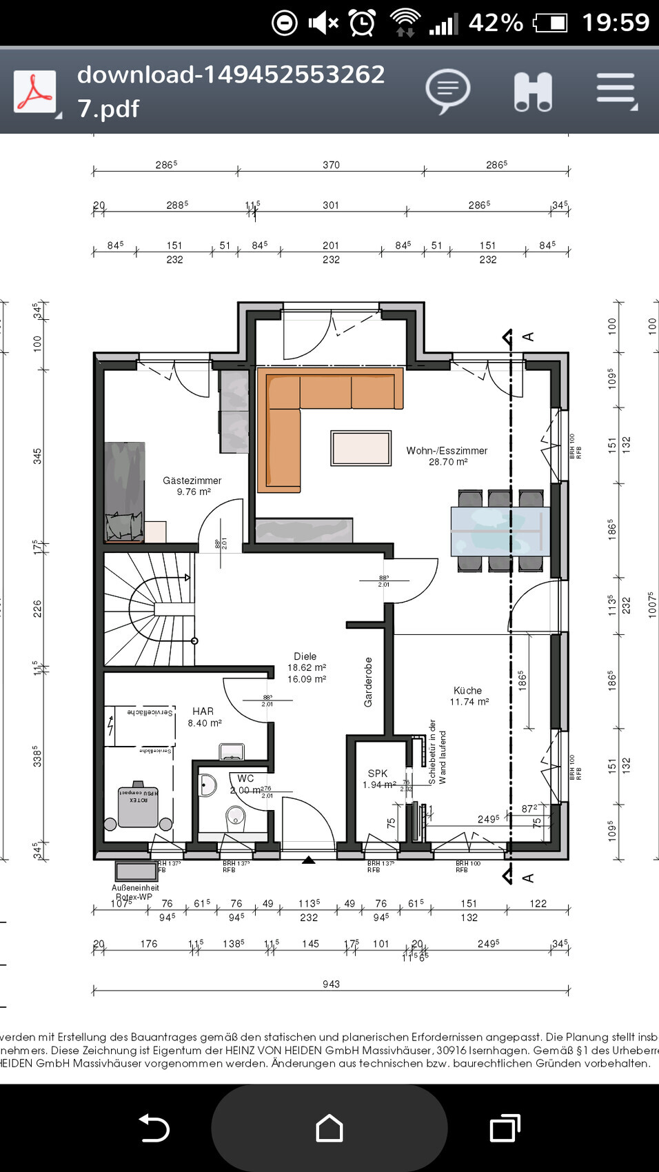

Ev-Marie8617 May 2017 21:09I actually think it’s pretty good... I just can’t imagine the furniture arrangement anymore... let alone how the staircase is laid out.. But I like it... except for the door to the pantry... that should come from the kitchen..
Ev-Marie86 schrieb:
I think it’s good... except for the access to the pantry... that should be from the kitchen..In your drawing, it looked like the entrance was planned from the utility room (to have a short route from groceries to the pantry, through the utility room’s exterior door). You had placed the pantry in an inset corner of the kitchen, which I initially intended to copy, but then I realized: it also works without that detour in the wall. This way, the open-plan area can be divided more flexibly.
Ev-Marie86 schrieb:
but now I can’t imagine the furniture arrangement at all...On the contrary: now the flow of all the furniture you can imagine is only limited by the bay window.
So: print it out, grab some scissors, and have fun!
E

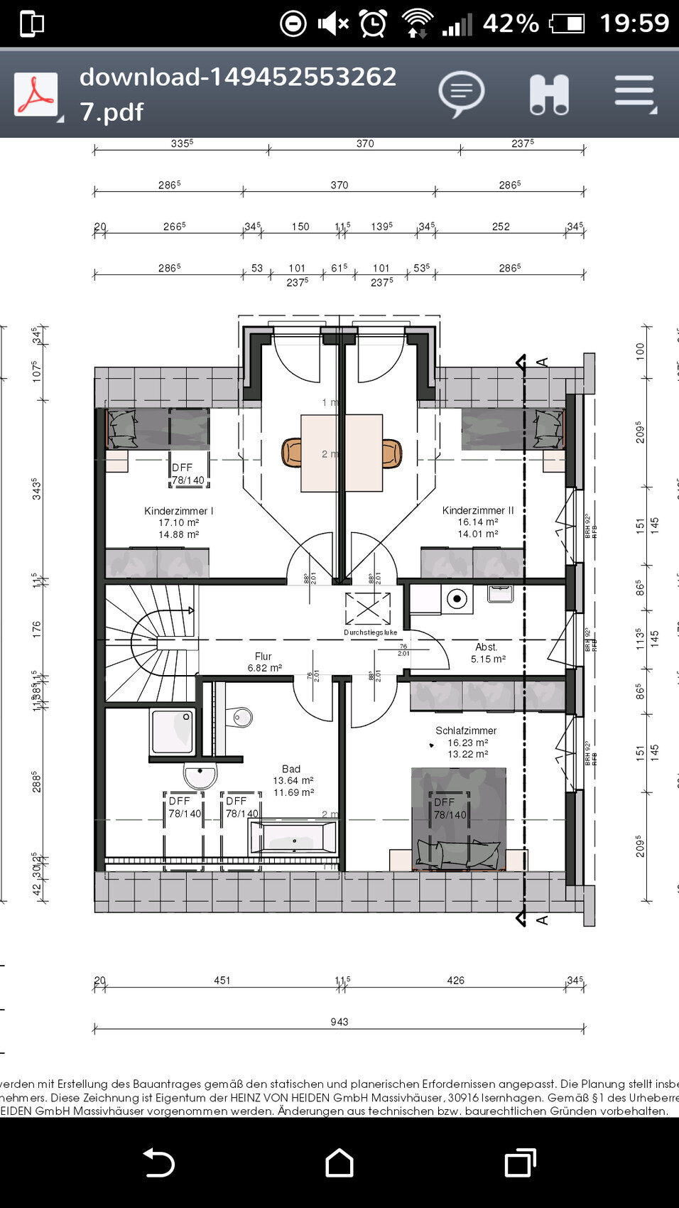

Ev-Marie8617 May 2017 21:44But you also have a disadvantage with the staircase... you always have to go through the living room to get upstairs... or when "the kids" have visitors... always through there.. hmm.
E
Ev-Marie8617 May 2017 22:05Thank you very much anyway for all the effort here, no matter what may come of it now.
