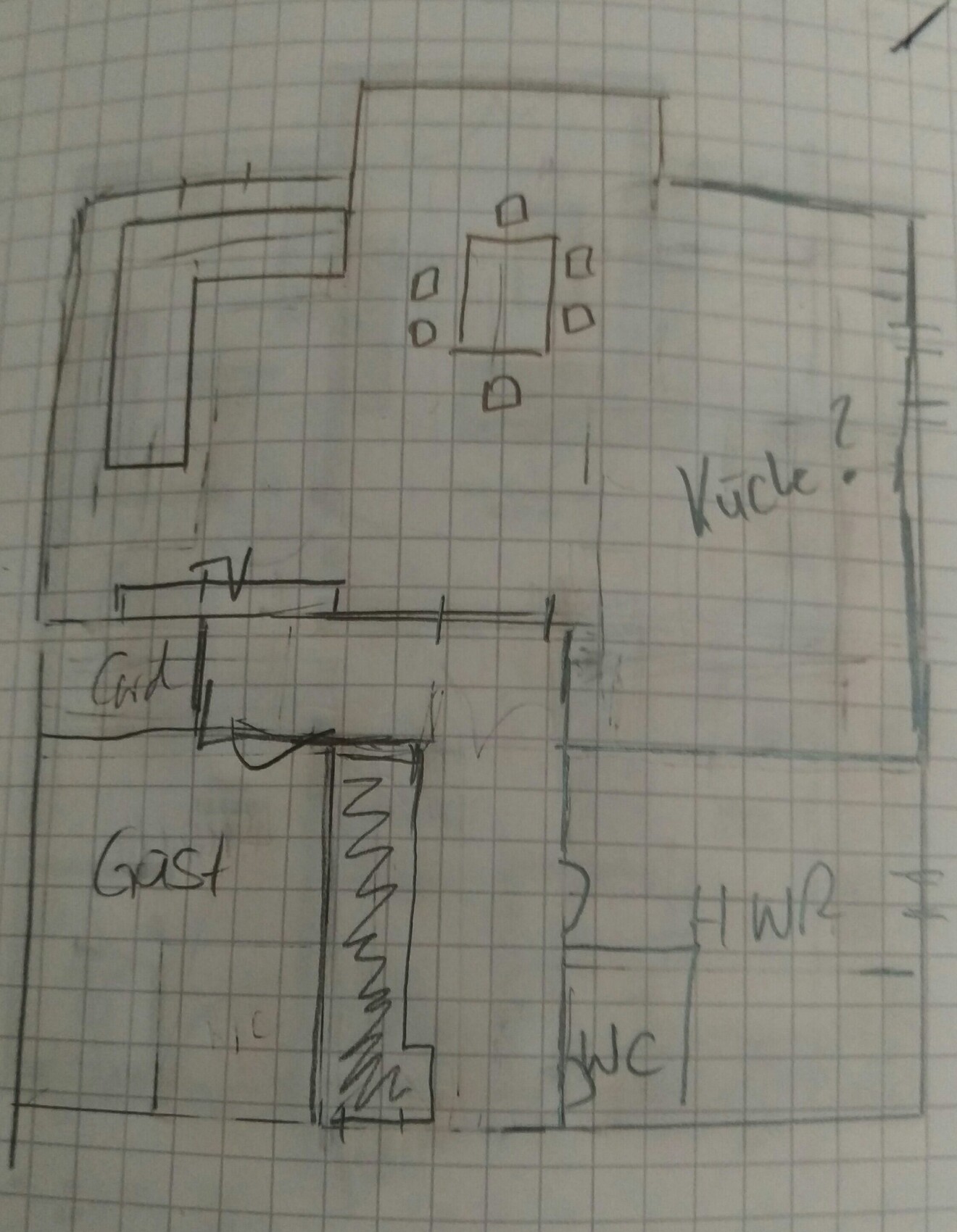

Yes.. It’s not that simple. So if you still have any ideas about how to arrange things, I’m of course open to suggestions. My initial idea of “closing things off” has already changed somewhat… at the moment I’m seriously considering a different staircase… relatively close to the entrance… Then a nice kitchen… BUT I’m NOT really a fan of an island… However, I can’t imagine it upstairs anymore either… What I definitely don’t want to give up is the utility room upstairs… That’s important to me… So, as I said, if anyone has ideas for a new layout… I’m open. I’m also currently trying to work on it myself again.

A walk-in closet is not for me... everything just collects dust in there. I have a three-meter (10 feet) wardrobe, and that’s enough for me. I know everyone wants a walk-in closet, but I can definitely do without one.

Unfortunately, I can’t draw p
Floor plan sketch of a house: kitchen on the right, guest room on the left, WC at the bottom, dining table with chairs.
