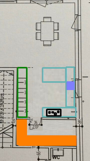

I would zone the kitchen as follows:
Room floor plan with dining table at the top, orange L-shape at the bottom, green column on the left, blue rectangles on the right.
  • Pantry door shifted to the right
  • Orange represents storage space in the pantry
  • Green = tall cabinet wall in the kitchen, possibly with a 90cm (35 inches) base cabinet niche in between for a coffee machine or kitchen appliance
  • Turquoise indicates base cabinets only; cooktop separated from the range hood, both freely positioned along the bottom wall; sink located in the corner at the peninsula transition, creating two full prep areas next to the sink (vegetable washing, knife and board cleaning, etc.) … one between the cooktop and sink, and one at the peninsula … also great for working with several people or setting up a buffet

@kbt09
Thanks for this great input and your effort!
Would the pantry then have a “standard door”?
We would like to have the cooktop with a downdraft vent in the island. What do you think about that?

kbt09 schrieb:
Cooktop separate from the range hood, both freely placed along the bottom of the plan,
I’m not a fan of downdraft extractors, nor of cooking on a kitchen peninsula. I simply believe that most kitchen activities revolve around the sink, refrigerator, and so on. People don’t just prepare hot meals but also one to three cold meals per day.
However, this is subjective and everyone has to decide for themselves. For further suggestions, I recommend a specialist forum—try searching on Google 😉
