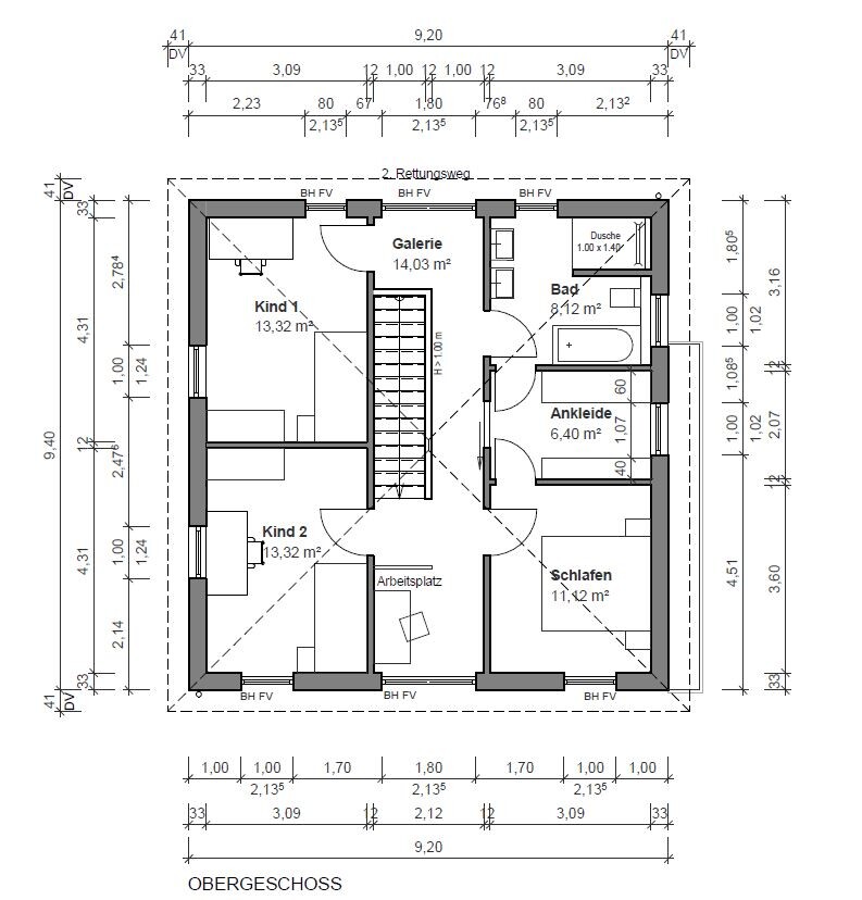

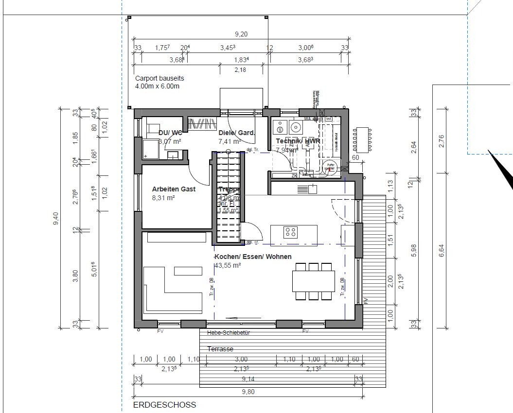

The plot is 416m² (4,476 sq ft) in size. We want to build a house without a basement in the city villa style. The ground floor is about 71m² (764 sq ft), the upper floor about 66m² (710 sq ft). The house will stand at the end of a cul-de-sac with an open southwest-facing view over fields. The main entrance is on the side.
Very important to us are a straight staircase, a gallery on the upper floor, and a large dining and living area with a kitchen island. Since we enjoy cooking a lot, the kitchen should become the heart of the home. At the moment, there are just two of us, but we plan to grow in the next 1–2 years (our wish is for two healthy children).
We are already close to our budget limit with the current plan, so no major (expensive) changes are possible. The current floor plan basically meets our wishes, but with such a big project, it’s normal to have some uncertainty about whether everything has been considered.

What is causing us some concern:
- Too little storage space? We want to use the space under the stairs for pantry storage as well as some kitchen appliances (blender, ice cream maker, etc.). Beverage crates and household equipment (vacuum cleaner, cleaning supplies) would also go into the pantry and utility room. Items only used occasionally (Christmas decorations, carnival costumes, suitcases, etc.) would be stored in the small attic. Are we being too optimistic with this?
- Is the hallway width on the ground floor sufficient? According to the plan, it will be about 90–100cm (35–39 inches) wide. Since we prefer an open concept and the kitchen already begins halfway into the hallway, this should be fine?
- We would like a somewhat larger cloakroom. Currently, the small one would suffice, but with children or many guests, it might get tight. However, we plan to possibly add a small cabinet in the office room that could be used for storage. For everyday use, should the planned cloakroom be enough?
- On the upper floor, we will probably remove the door between the dressing room and bathroom. This would allow us to place a 3-meter (10-foot) wardrobe along the longer side of the dressing room. On the other side, we want to put a small chest of drawers so it doesn’t feel too cramped.
- The bathroom on the upper floor is relatively small, basically the minimum size. We are not really the spa type. In our current rental, we have only used the bathtub twice in six years. We could do without a bathtub, but considering our hope to have children in the future, we will certainly need to include one in the planning.
Otherwise, we are very satisfied overall. We know that by having a straight staircase and a gallery upstairs, we lose some possible options, but this is very important to us, and we definitely want to keep it. Our budget is fully allocated with the current planning, and we do not want to go over it.
But maybe some of you have useful ideas, suggestions, or constructive criticism. We are very open and look forward to your help

Schnurrbart30 Aug 2018 20:12The walk-in closet is too narrow... this will likely cause the baseboard to get in the way, and the window will only open at a 45° angle because the closet was 62 cm (24 inches) deep. It would probably be better to omit the walk-in closet altogether and instead install a proper 3+ meter (10 feet) wardrobe in the bedroom – a little more space would also benefit the bathroom. This way, you save three doors.
Otherwise: skip the "bay window" and make the house 60 cm (24 inches) wider overall. This won’t increase costs much, and the utility room, bathroom, and bedroom could all use an extra 50 cm (20 inches). The remaining 10 cm (4 inches) can go to the corridors on the ground floor and upper floor – especially on the ground floor, where the entrance area feels cramped, and with the door open, you have to maneuver around it to get into the kitchen.
L
Lach_Doch_Mal24 Sep 2018 07:33In the show homes, you often see many straight staircases, usually very stylish, but the floor area is always above average. We planned 150 m2 (1,615 sq ft) with the architect and compared a straight staircase with a quarter-turn staircase, then decided on the latter. Detailed plans are currently being finalized.
I find the house too small for this floor plan. The living room TV wall is not even three meters (10 feet) long, and the sofa shown opposite doesn’t provide enough space for a family. In the entrance area, you almost stumble on the first stair step, and it will surely be difficult to pass between the stairs and the open door while carrying groceries. The wardrobe space is also insufficient for four people, and the dressing room upstairs does not have room for coats and jackets either. Especially since four people will also need more space for bedding and towels or bath towels. Visually, the straight staircase doesn’t add much if there is a storage room underneath. How high are your ceilings planned to be? The staircase seems quite short to me.
The two doors in the upstairs bathroom will only cause hassle, as two doors always need to be opened and closed, which children and visitors will probably often neglect.
