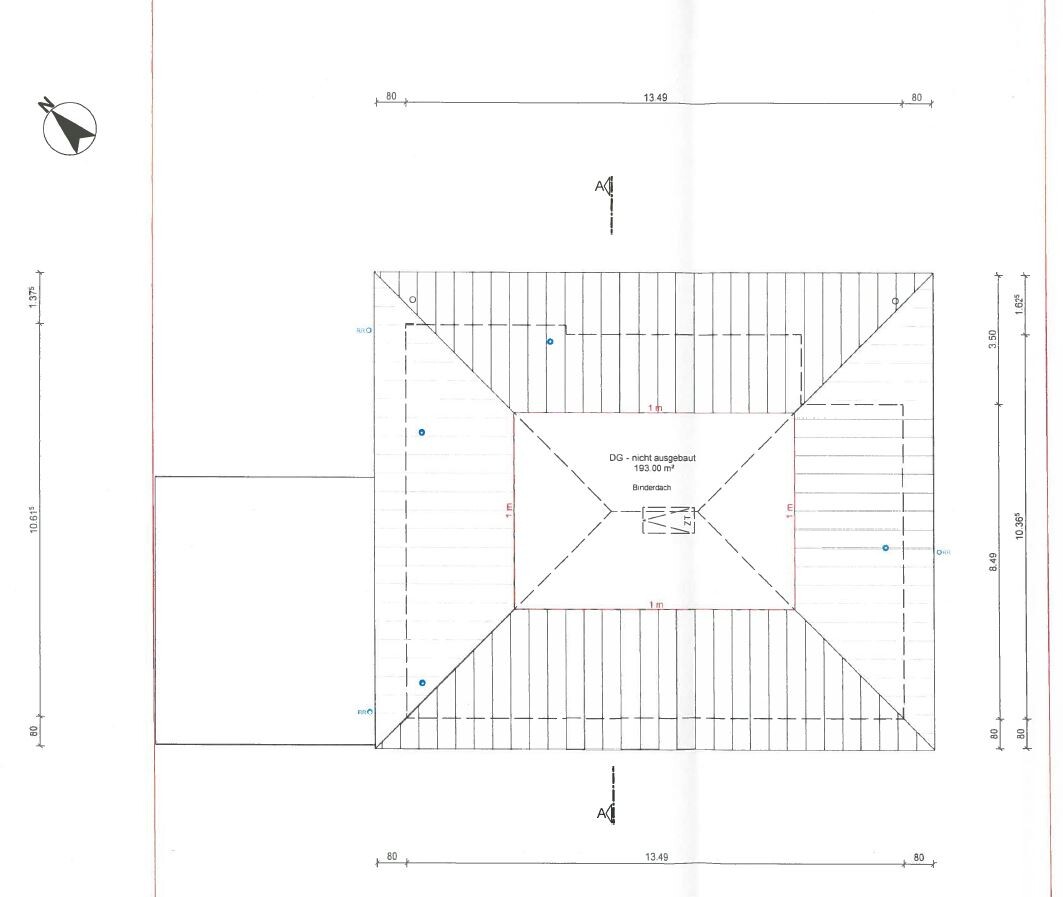

Hello everyone!
As some users have requested before, I’m now starting a new thread with the current planning of our detached house, which is about to be finalized.
These are the preliminary drawings for the building permit / planning permission application, and I have one last chance to review them and point out any issues.
It still seems to me that there is less than 1.20m (4 feet) of space between the two wardrobes in the dressing room. Or am I seeing this wrong? Apparently, the rooms on the left and right were overlooked and not adjusted accordingly.
Two Velux ceiling spotlights are still planned to illuminate the upper floor hallway.
In the basement, on the right side in the upper room, a window similar to the one on the left basement side is an option.
We still haven’t decided on the T30 fire-rated door to the garage, even though it is shown in the plans. Most likely, for safety reasons and the limited use of the kitchen at the other end of the house, we will eventually forgo it.
User 11ant pointed out that the right window in child’s room 2 is suboptimally positioned. However, this could still be changed after submitting the building permit / planning permission application. Our architect thinks moving the window to the left would negatively affect the house’s exterior appearance. We’ll have to see about that.

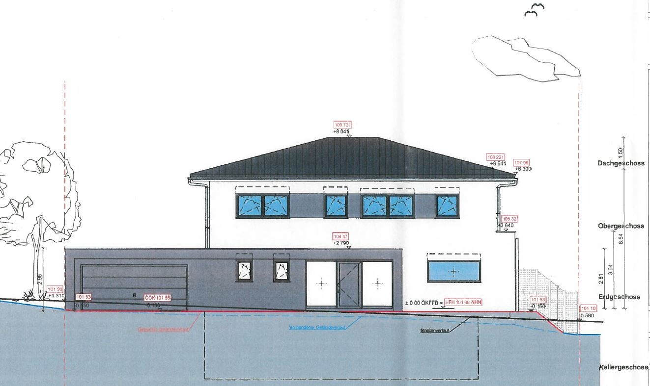

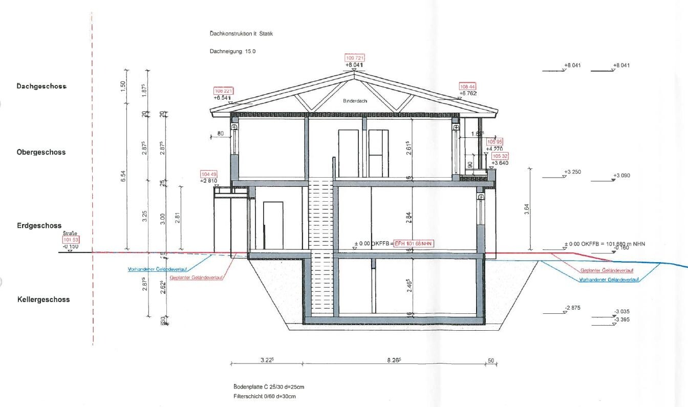

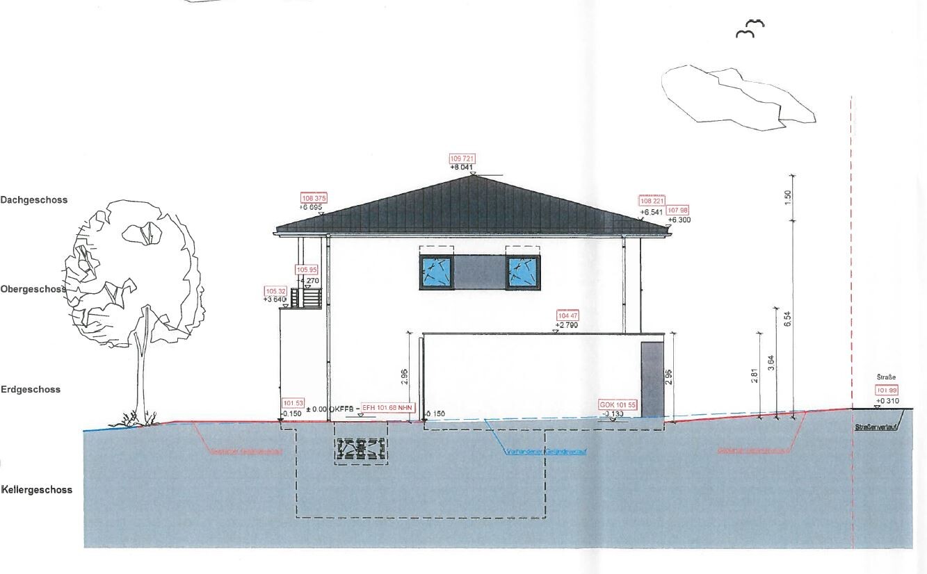

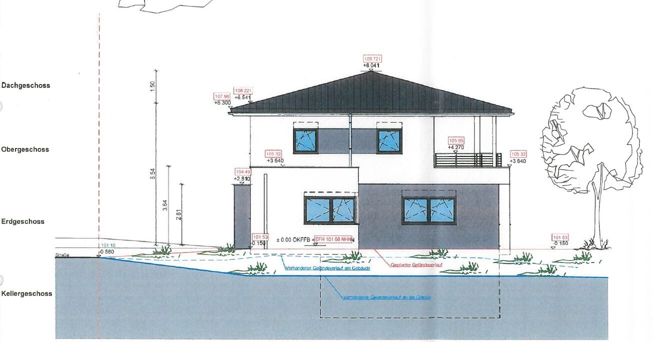

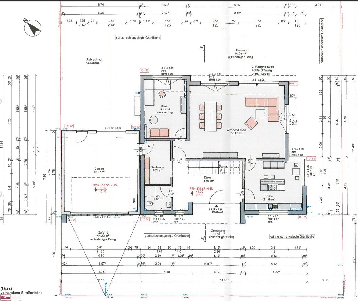

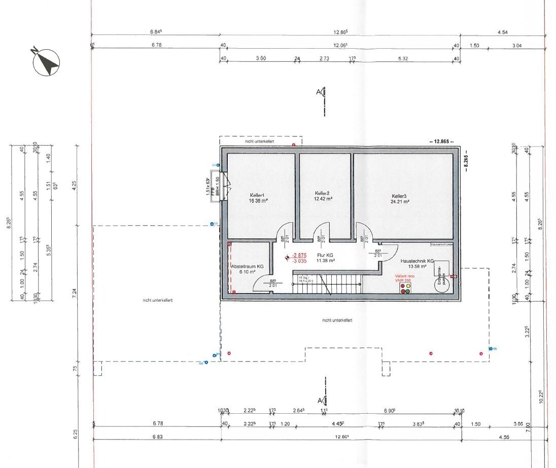

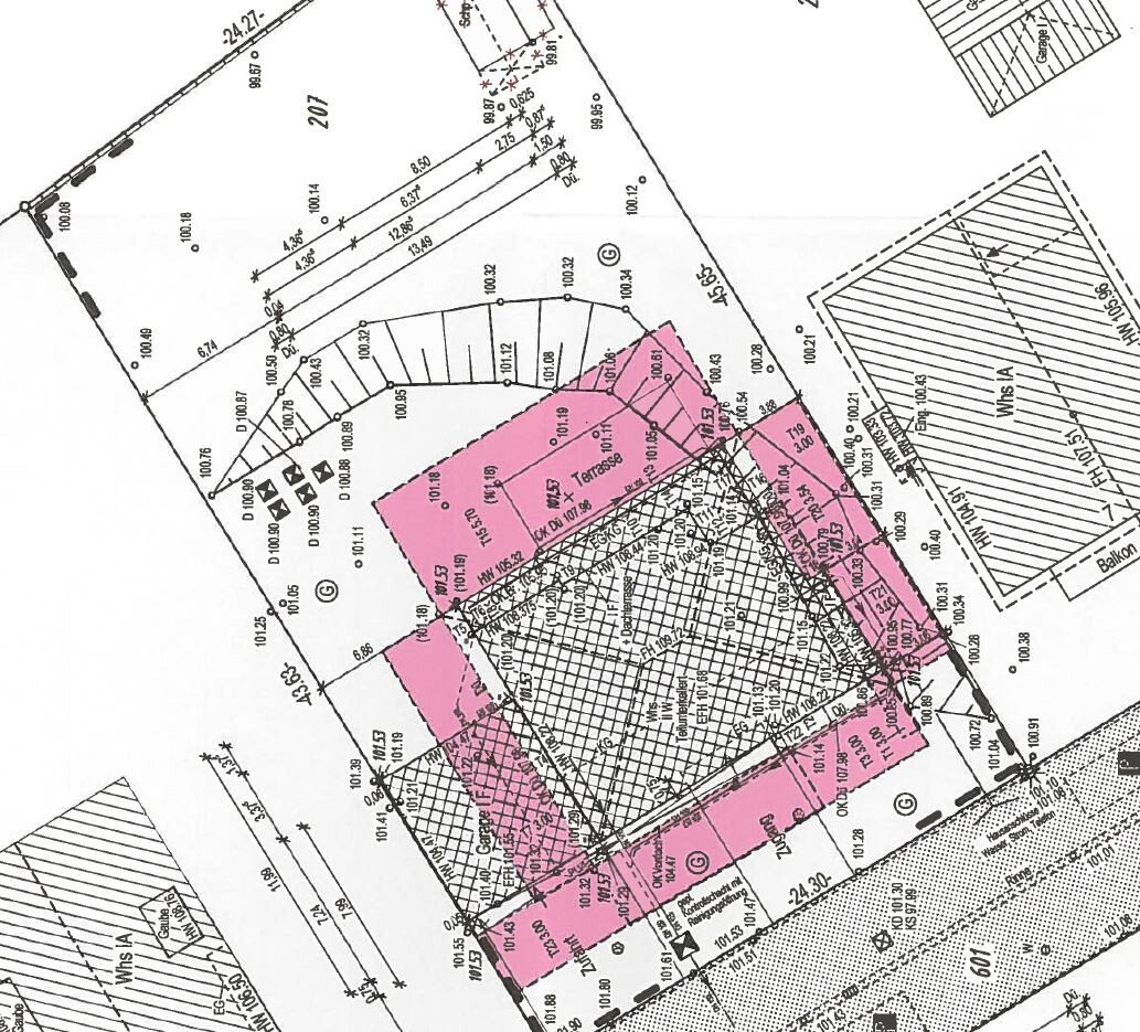

To conclude the floor plan discussion, I am uploading excerpts from the submitted building permit / planning permission documents for completeness.
The furniture layout still does not fit, as the supplier will only correct this during the yet-to-be-commissioned detailed planning phase!
The rear garage door is new now, allowing a mini excavator to access the garden. On the right side of the house (front view), this is not possible.
Architectural drawing: house with basement, ground floor, and upper floor, attic; tree on the left.
Modern house view: garage on the left, entrance area and row of windows under the roof.
Architectural drawing of a two-story house with attic, basement, garage, and balcony.
Architect’s drawing of a modern two-story house with hip roof, balcony, and tree on the right.

Basement floor plan: three basement rooms, basement hallway, basement storage room, basement building services, dimensions.
Floor plan of a house with garage, office, cloakroom, hallway, kitchen, living/dining area, and toilet.

Cross-section through a multi-story house with basement, ground floor, upper floor, and attic.

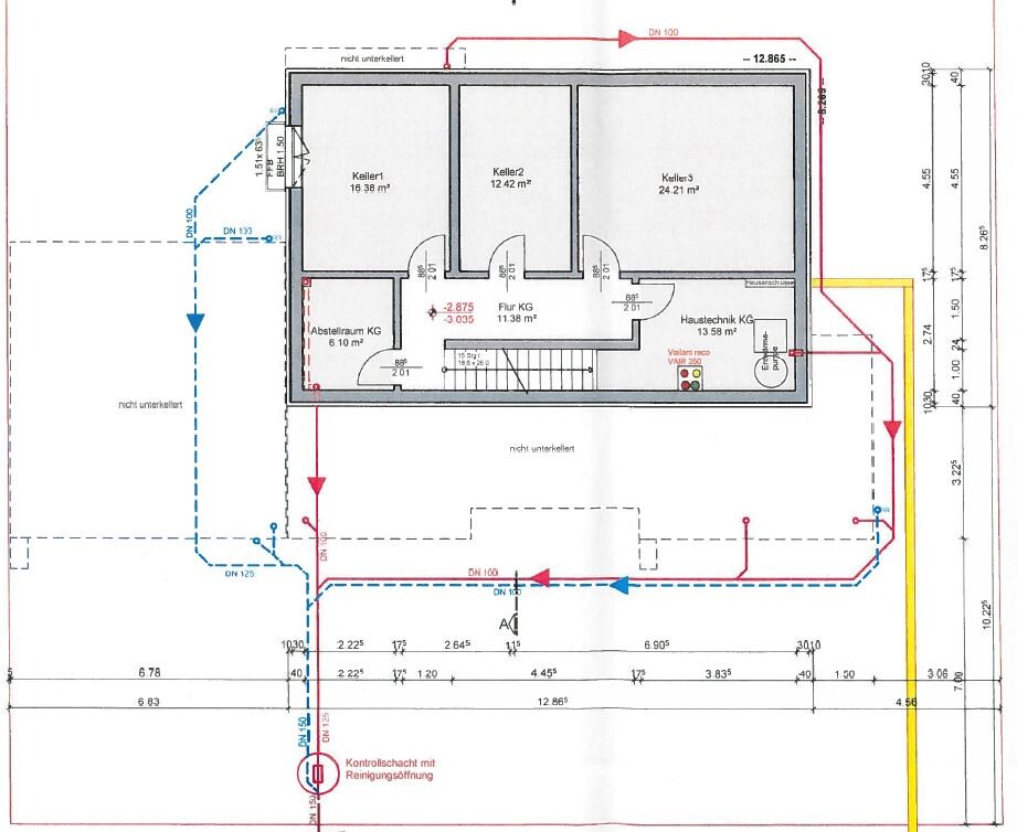

And here is the drainage planning.
Basement floor plan with three cellar rooms, storage room, and hallway; colored pipes (red/blue).
11ant22 Oct 2017 15:08
R.Hotzenplotz schrieb:
To conclude the floor plan discussion, I am uploading excerpts of the submitted building permit / planning permission documents for completeness.
A 46cm (18 inches) slope over 7m (23 feet) length of the garage driveway – is that necessary?
R
R.Hotzenplotz
22 Oct 2017 15:10
46 cm (18 inches) slope over 7 m (23 feet) length of the garage driveway – is that necessary?
The building consultant also noticed this and, after considering the overall site topography, commented that there probably was no alternative if one wanted to avoid other disadvantages elsewhere (I can’t recall the exact details, and I didn’t prioritize it highly anyway). So I didn’t pursue the matter further.
11ant22 Oct 2017 15:21
For me, that would be the decisive argument against the interior door, and I would raise the garage height—preferably adjusting the garden-side garage door slightly. So maybe about 20cm (8 inches) higher than currently planned.
