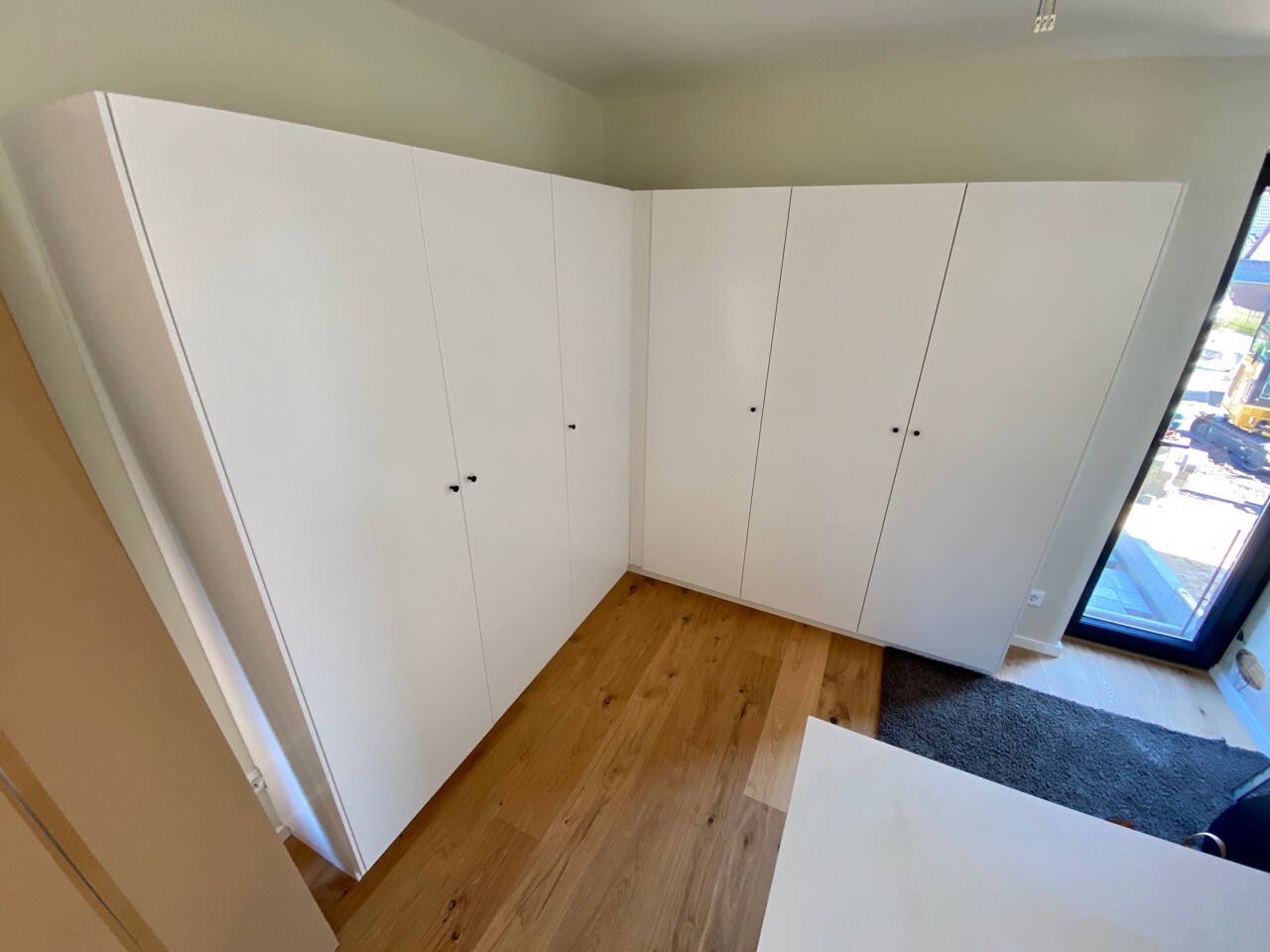

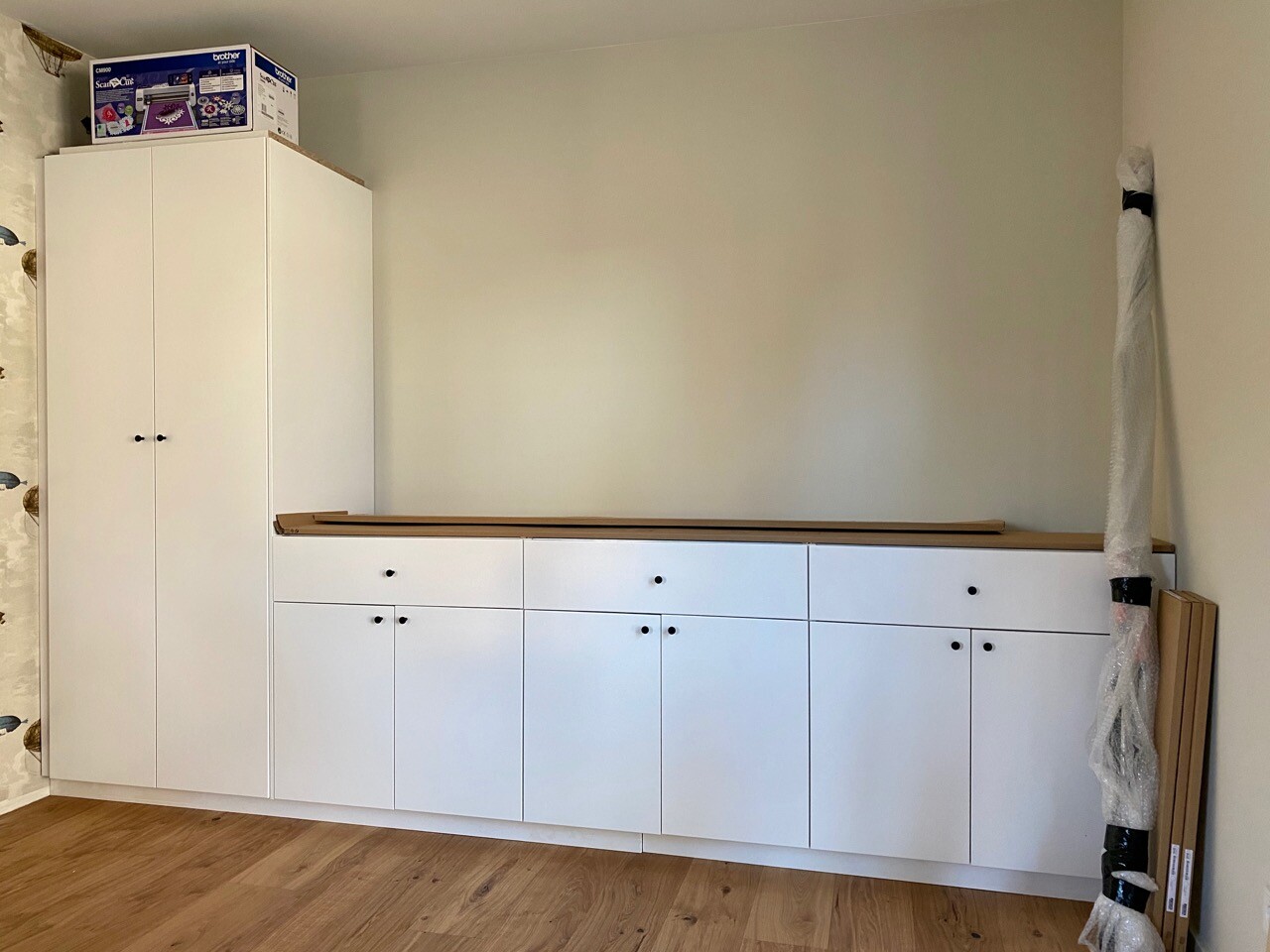

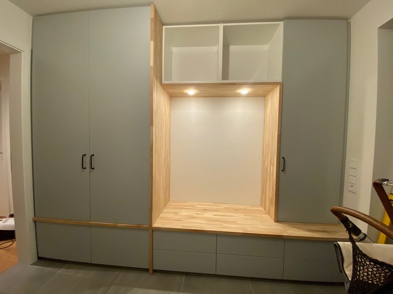

Metod is Ikea’s kitchen cabinet system. It’s not as flexible as some other kitchen manufacturers, but still more versatile than any other option Ikea offers, as far as I know. Cabinet widths are available in 40, 60, and 80 cm (16, 24, and 31.5 inches), and heights can be combined from 40 to 240 cm (16 to 94.5 inches). The shallow cabinets are great for storing binders and work well in children's rooms for toys and clothes.
Attached are photos of wardrobes, children's room, and home office cabinets, all about 90% complete, all Ikea Metod.
