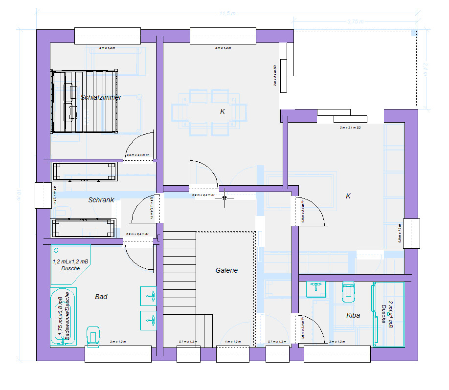

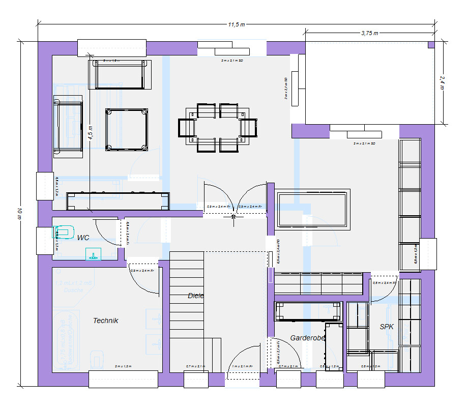

- A partition wall will be added in the walk-in closet. That would theoretically allow watching TV from the bed. I am considering a lightweight wall. I plan to place a 211cm (83 inches) Pax combination wardrobe in the closet. The closet is planned with a raw width of 218cm (86 inches). Do you think 218cm is enough for the Pax once the walls are plastered, or how wide should the rough dimensions preferably be?
- Is the hallway on the ground floor too narrow?
- Would you raise the ground level? The house would be 40cm (16 inches) below street level. If I build a terrace into the garden, it would be about 1m (3 ft) difference. You could raise only the house level, resulting in approximately 1.6m (5 ft) difference between terrace and garden. I don’t know anyone living below street level. Raising the garden would probably not be allowed without permits, and affected neighbors likely wouldn’t agree. On the sides of the house adjacent to neighbors, raising is permitted only up to certain limits. I am overwhelmed with the decision.
- Do you have any ideas for arranging the sofa differently and placing the TV sensibly? My husband doesn’t want the sofa back facing a window. I still need to get used to placing the sofa in the middle of the room.
- Is the kitchen size sufficient for a nice kitchen with an island?

We are open to compromises and would be willing to go with a rectangular shape for a better floor plan. I think that would also be allowed under the building regulations. Do you have any ideas on that?The footprint is slightly smaller than the original design.
View from the front door looking up to the gallery:
kaho674 schrieb:
[ATTACH alt="EG.jpg"]42655[/ATTACH]
[ATTACH alt="OG.jpg"]42654[/ATTACH]
[ATTACH alt="A1.jpg"]42653[/ATTACH]
[ATTACH alt="A2.jpg"]42652[/ATTACH]
The floor area is slightly smaller than the original design.
