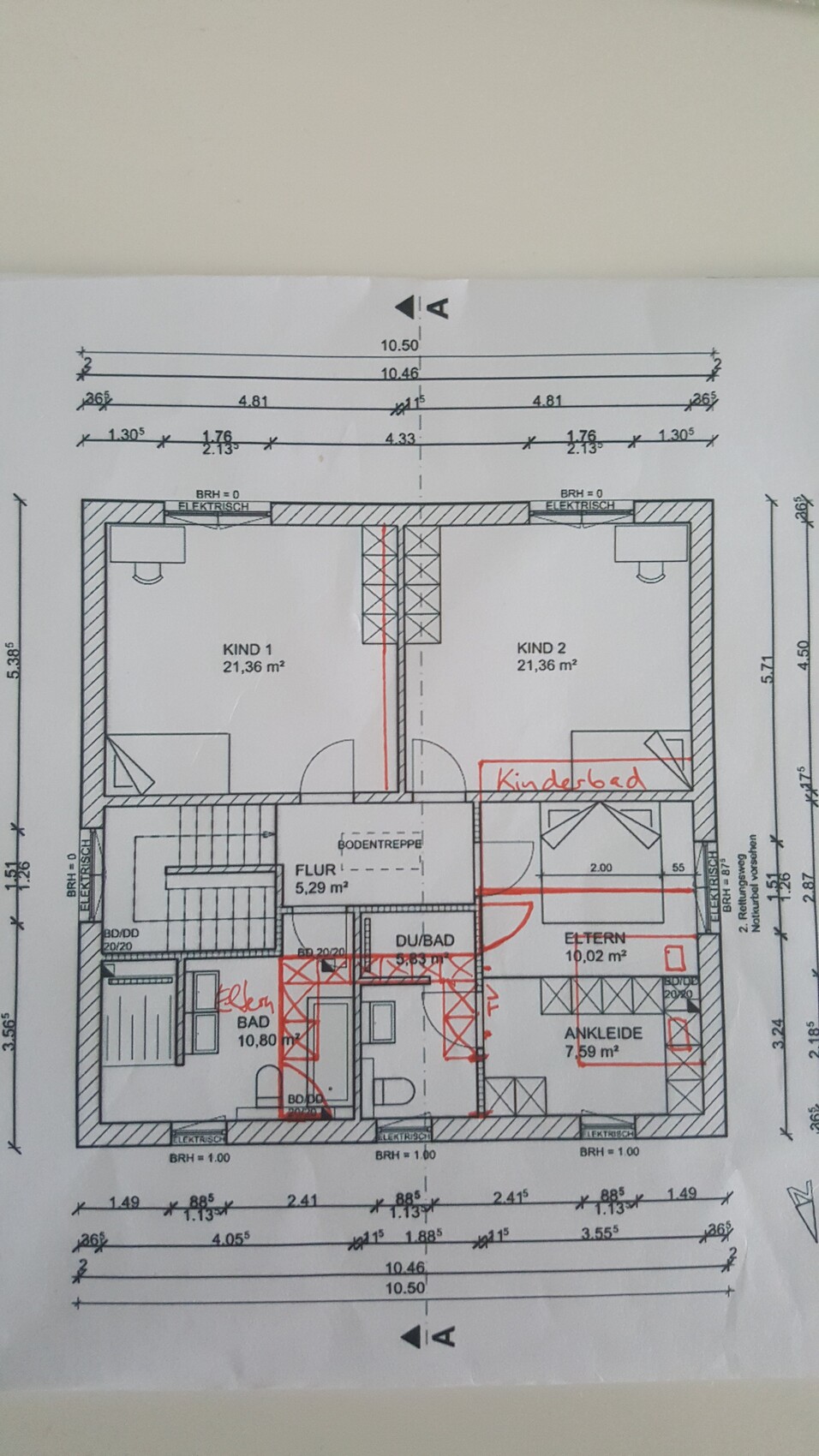

What do you think of this design?
I hope it’s clear what I’m aiming for. I left an open space above and enlarged the hallway.
I hope the new room for the children's bathroom is big enough for a tiled shower plus a bathtub. How many square meters does such a bathroom need at a minimum?
That’s possible. I personally like it better than the architect’s design. The downside is that you have to walk through the bedroom repeatedly and spend quite a bit of time just to get to the bathroom. Also, this probably means you’ll only have small bathrooms. So no really large master bathroom with a bathtub, shower, and all the extras without feeling cramped. Unless you move the wall more decisively toward the children’s room. But be careful with drainage running above the living area.
Regarding shifting the wall consistently: When does that start to ruin the children’s room?
Do you have any other ideas?
Would you place the staircase differently on the ground floor? Does having the staircase near the entrance hallway bring any advantage?
It’s important for us to have a spacious living area in an L-shape. In the living/dining area, we have a width of 4.50m (15 feet), which we consider necessary. Upstairs, we definitely want a separate master bathroom accessible only to us. The children’s rooms should be the same size and face south. They don’t need to be that large, of course. Right now, they ended up quite big because the large living area is very important to us. A walk-in closet would be nice to have but is not an absolute requirement.
Hmm, you could probably try a few more options. For that, however, you would need the complete site plan including the exact building plot with access routes, distances, and ideally also the neighboring buildings – so everything.
Also: How far would you be willing to go? Would a house measuring, for example, 9.5m x 11.5m (31ft 2in x 37ft 9in) be possible? Or does it have to be a perfect square?
Regarding your upstairs post no. 37
I don’t like the two bathrooms. The kids’ bathroom is okay (if the drainage works), but I find the main bathroom too cramped. There should still be room for a bathtub, shower, two sinks, a toilet, and a cabinet for toiletries.
The children’s rooms are large. They could be somewhat smaller. Rooms are more often compromised by a poor layout than by their size. For example, when you open the door, you feel like you’re walking straight into the wardrobe. (That’s why it’s important here that a wardrobe of that depth can still fit behind the door.)
