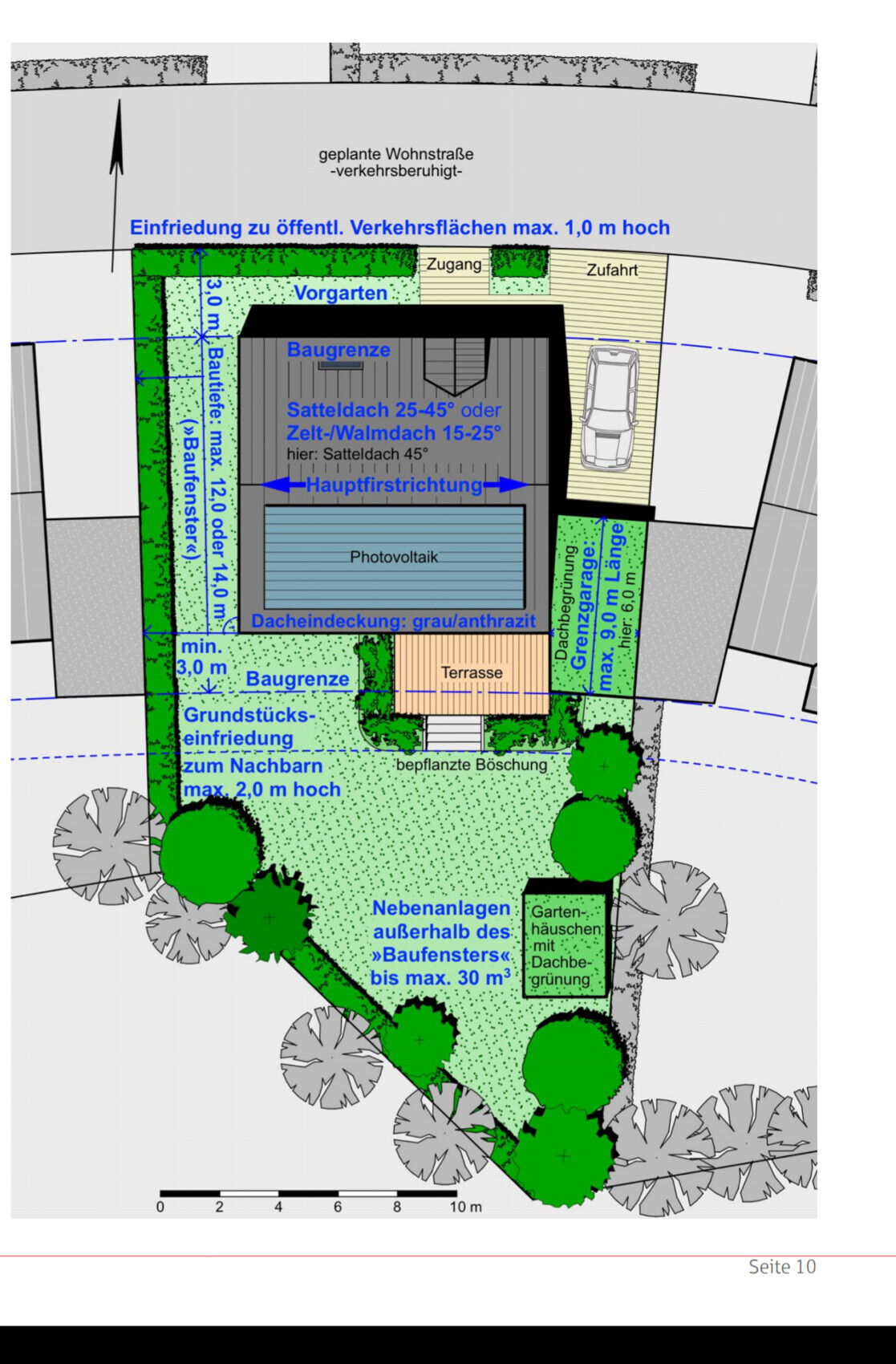

We are open to compromise and would be willing to go for a rectangular layout if it means a better floor plan. I think this would also be allowed according to the building regulations or planning permission. Do you have any ideas?We could try experimenting a bit. At least draw a rough sketch of the plot. Include all corners, the width and depth along the street, the size of the building area, and importantly, the cardinal directions. You can quickly scribble something like that, take a photo with your phone, and share it here.
