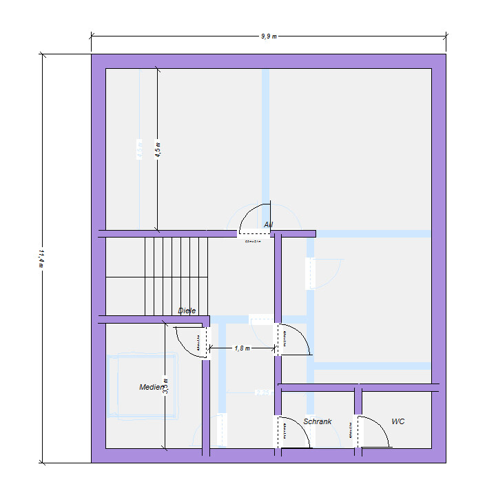

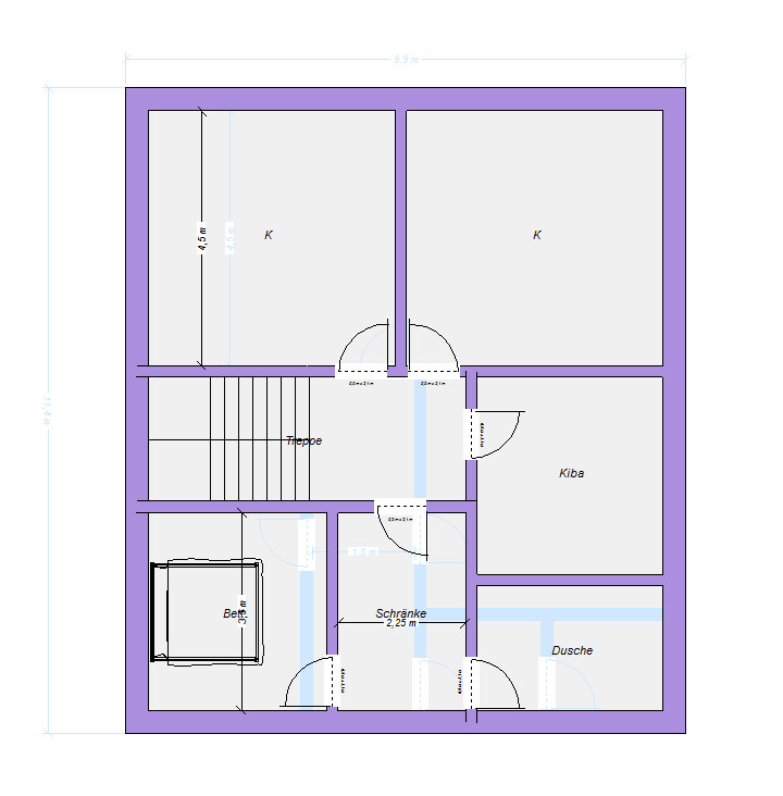

If you’re generally happy with it but just stuck on a small detail like this, sometimes you have to bite the bullet and buy an extra 2 square meters. Here’s a version measuring 11.4m x 9.9m (37.4 ft x 32.5 ft), which is 2.61m² (28 sq ft) more than the original design. It’s not a big difference, but it lets you have your staircase fully lit and open, bright and cheerful:
I’ve left out the clutter and windows for now. This whole layout is based on #17 — just longer and narrower.

@kaho674
Okay, the new dimensions seem a bit extreme to me.
But the idea of extending it for the staircase is good.
Could you please show me something else?
What if the length is only extended as much as necessary so the staircase isn’t blocked?
I could also reduce the living room width by 10-20cm (4-8 inches). Then it might only be 40-50cm (16-20 inches) longer overall. For example, the house could be narrowed by those centimeters. How would that affect the room layout? Maybe that would already help?
