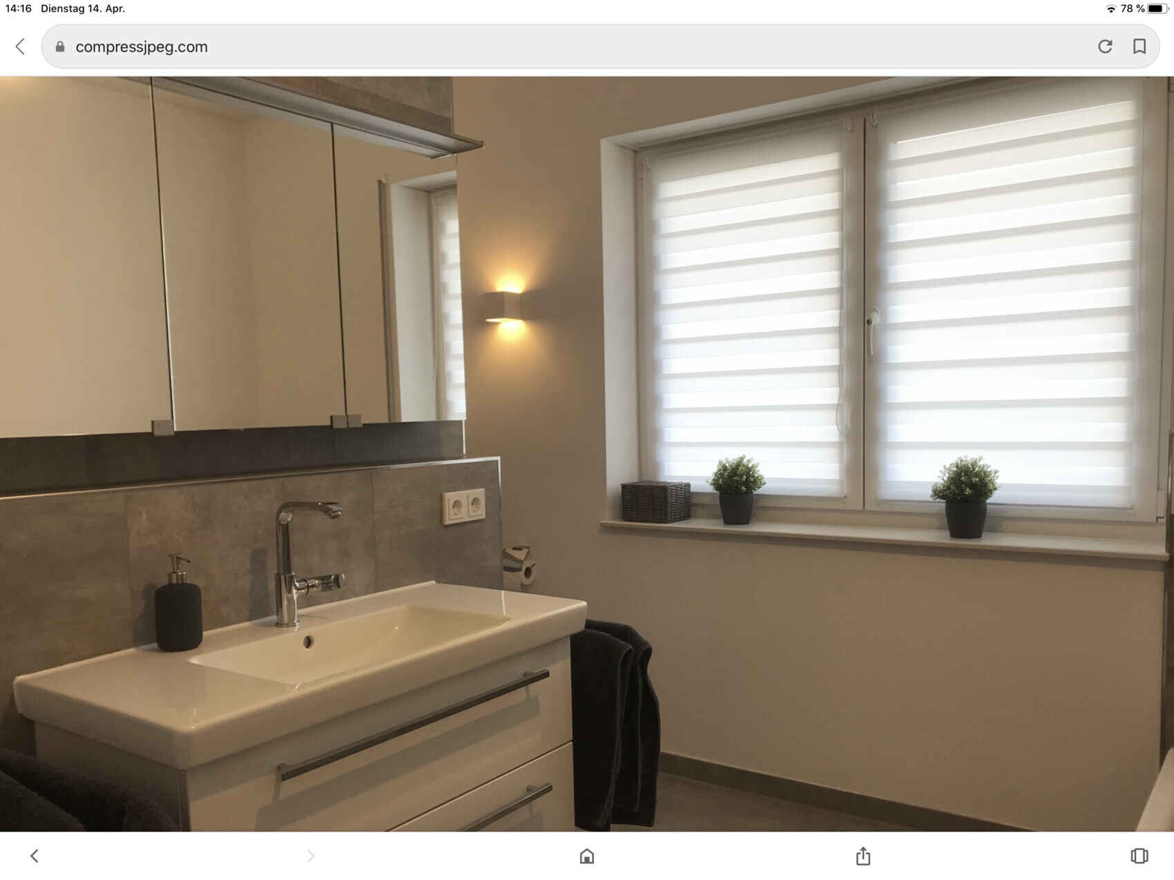

Curly
14 Apr 2020 14:20
The window measures 1.76 x 1.38 m (5 ft 9 in x 4 ft 6 in), with a sill height of 90 cm (35 inches).

Shiny86
14 Apr 2020 14:25
Curly schrieb:
The window is 1.76 x 1.38 m (5 ft 9 in x 4 ft 6 in), with a sill height of 90 cm (35 in).
That looks very nice. Thanks! Did you also use any wider windows than 1.76/1.38 anywhere?
And would you also show the window measuring 1.01/1.38 in the guest bathroom? Because I currently have it planned that way and can’t quite visualize it.
Curly
14 Apr 2020 15:44
Shiny86 schrieb:
Would you also show the 1.01/1.38 window in the guest bathroom? Because I currently have it planned that way and can’t quite picture it.
I can’t take a photo of the guest bathroom window that shows more than just the window itself, so it wouldn’t be helpful. But I just measured it: from a 1m (3 feet 3 inches) wide window, only about 72-73cm (28-29 inches) is actual glass area, which isn’t much.
We only have wider windows than 1.76m (5 feet 9 inches) in the kitchen (though those are divided into three sections) and a very large bay window, which can’t be opened. With very wide windows, you also face the drawback that the sash, when opened, protrudes quite far into the room, which can sometimes be annoying. By the way, I don’t think you’re overthinking it—I spent at least six months working on the floor plan and carefully considering every measurement. Since this is our second build, I knew exactly what was important to me this time and what I definitely wanted to do differently from before.
