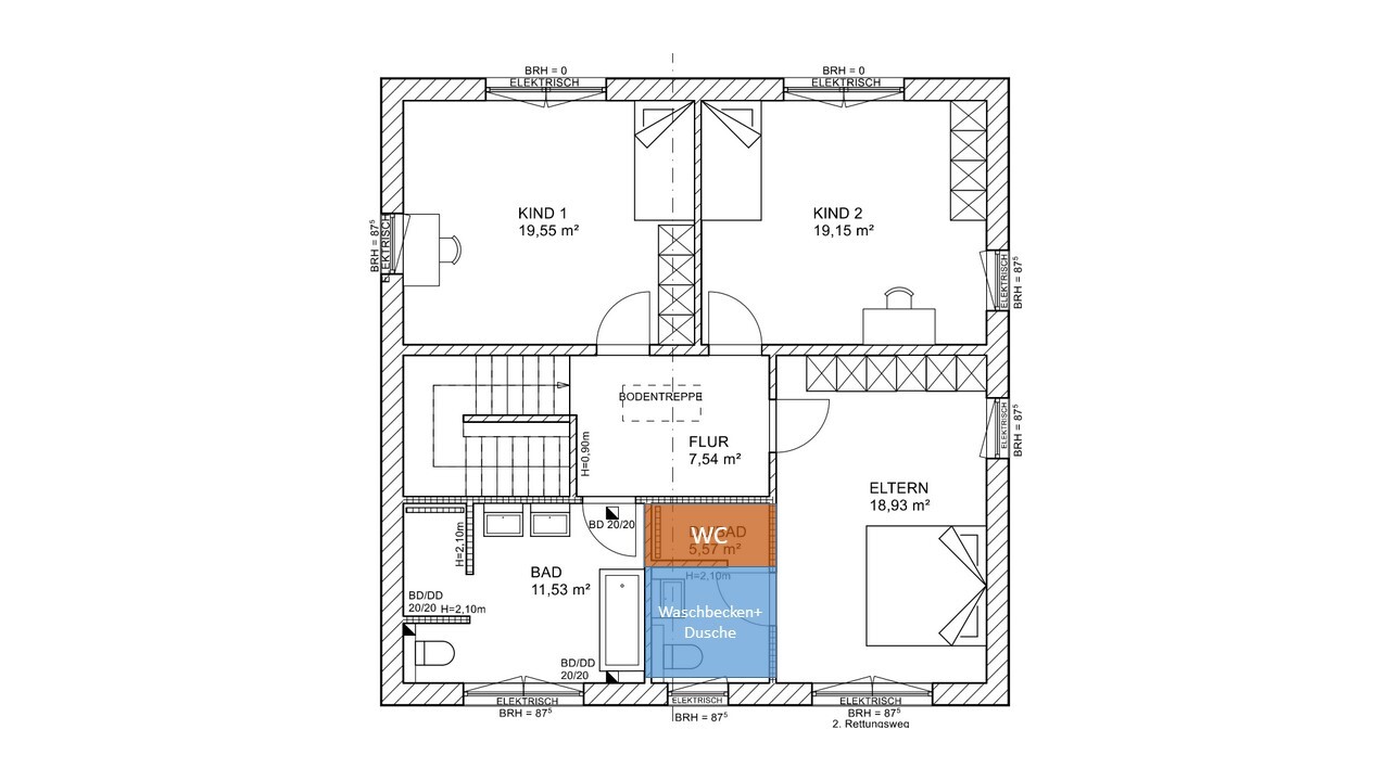

Alessandro4 May 2020 12:55Shiny86 schrieb:
Good idea with the built-in mirror cabinet.
But why would you swap the washbasin and toilet? Can’t it stay as shown in the plan?
If I swapped those fixtures, I would have to move the door to the master bathroom down as per the plan. Then there wouldn’t be any corner left for extra space. I was thinking of putting a laptop table there.
I would swap them so your husband doesn’t accidentally hit the door on your back when you’re brushing your teeth in front of the sink. When you brush your teeth, blow-dry your hair, etc., you usually stand a bit behind the washbasin.
If you’re sitting on the toilet, the risk of being hit by the door is much lower, since you don’t sit long when using the toilet, and you normally lock the door for number two.
I would leave the door as is.
Personally, I would install a sliding door. That way, you wouldn’t have any problem at all!
Glass on tiles always requires a silicone joint.
For a guest WC with a washbasin, just under 3 square meters (about 32 square feet) is sufficient.
You want a masonry shower wall for space reasons?
I don’t quite understand that...

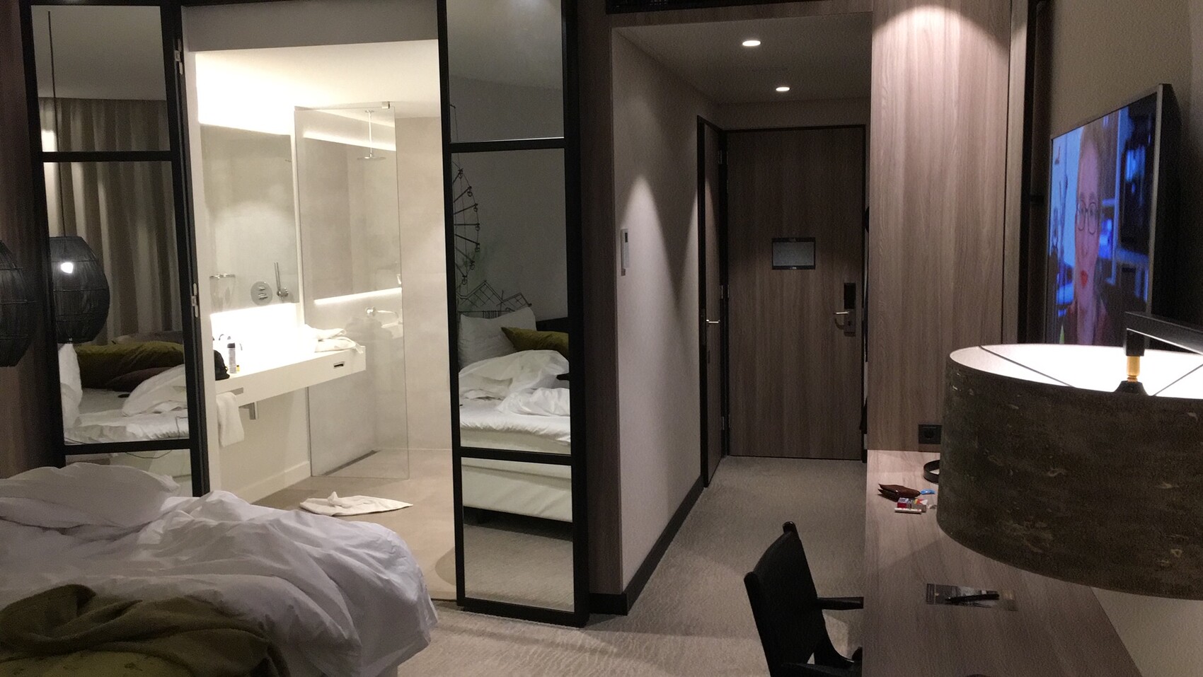

Alessandro4 May 2020 13:11OR:
You separate the toilet from the rest of the bathroom and only install a door for the toilet area.
I find that an open bathroom integrated into the bedroom has a lot of charm and looks modern. However, it also has some drawbacks.
I often stay in hotels where this "open" bathroom concept is nicely combined with the bedroom.
Here is an example:
PS: You ALWAYS have a silicone seal. Whether the wall is masonry or glass!
Here is an example:

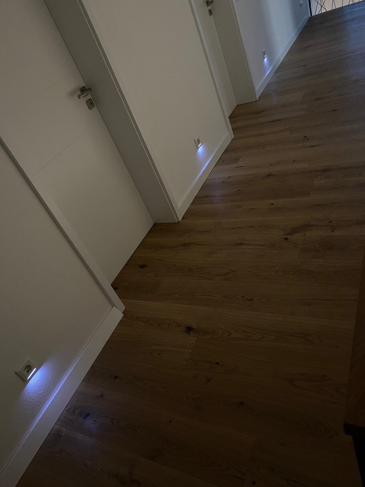

Alessandro4 May 2020 14:02I would rather go with a sliding door.
If you don’t want that, then in my opinion a smaller door will also be sufficient.
Since your hallway is quite dark, I would suggest installing sockets with underfloor lighting.
That way, you won’t have to turn on the main light half-asleep when you need to use the bathroom at night.
I would also install these in the master bathroom.
Alessandro4 May 2020 14:16Of course, you could also have the door in the master bathroom open outward.
Alessandro schrieb:
Since your hallway is relatively dark, I would install power outlets with underfloor lighting.Where did you get those (and also the stylish door handles and fittings) from?
